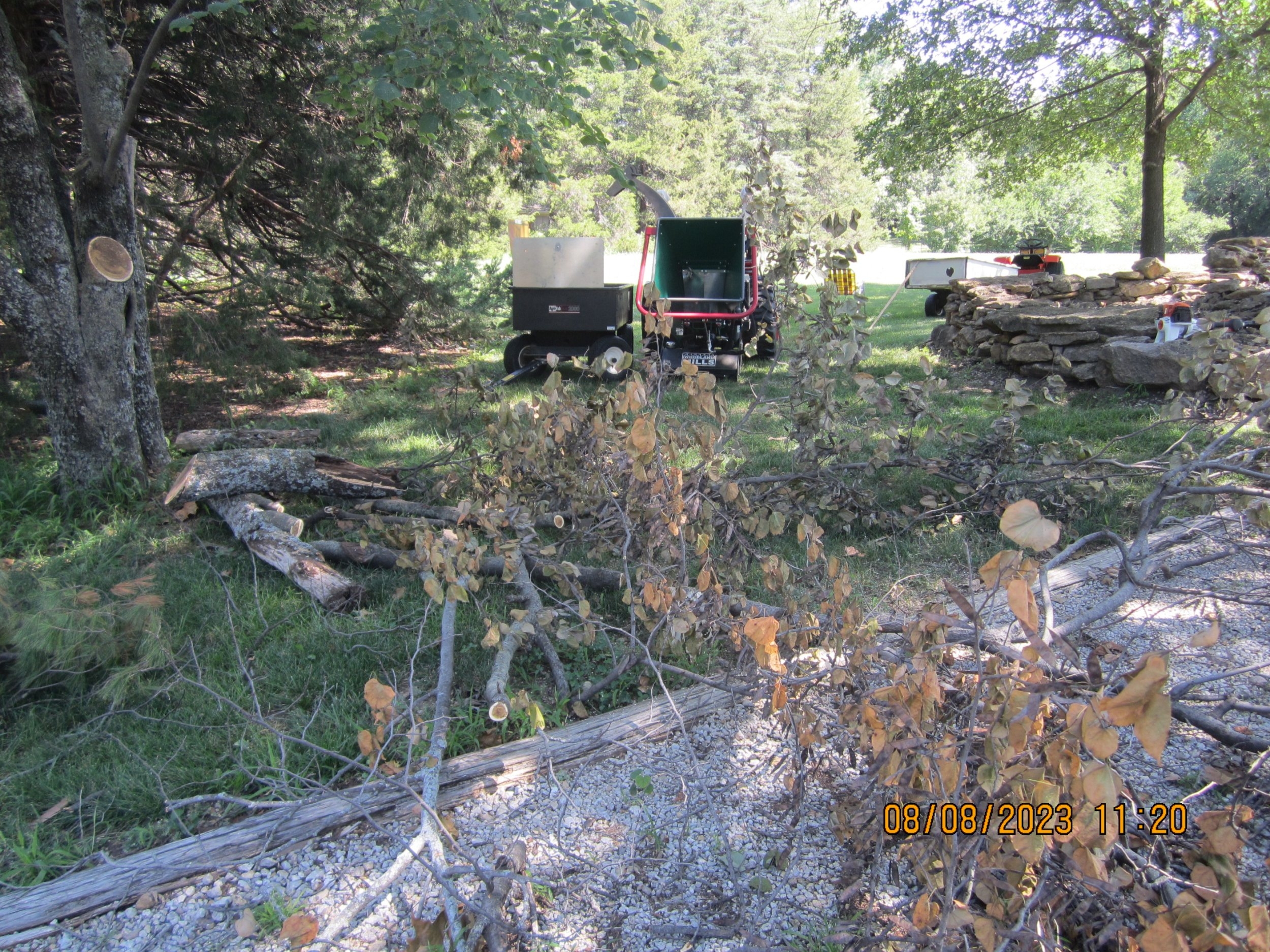

According to my notes from a phone call, the flywheel weight of my WoodlandMills WC-68 is 80 lbs. ??
Just used mine last week to clean up the wind storm damage of the past month.
