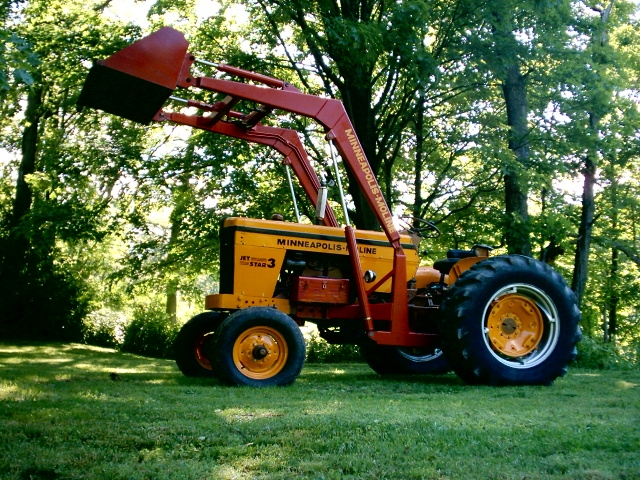

I spent my working life in hardwood sawmills and I am pretty familiar with the nomenclature, care,
and feeding of chippers. In 1993 I used a 6” capacity Valby with a horizontal hydraulic feed, to clear an overgrown softwood plantation the was also populated with hardwoods to build my pond. It took all my spare time that summer to clear the 4 acre site. I mounted the chipper on a tired 1965 Minneapolis Moline Jet Star 3. The Valby did fine with as long as there some wood going through, but it didn’t like to feed when there were just softwood boughs. I kept the knives sharp and anvils set close. The horsepower required is directly proportional to the number of knives and the feed rated. A sharp chipper will self feed once it is engaged wood, so the hydraulic feed helps prevent over feeding. When I used the same chipper on a 27HP JD 4200 (green Yanmar) I flipped one knife and only used 1knife to chip. I dressed the knives with file and added a slight counter bevel to strengthen the cutting edge for touch ups and changed knives every 15-20 hours of operation. In the mills we never ran anything to dead dull, in my back 40 they got pretty beat up from time to time. Cleanliness is next to godliness. I had some 6” Maple trees that I had to notch the big limbs so feed could pull them into the chipper. That Valby chipper is still running with the same arbor bearings thanks to grease and a little TLC periodically.
I felt so bad about abusing my old Minnie Mo that I put it in the mills truck shop that winters and did total engine tear down and a bare metal restoration. The result was pretty parade ready tractor that had way more power than i needed to man my place. When I tried to mow with it every time I started up hill the governor would kick in and the Ag Tires would peel to sod right down to bare dirt. So the Minnie Mo had to go and the green Yanmar replaced it. I learned a lot, and I like to say “all education is expensive“.
