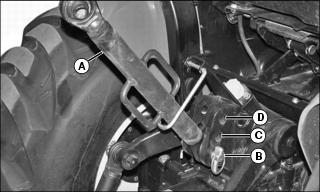

There are three holes on the tractor for the top link. Which one do you choose? The owners manual simply states "attach the top link to the desired hole". I pick the hole that keeps the top link as parallel to the level surface as possible when attached to the implement. (Was told or read this years ago).
This is what the Deere manual (3x20 series tractors...and my old Deere 4400 too) states:
Positioning Center Link
MX26262
For light and medium draft loads: Install center link (A) in bottom hole (B) of mounting bracket. Example of light and medium draft load implements would include a landscape rake.
For medium and heavy draft loads: Install center link in middle hole (C) of mounting bracket. Example of medium and heavy draft load implements would include a tiller or box blade.
For very heavy draft loads: Install center link in top hole (D) of mounting bracket. Example of very heavy draft load implements would include a plow or ripper.
I'm very surprised your Kioti manual doesn't go into more detail.
MX26262
If you are coming from using a Ford like the N series etc. It is just the opposite. Make sure of your hook ups...Yes, I agree, The manual needs to
be clearer on the hook up for the top link.
