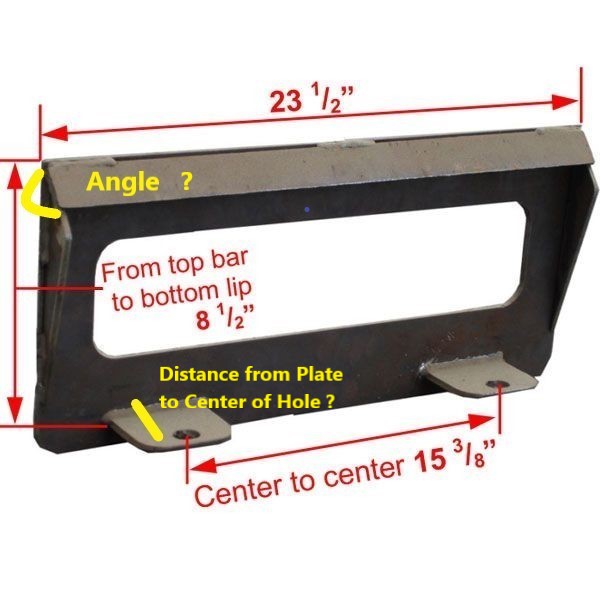

Keep track of all the dimensions/angles. Will make it easier for the next person.

I think if you went to the rental place and got the yellow dimensions (and hole diameter), you could work backwards from this.
If you can add to these dimensions, and add a photo and dimensions of the PowerTrac side, that will make it easier for the next person.
