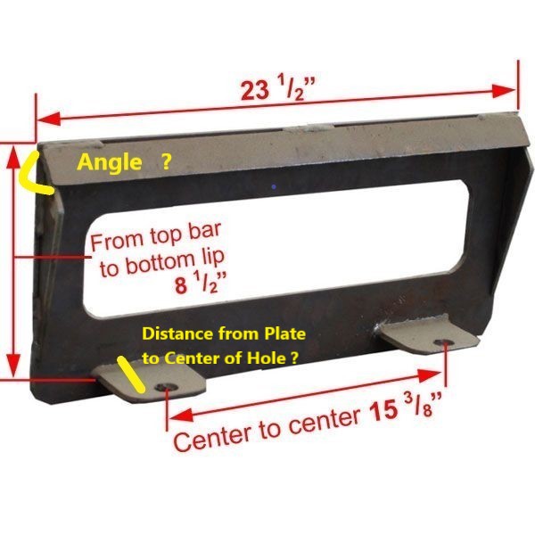

I think if you went to the rental place and got the yellow dimensions (and hole diameter), you could work backwards from this.
   / PT425 T8 to mini skid (Dingo) adapter? #12
When ken and I bought a number of third party implements and had to weld on the adapters, we found out quickly we needed the addition of a roughly 10 degree wedge between the adapter and the implement to get the angles (dump / tilt) to work right.
#13
Thanks, I thought I had read something like that somewhere. Where your attachments for a full size skid steer? Any idea if the mini's are the same angle as the full size skid steer?
   / PT425 T8 to mini skid (Dingo) adapter? #14
I believe that different attachments have different angles. The wood chipper that I adapted needed something closer to thirty degrees.
It all depends on how far above and below level your attachment needs to go. Some attachments like 4n1 buckets and augers spend a lot of time at the extremes, and a few degrees can make a big difference in the utility.

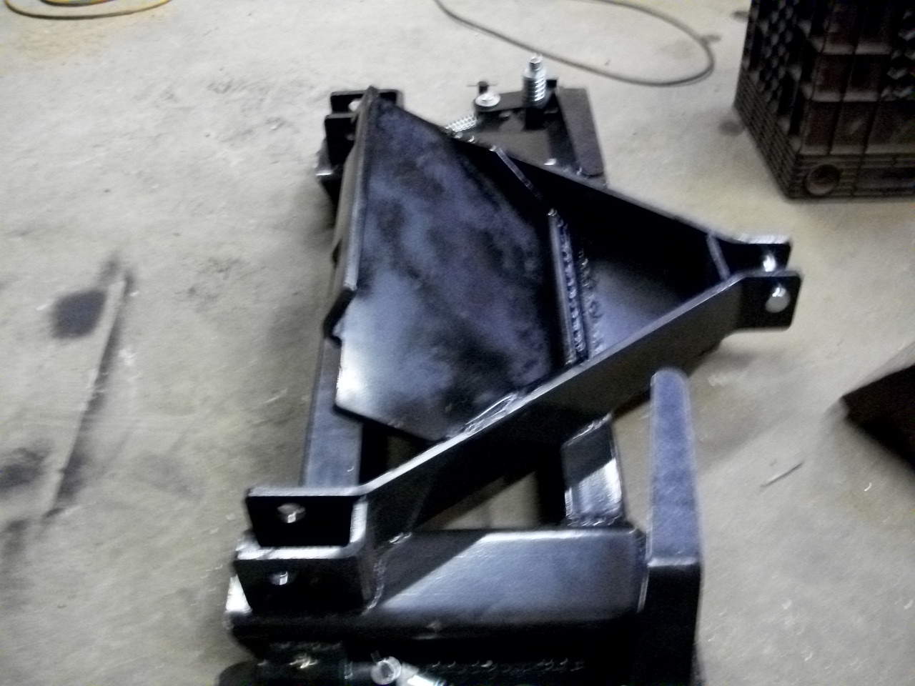

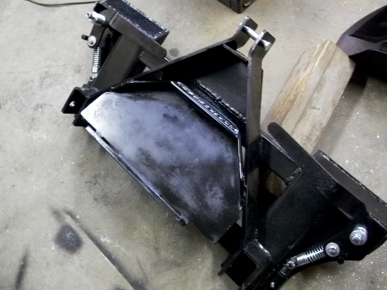

   / PT425 T8 to mini skid (Dingo) adapter? #15
   / PT425 T8 to mini skid (Dingo) adapter? #16
How do the PT Dimensions compare to the Toro Dimensions?
