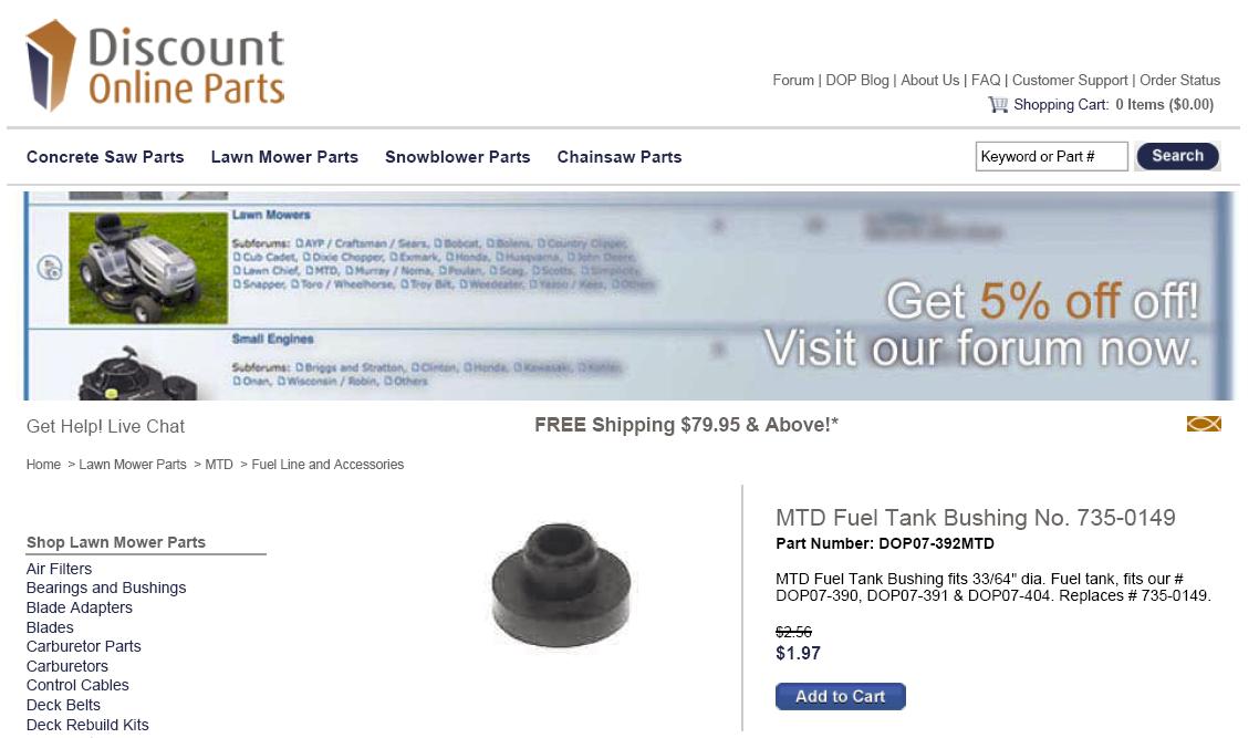

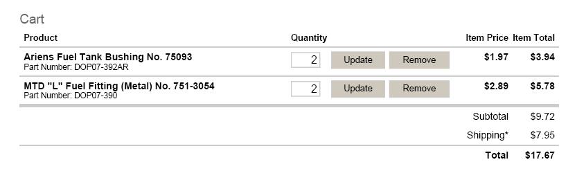

Beautiful! This is the way to upgrade. Can you give us part numbers and suppliers for any parts you added. Like the fitting for the return gas line.

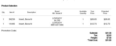

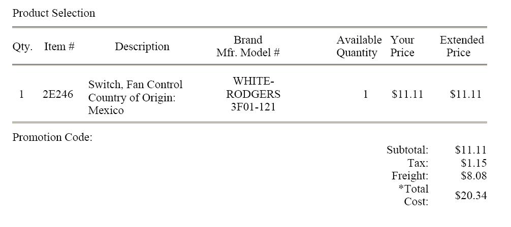

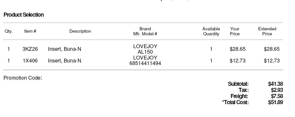

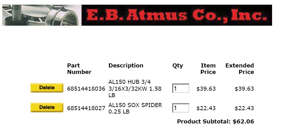

Parts used in the modifications are per the attached files. I replaced the coupling for the wheel drive on the front end of the motor and both spiders (due to wear/damage...not because of any issue with the new motor), added the grommet and "L" fitting for the fuel injection return line, and - thanks to this forum - been able to identify and replace the fan switch.
