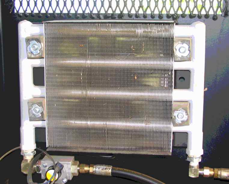

I am planning on putting a hydraulic oil cooler on my 180. Given that the 180 is supposedly built not to need one, I am leaning toward one without a fan, maybe a motorcycle oil cooler. Any comments or suggestions? Also, I was wondering if somebody could post or send me a picture of how their oil cooler is set up from under the hood, maybe somebody with a 422?

I have a 422. I'll go out and take a pict of it.
Could you get a radiator w/electric fan from a wrecking yard and put that on? I think somebody here said that

Hmmm... I have a couple questions.
1. What's the block/knob inline with the hose in the bottom left part of the picture?
2. Does anyone know why they use the parallel pipe design for the flow?
Most automotive radiators "S" the piping back and forth thru the fins don't they? I guess their design would slow down the flow, redirecting the 8 GPM into 4 2 GPM streams.
The only problem then is that the 2 GPM is only being cooled for the width of the radiator vs the 8 GPM flow which could be cooled over the 6 to 8 passes through the radiator with an "S" design.
   / PT180 Oil Cooler #9
That black knob is the heat sensor that cuts the fan on.
   / PT180 Oil Cooler #10
A car radiator is rated at 15 psi typically. I don't know what the pressure is at the oil cooler, but the tubes look pretty heavy duty. I would think that the back pressure created by the car radiator would build up much too high a pressure in my opinion.
