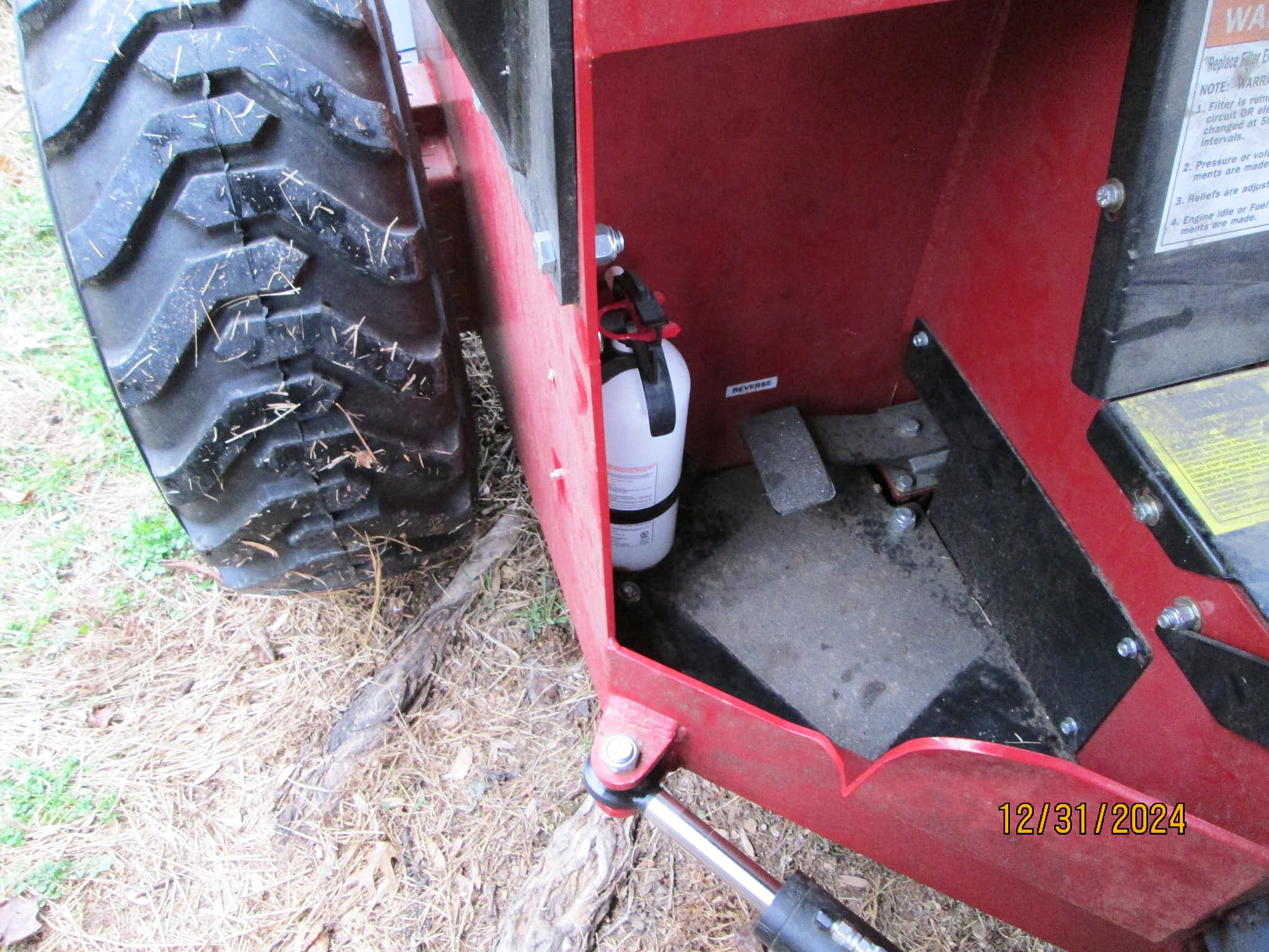

m5040 was correct. The fuel filter was hand tight, but loose when I put a strap wrench on it. Seems to not be leaking now, but this motivated me to drill a couple of holes to mount a fire extinguisher. I think it's out of the way enough that it will work for me.
