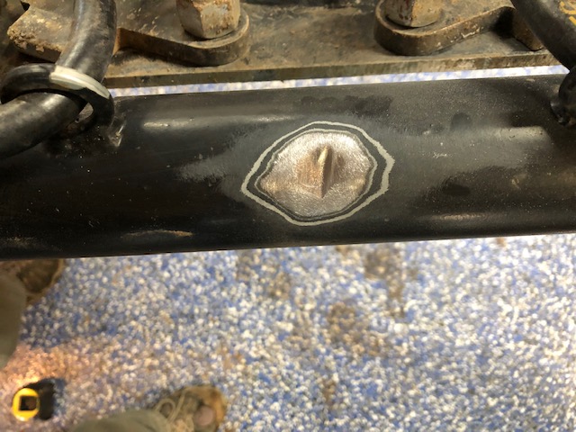

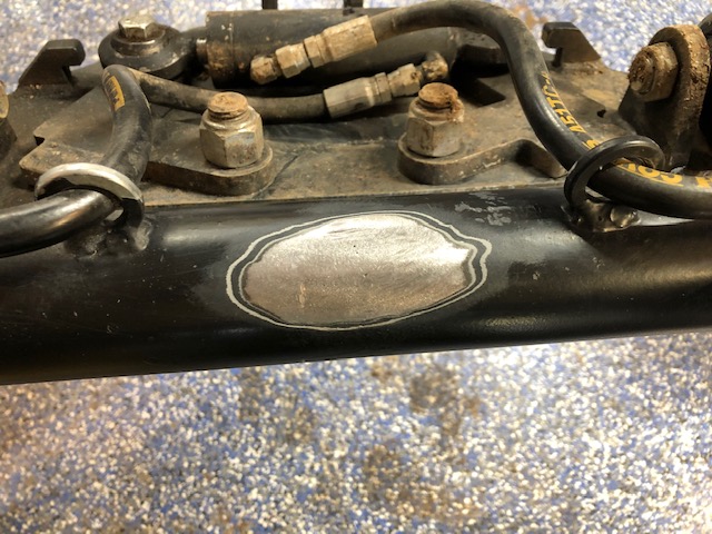

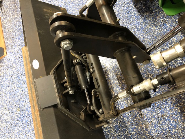

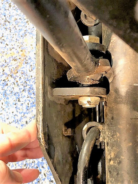

Well, I'm not a welder but managed to fill the dent. No idea if this really returns the tube to it's original full strength integrity or not but Terry said that's what they'd do at the factory.
The cause still isn't addressed. There will definitely still be contact when the QA plate is in full down and retracted (top of QA plate toward the driver) position. Actually in that position it's fine, it's the 1/2" of free-play in the linkage that does the damage.
I'd rather not restrict the cylinder and reduce range of motion....even if I knew what, exactly, a "restrictor" is :).
I could weld stops to the tube as suggested but then I'd just have the collar on either side of the rod knuckle banging into the stops on the tube and perhaps causing two new issues? Plus, is it ok to weld flat stock to a cylinder for this type of repair?
I could grind down the knuckle a bit where it makes contact - it seems to be pretty thick and maybe could get away with taking 1/4" off? I don't want to weaken the joint since I presume there's a bit of pressure between the ball and the knuckle that surrounds it.
Lastly, I suppose I could just never put the QA plate in that position but highly doubt I'll remember that on every single combination of implements/positions

I think that stops are the best idea, you don't want the cylinder to be banging around at the end of it stroke. I would weld a piece on either side of where the rod was hitting on the tube . Then cut out and drill two pieces of 3/8 material the same width as the ears but extend them past. to contact the metal you added to the tube and use a longer bolt and make sure you hav clearance for the rod end then tack them in place. remove bolt and retract the cylinder. and put he bolt back in and cover everything from welding splatter and then weld it up and you are good to go. Now it will have something solid to bump on spread over a large area and not damage your cyl. at the end of the stroke. jim

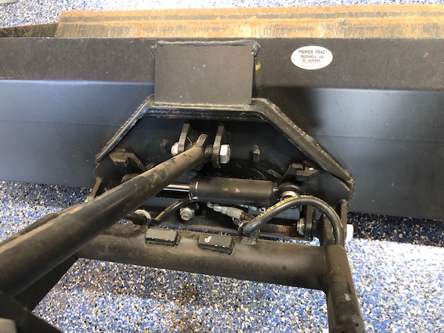

I just wanted to circle back to this in case anyone else develops a similar problem. No sense whining about a problem if I can't offer at least some kind of constructive outcome.
I chose to weld stops on the tube and it seems to be preventing the knuckle from making contact and doing further damage to the tube. The ears on the QA plate do make contact with the added stops but at least it doesn't appear to be doing any damage - just some paint chipping as you can see in the photo.

Can you post a picture of your rollover tube similar to this one taken by ernemats? I want to compare yours to that picture.

yup, here you go..
