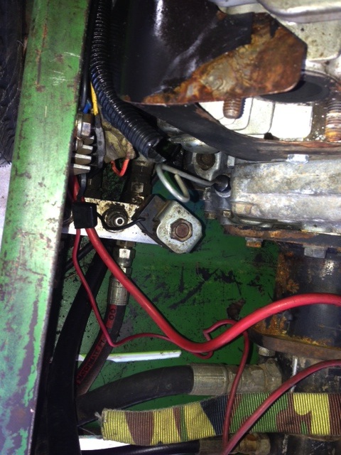

Not exactly sure where the solenoid is located. Is it just behind the starter, under the muffler?
/ PT-422 Hydraulics not working
<img src="http://www.tractorbynet.com/forums/attachment.php?attachmentid=319222"/>
Is the solenoid sitting on top of the spool valve? In the picture it is a couple of inches from the red battery cable going to the starter.

Yes, I am pretty sure that is it. My layout is different.
/ PT-422 Hydraulics not working #6
reach down and grab that solenoid and twist it back and forth a few times (if it will move). Then turn your key on and flip your PTO switch. I don't know your system at all but unless there is a kill I don't know about you should feel the solenoid click. My feeling is that you are missing a wire on the solenoid (Solenoid is an electric valve that is electro magnetically operated). I am not sure, but it looks like you are missing a ground wire. Then again, maybe the chasis is ground.

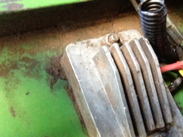

Did you try and fix your solenoid valve with a new solenoid?
#15
photo.JPGDoes anyone know what this is? The wire coming off the solenoid is attached to it, I think.

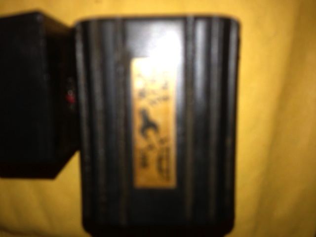

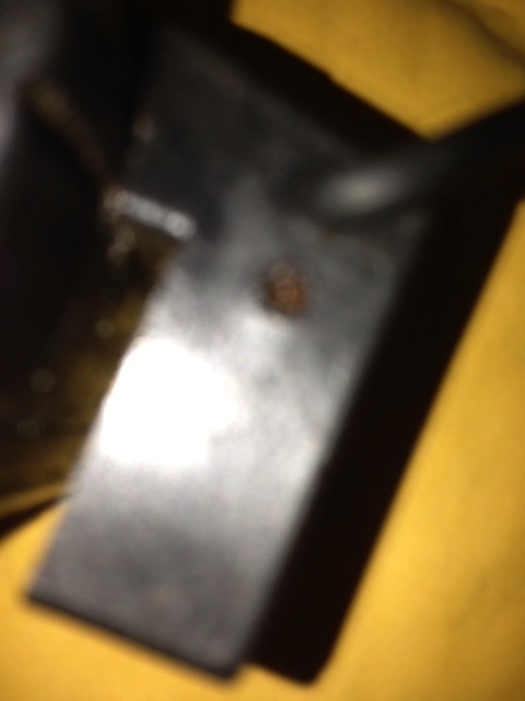

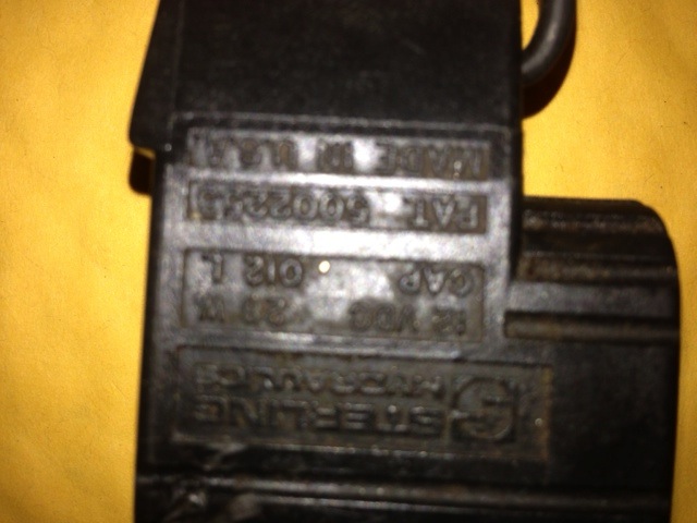

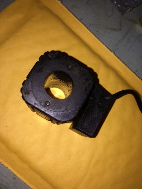

I took the solenoid off the valve. The ground was somewhat attached, the other wire was broken off flush to the base. I have some pictures. Do you think it can be salvaged?Image.jpgImage 1.jpgImage 2.jpgImage 3.jpg
/ PT-422 Hydraulics not working #18
/ PT-422 Hydraulics not working #19
I think that this looks to me like a 12V Sterling Hydraulics Puissant series solenoid type PL or PLE. (The LEs have a built in diode and a red and a black wire. The L series have two black wires. What color is the missing wire?) Solenoid valves , Coils CA - Sterling Hydraulics - PDF Catalogue | Technical Documentation | Brochure
I can't tell from your photos what the ID is, but you may need the ID to match the solenoid.
I don't know if you can substitute this solenoid coil, or this valve.
Based on my soldering skills, if it were me, I would replace it, rather than trying to repair it. I haven't had great luck soldering close to coils.
All the best,
Peter
couldn't hurt to chisel out some of the epoxy or resin whatever it is and see if you can get enough to solder a wire onto.

Thanks for the info Peter. I went earlier this morning to a Parker Hydraulics store in Delaware. I brought the solenoid with me. The employee couldn't help me at all. Told me I needed to goto a Sterling Truck dealership. I told him Parker bought Sterling Hydraulics and there has to be a way to cross reference. He just gave up.
I know one wire is black. My guess is the other wire is black too, because I don't see any loose red wires anywhere in the tub. The solenoid you found at Surplus Center, how can I find out if that will work with valve I have?
