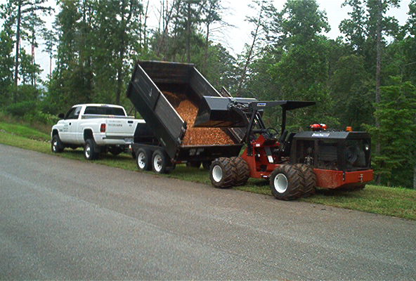

Next job..
Moved 2 ton of decorative stone and laid it on a 30 degree slope.
It started pouring rain...but the 1850 came up th eslope, no problemo. /forums/images/graemlins/smile.gif
It works much better than the JD 4115 scooping out of the dump trailer.
