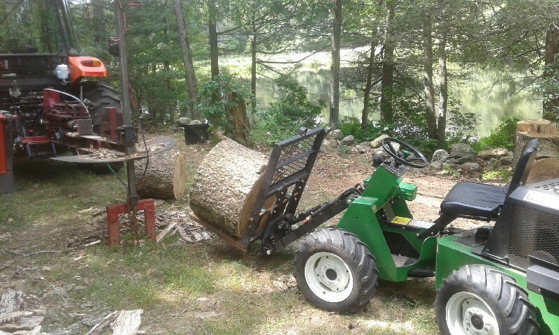

I would add a metal frame to the forks that things can lean against. It would be even nicer to have the forks adjustable.

I made my own fork attachment out of an old masons walk behind. It can lift until the rear end comes off the ground, which most likely happens when you turn the machine because it effectively gets shorter-causing the counterweight (engine) to get closer to the loade.

And as far as you worrying about the forks not having a guard. That is nothing compared to how bad the loader bucket is.
As you raise the loader arms from ground level to full height, the bucket angle tips back and will dump the load off the back toward the operator IF YOU DON'T MANUALLY UNCURL THE BUCKET AS YOU RAISE IT.
These machines are not toys and you will need to keep your attention when operating.
