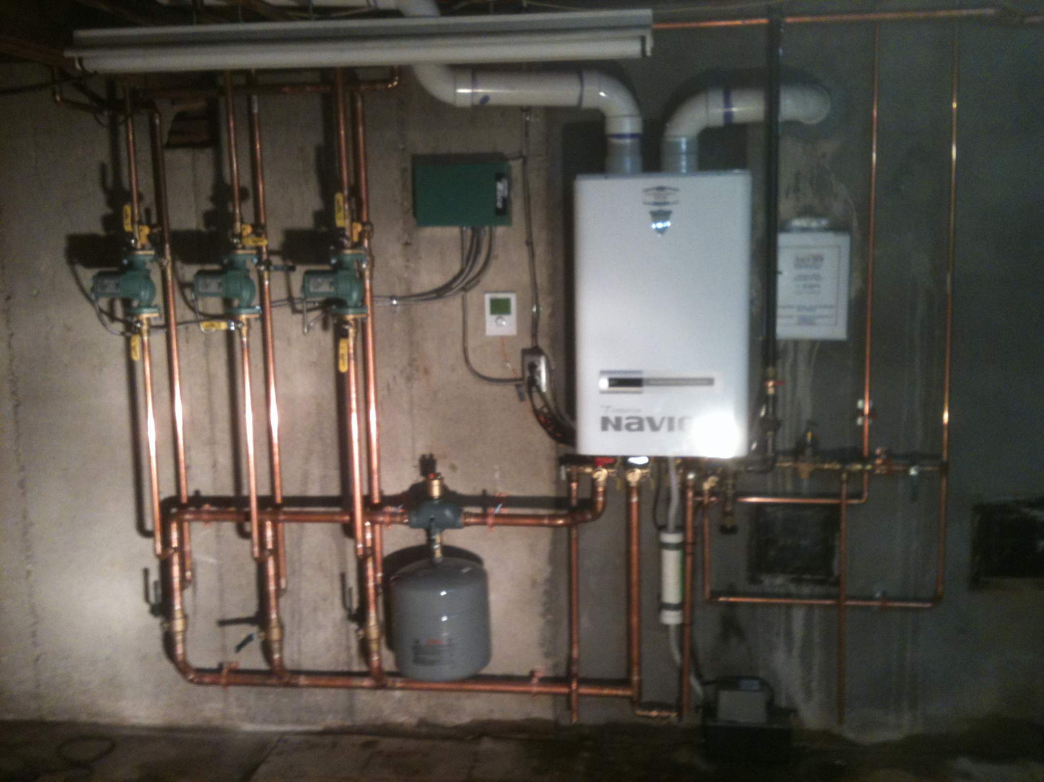

Last fall I had a Navien condensing gas boiler installed to replace an old oil burner. Boy do I love it. The fuel savings are amazing, my house is 1200 SF located in CT and I went from about 450 an month for oil to about 150 a month for natural gas. I understand that natural gas be cheaper than Propane but there would still be a big cost saving for you.
My unit also makes domestic hot water and I had three zones installed so there are three circulating pumps. The total cost to remove the old furnace and tank and install the new system was about 8400.00. I didn't think that was too bad considering how much work was involved to do the whole job.
Check out Navien boilers.
