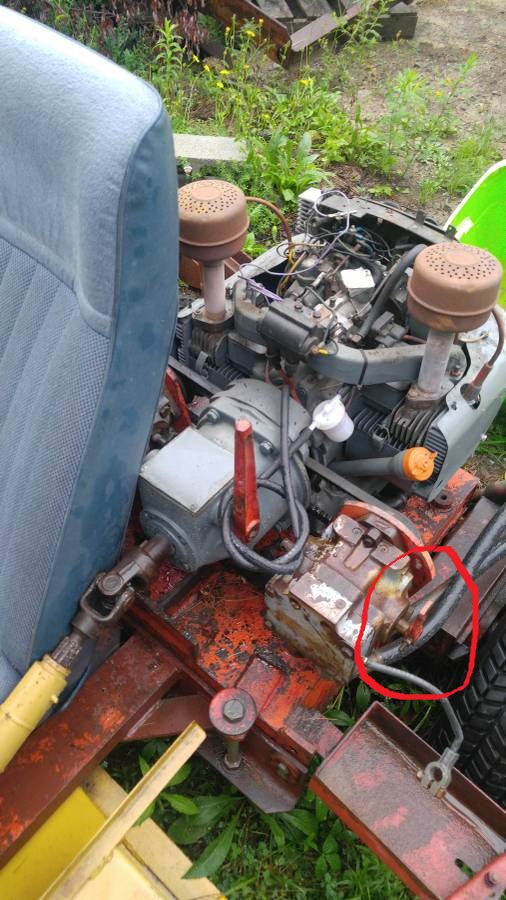

Its got hydraulic wheel motors, so it propels itself.
I saw that but assumed they were not operable. Looks like a bracket on the back with a pin to hook up to a 4 wheeler etc.
/ Projects that make you shake your head #25
None whatsoever . How do you steer it ?
Pretty sure you reach around to the outside of the pump and move the lever by hand :D
I like the exhaust pipes sticking straight up as well. Nothing like a cylinder full of water to start your day.
Also, given that the seat looks dry and the rest of the machine looks wet, I would guess that the seat it sitting there.
Aaron Z
There's two pumps, so you'd have to have gorilla arms to reach behind you and to the outside of each pump to reach the direction controls on each one.... perhaps some handles could be made from some scrap ski/elliptical machine found by the curb on trash day?

So....how exactly does this contraption turn? There doesn't appear to be any wheel, control sticks, or other linkages.
#30
It has variable displacement pumps and a rod that sticks out of each pump to adjust the blow (see:
http://www.tractorbynet.com/forums/...you-shake-your-00303_4sn7rj3yfrh_1200x900-jpg its the rod sticking out the side with the red collar and a bolt through it), but no human usable controls from the seat area.
It looks like a half done, poorly thought out project to me.

Are all of these replies in jest or do you guys seriously think this unit is intended to be ridden on?

I suspect that it is supposed to be a walk behind unit, but it is self propelled and it is listed as a "Zero Turn" so who knows.
I circled the lever on the side of the pump in the picture. Move it one way, go forward, center to stop, the other way to go backwards. There's an identical pump on the other side of the machine for the right wheel motor.
478683d1472170083-projects-make-you-shake-your-zero-turn-jpg
