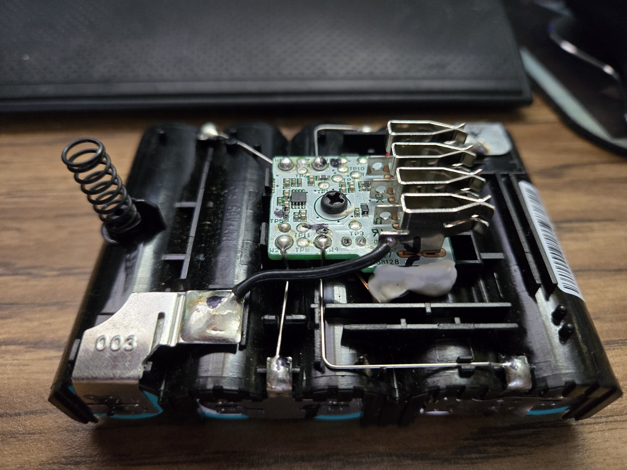

you don't need to desolder all of them generally if its an all series pack, its pretty easy to find the bad one, spot welding can be a bit of a learning process as well.
That was my original hope. I opened it up expecting to find a series pack that I could replace a bad cell or the whole set. Like @California's experience, the design had each cell individually embedded into the board with irregular tabs and measuring the voltages across the cells wasn't informative. I suspect that the board equalizes each cell, because the appliance, a Black&Decker "Flex" hand vacuum, runs out of juice, shuts down and then 30 seconds later has more juice, lather, rinse, repeat.
The board and cell integration was the most complicated that I have ever seen, although the board itself was a very low cost board. My apologies for not taking photos.

The factory battery packs he cracked opened had chips and circuit boards in them. I think these are called BMS (battery management systems?). I think these control the charge rate, maybe slow it down for the last 10%, and help keep the batteries more equally charged. I’ve learned a lot of this from e bike forums which sone of the e bike battery packs can cost $1000 or more.
I suspect the fakes don’t contain this or if it does lower quality and that’s why they lack in performance.

all lithium cells, use a bms correct, what it does is charge each cell individually so they don't become "unbalanced" this can cause stress to the individual cell which can ultimately cause it to catch fire. the bms can also monitor the amount of current allowed, the temperature of the pack, and the voltage cutoff point so the cells don't go bad.

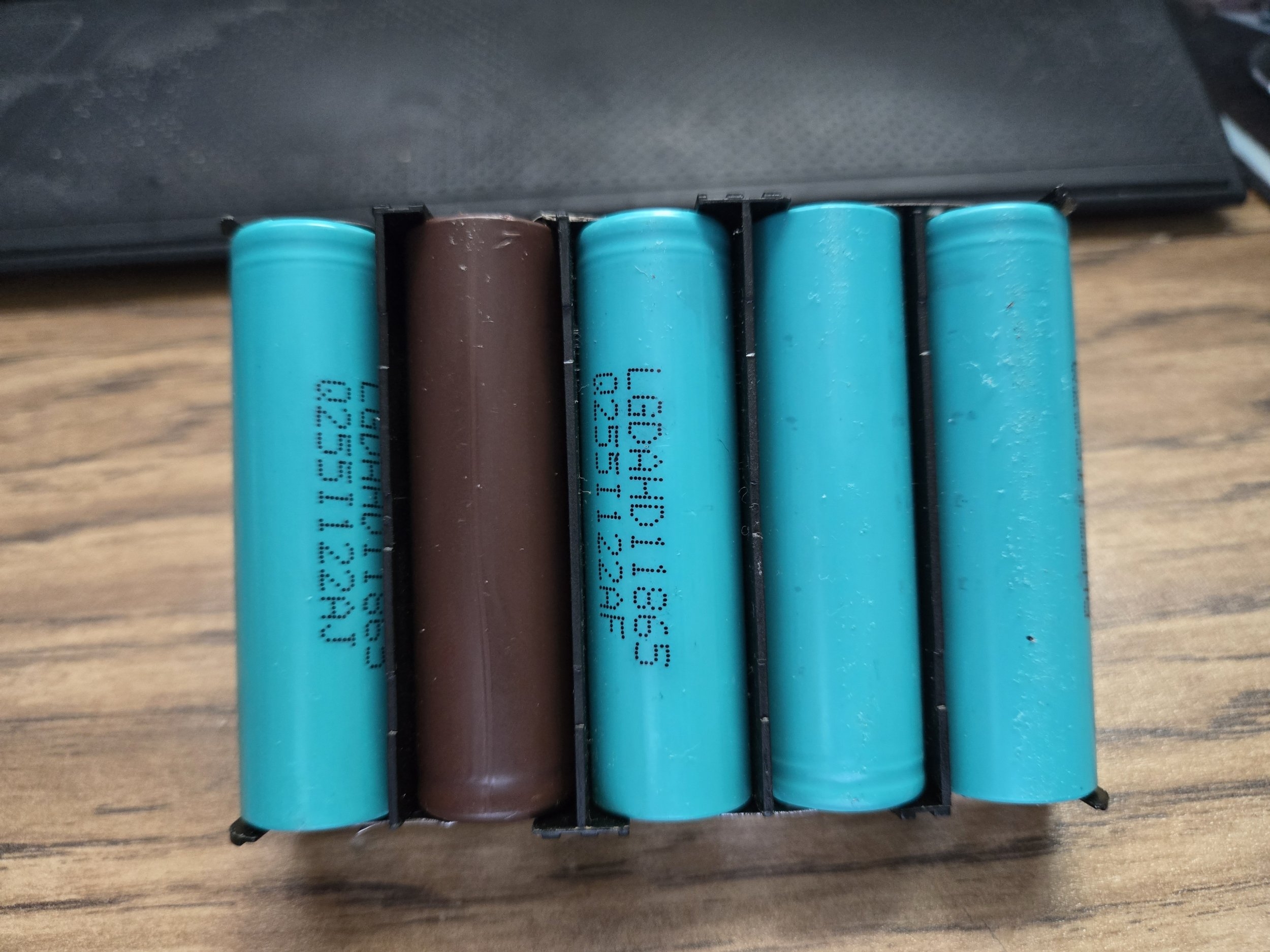

here is what the inside of my BD 20v 2ah pack looks like.Ignore the brown cell, it was used to replace the bad cell in the pack
