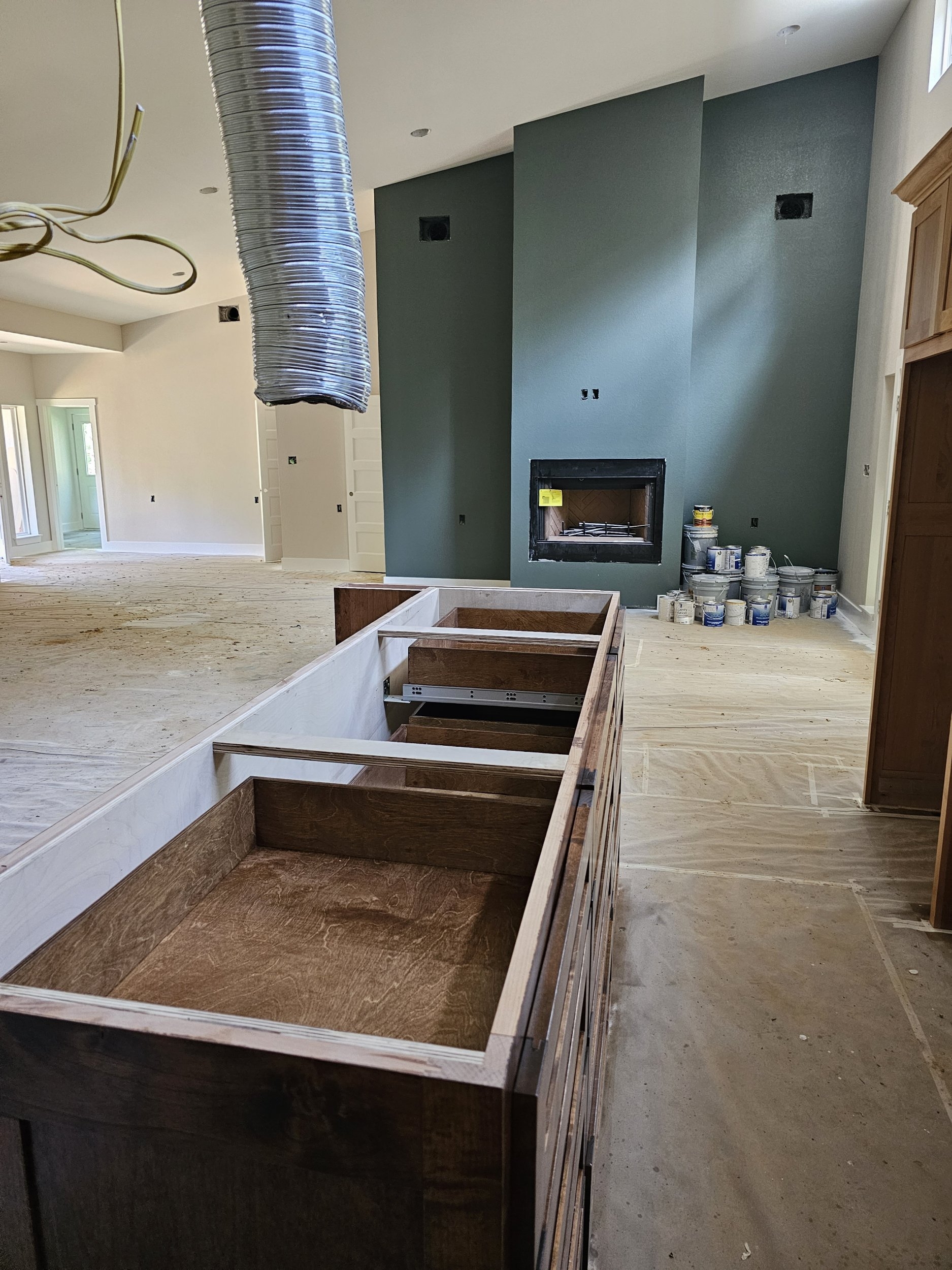

I told them where I wanted all of the utilities. The room was designed specifically for that purpose. Water heater, HVAC and Elec. panel all in there) House is a single sloped roof. One story with a partial attic over the bedrooms. Mechanicals room is in the SE corner of the house. The outdoor unit, is just outside the door there.
The main living area is lofted, so it looks bigger than it is.
This shot is from the kitchen toward the family room. MB is on the other side of fireplace wall (there is another fireplace in there). This is the only shot I have right now where you can see vent/ducts. Front door is to the left, back door to the right. The ducting in the foreground is for the cook top hood.
