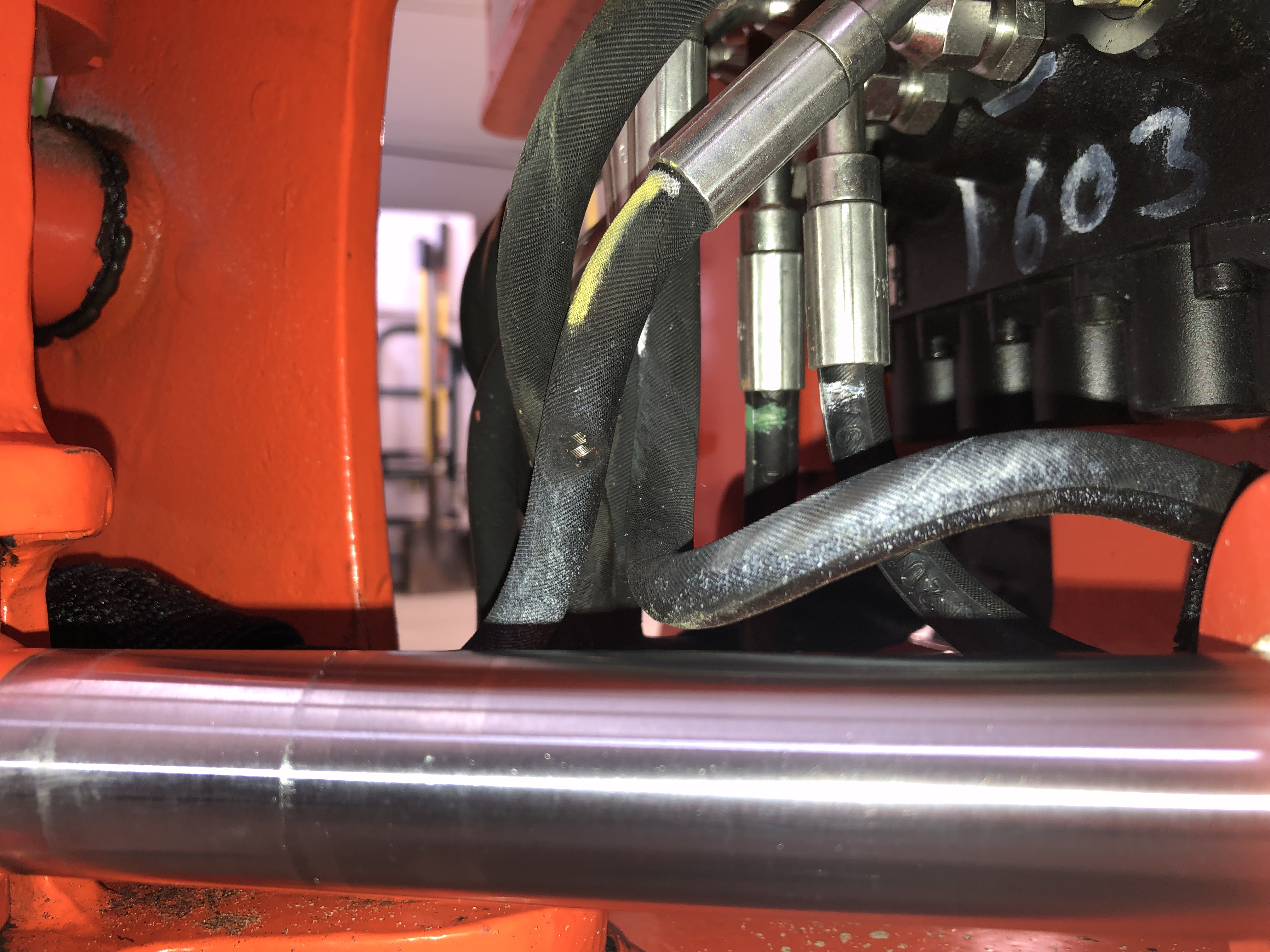

New SC-TLB owner here. Just picked up my new BX23S last Wednesday. First day of use, after about 3 hrs, I saw hydraulic fluid spraying out of a BH flare fitting. Two of them were loose and a third hose was rubbing on the swing cylinder at full left. Tightened the fittings and moved the one hose slightly to avoid rub. Should I worry about the amount of rub I have on this hose? Second question / observation. 11/16 does not seem to be an exact fit for the flare fittings, there is a tiny bit of "slop". Is there a special wrench for these?

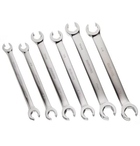

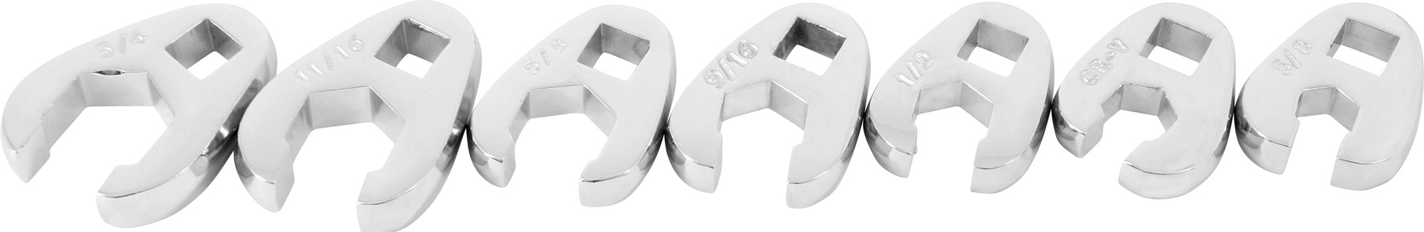

I found a set of wrenches specifically meant for flare nuts. The flare nut wrenches came from Canadian Tire. The crowfoot wrenches came from Princess Auto. I found that they fit the flare nuts better because they wrap around the nut. The crowfoot wrenches allow you to reach into difficult places like under the backhoe frame. I'm sure you can find the same tools in the US somewhere.

Thank you, great tip. I'll check Amazon.
