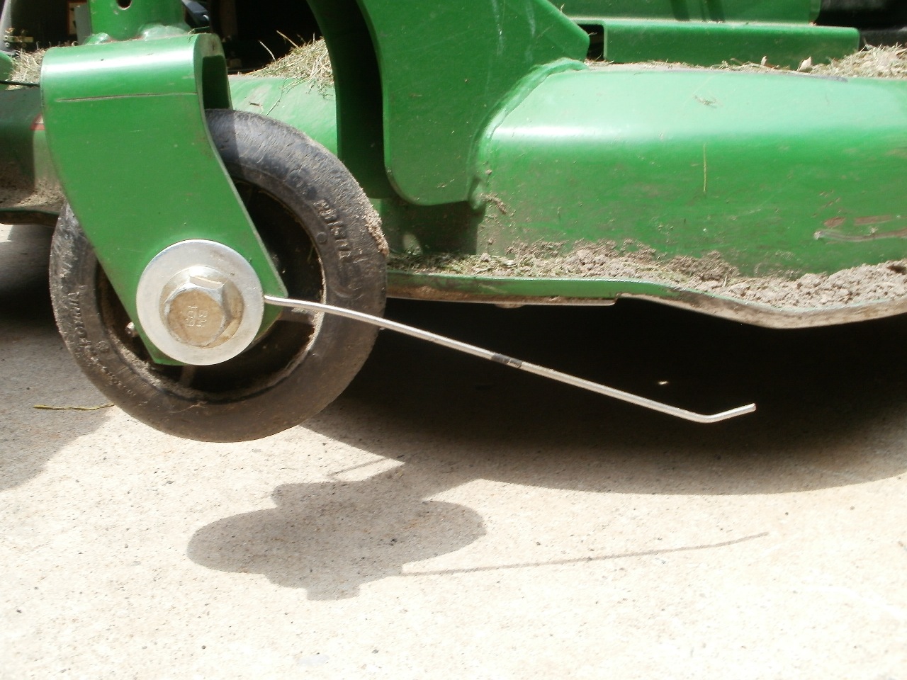

After owning a 62D deck for at least 10 years I am still having problems with the front gauge wheels putting trenches in my yard. The wheels simply do not have enough castor on them so they fail to rotate toward the rear and end up gouging trenches in my yard. Anybody else have this issue or has a solution been found? When the deck was new lots of people on this forum had this complaint and my dealer did several things for me. He replaced the flat bottom wheels with rounded ones and he installed a zirk fitting into the wheel pivot. These fixes have never solved the problem. If I routinely take the wheel pivots apart and clean them so they rotate freely they will work to a limited degree for a short while but as soon as they dirty up a bit they fail to pivot again. I have come up with several temporary fixes that each have their own limitations. I'm getting so tired of this so I figured I'd see if anyone else has found a "permanent" fix. Do the newer decks have this problem? I recently talked to my dealer again and he said he has never heard of this complaint. Thanks.

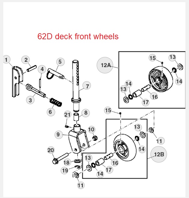

There is quite a bit of caster already on the front gauge wheel yokes, but there should also be a bridle on the vertical shaft with a tension spring to pull the yoke to straight ahead.
Set the deck on a flat level surface and see if the wheels are supporting the deck weight at all. Could be that the deck is sitting on the front and rear rollers.
/ Problems with front gauge wheels on 52D deck #4
Looking at jdparts, the front deck wheels show a yoke, and no springs to bridle the wheels pointing straight ahead.
However, the operating manual tells how this deck is to be carried by the tractor, and not lowered to run on the ground. The deck wheels are only for limiting scalping. That wasn't mentioned, so figure the deck may be set up wrong (and some dealers I'm aware of don't know that is how it is designed).
Once the deck is leveled out on a flat surface, the gauge wheels are to be set 1/4 to 1/2 inch above that surface.
And if something is bent, they won't caster very well.
