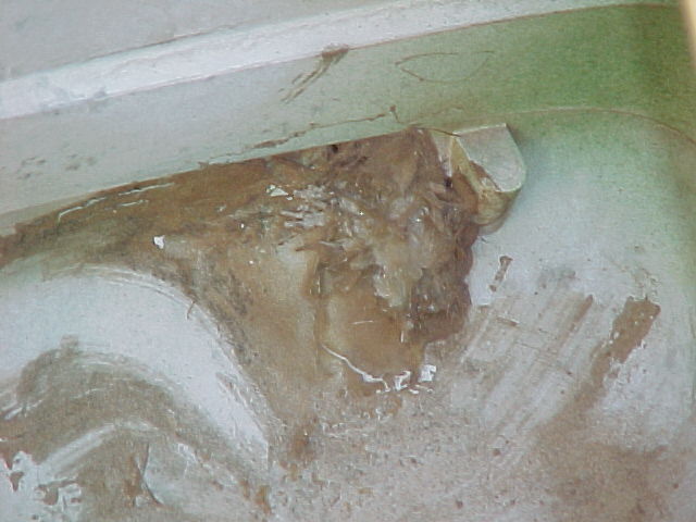

Hello,
This thread never really got to the bottom of HD plastic polymer repair for newer tractors hoods, fenders, etc. I thought reviving this topic now (2 years later) would allow everyone a chance to contribute to an update.
My JD855 (1997 model) is a generation older than the 4000 series and the 4010 series JDs. The hood on my tractor is definitely fiberglass. I suspect either fiberglass or plastic is found on other brands ,too.
A couple days ago I began a thread on my version of grille guard. Puting a hole in my fiberglass hood with a piece of firewood that missed the loader bucket (ouch!) was my motivation to build a grille guard in the first place.
This happened about a year ago, and I repaired it right away. I didn't take a before picture, but here's the inside of the hood, now. The hole was all the way through the hood and about the size of golf ball. The brown spot in the middle of the picture is where the hole was.

Here's a closer look. Not too pretty, but usually not in view.

Now, here is picture of the outside of the hood, where the hole was. You can see the paint job on the front of the cowling is not as faded, yet as the rest of the hood. With close inspection you can tell there was a repair, but a casual inspection would never reveal it. I used a fiberglass repair kit from an auto parts store ($15-20).
The white surface scratches are not where the hole was and have happened since the repair was complete.
