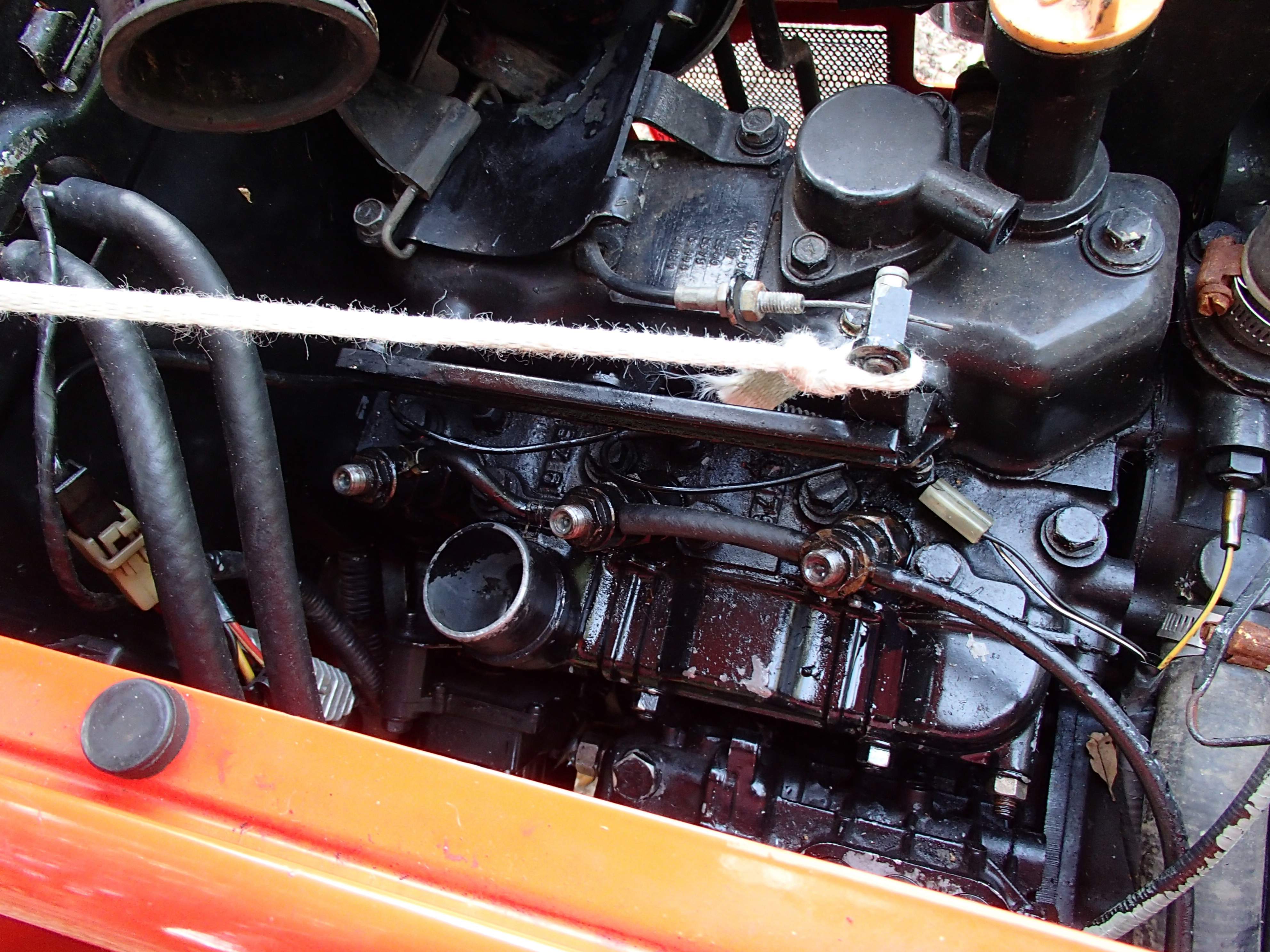

Has that model got an electric fuel shutoff? could be the culprit.

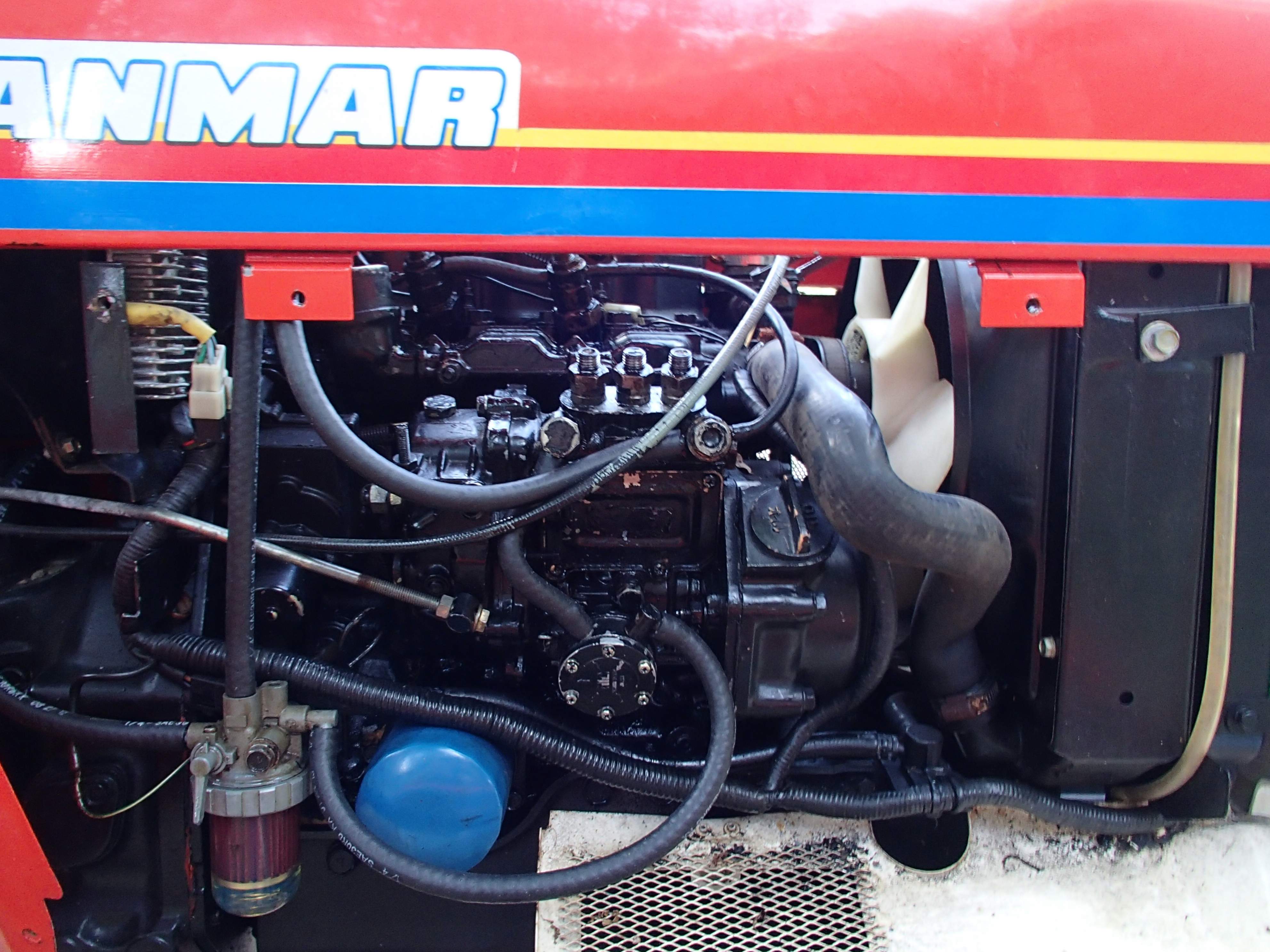

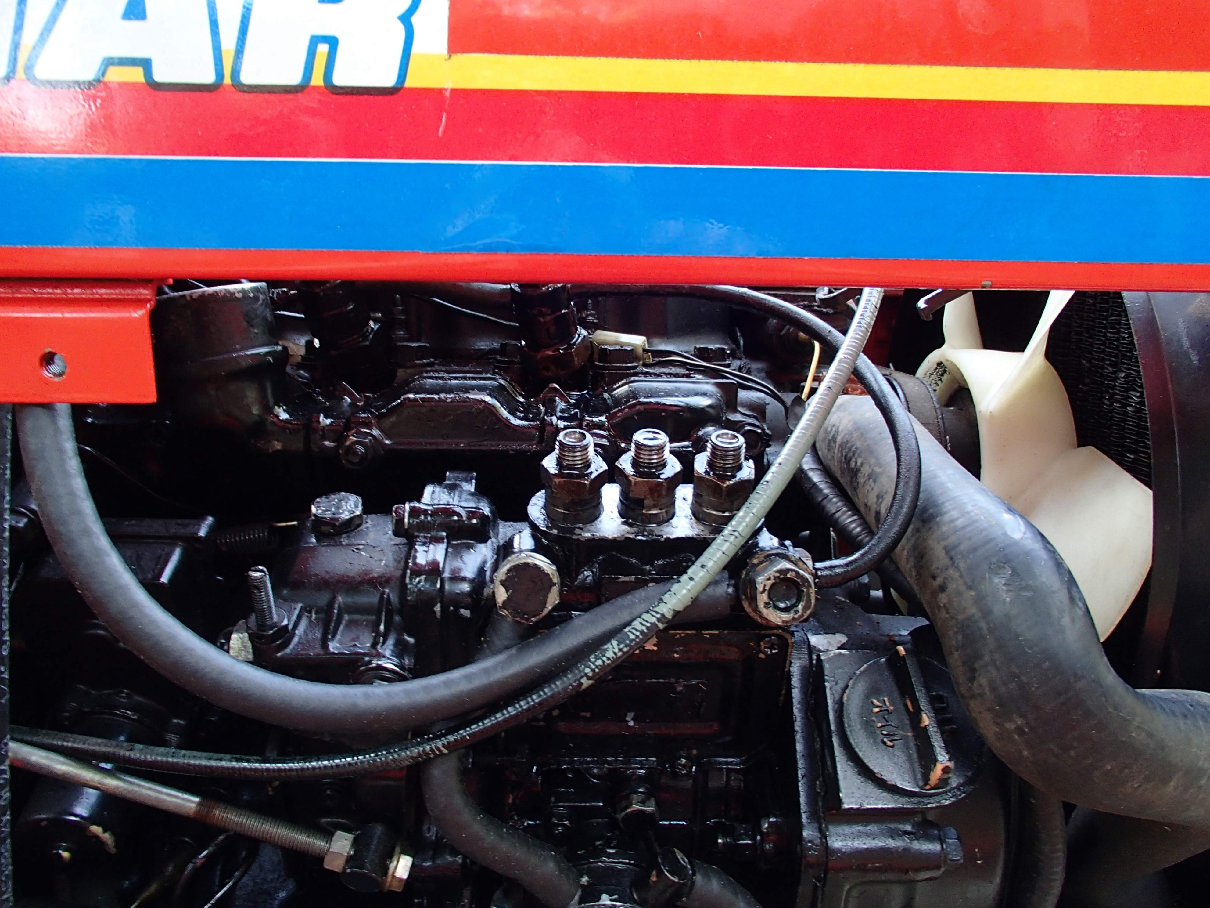

The only thing that I can add at this point is I see a lot of hoses! What I mean is there is 3 at the fuel bowl alone and there is another round housing that's I presume either a transfer pump or another filter, is anything misrouted maybe or leaking air I dont see any clamps?
I wish I could offer a more definitive solution but thanks for the new pics it should help someone help you I hope.
edit: I wonder if that round housing happens to be a fuel heater it would have coolant running thru it somewhere probably the rear?
^^^^This is what the problem was. There is a lever on the backside of the IP that was connected to a solenoid. I disconnected the linkage from the lever, and she fired right up. I had thought the lever was some type of governor, and didn't pursue that as a problem until you said that about the fuel shut-off. THANKS!! :thumbsup:
