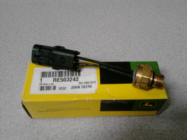

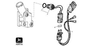

I believe the problem is the thermistor sensor. On the thermostat housing there is a sensor that is connected to a two wire harness that goes to the injection pump; this is the "cold start advance" portion of the system so it starts easier when cold by advancing the timing.
When the sensor on the thermostat housing fails it shorts out and blows the fuse. Try unplugging it, replace fuse and see if it starts and runs. The part # is RE503242, if you are quick changing it, you don't have to drain the coolant, just make sure it's not hot at the time. You will want a pan under the tractor to catch the coolant, so as not too have to clean it up.
You may need to re-prime the fuel system, if it still does not start
To comply with the exhaust emissions regulation, the timing of injection pump should be around 6 to 9 degrees before TDC. These timing values do not allow proper start-up operations when engine is cold. To ease engine start-up, a cold advance system gives to the injection pump a temporary over-timing.
When coolant temperature is below 50 C (122 F), the solenoid valve is activated and opens the cold advance circuit.

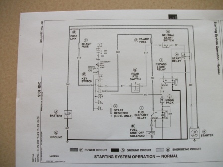

Hello , I have a similar problem with a 5105 the tractor will start but when you release the sw. from the start position the engine will go dead

Danny996, hopefully someone will give you a better answer.
Plan A - I suggest you go to selectmanuals.com and order the tech manuals. For your tractor $29.95 and find the pages and write-up that speaks to starting system operation. If you would like some help with looking at the pages you can post those pages or send me a private message. I will look at it.
Plan B - I have attached starting system pdf for my 5210, which also has a 2.9L engine, you will need to determine how close this matches your tractor. Since it starts it is not a safety switch problem, while it could be in the key switch, still think it would not start. Most likely the fuel solenoid is losing power.
The fuel-shut off relay could be getting some stray voltage causing it to get energized. While the 2.9L is a 3-cyl the start resistor could be bad (my 2.9L has the resistor), the role of the resistor is to stop a small amount of voltage which can be created at the end of a start cycle. There could be a problem in fuel shut-off relay.
Before starting the tractor with the key in the run position, take a voltmeter and see if you have voltage at the fuel solenoid. If you do, try starting and after releasing the key see, if you do. Please share your findings.
Do NOT be in a rush to take off the injection pump!
I am having the exact same problem and have cleaned everything electrical no change have you found a solution?
this is killing me just bought It 3 days ago
