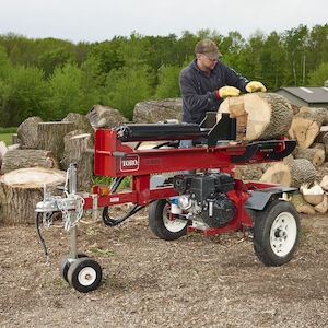

The problem on the Toro is with the wedge wiper design. To clarify, the wedge wiper straddles the wedge and will push a stuck log off the wedge as the ram retracts. On many other splitters, like a Bareto, the wedge wiper is hinged so you can swing it down into position when needed and it stays up out of the way when not needed. On the Toro, it's fixed and has about a 1 1/2" gap between the top of the I-beam and the bottom of the wiper. During auto return of the wedge, it's very likely the wedge can sweep a piece of wood into this gap bending the wiper up and out of whack. In my case, it was enough to bend the wiper and snap the 4 bolts. On the hinged design, this can't happen, because it would merely pivot the sweeper up on its hinge.

If I had a good side photo of the machine, I could explain it better. On the wedge wiper, (the heavy metal black piece that the wedge retracts into), it rides 1 1/2" high, so it clears the bolted wedge carrier as it returns. The wedge carrier is what slides back and forth on the I-beam. If some wood happens to get stuck behind the wedge, the returning ram carrier can wedge that wood into that gap, pushing up on the wedge wiper.
That's what happened to me and it was enough to bend the wedge wiper and snap the 4 bolts that hold it.

Not quite as easy to see in this stock photo of the Toro, without be blowing it up. But you can see the gap under the wedge wiper. I piece of wood caught behind the wedge carrier as it returns and can generate some significant leverage to bend the wiper upward or out of position. So, on a subsequent ram return, the carrier itself might strike the wiper and snap it off.

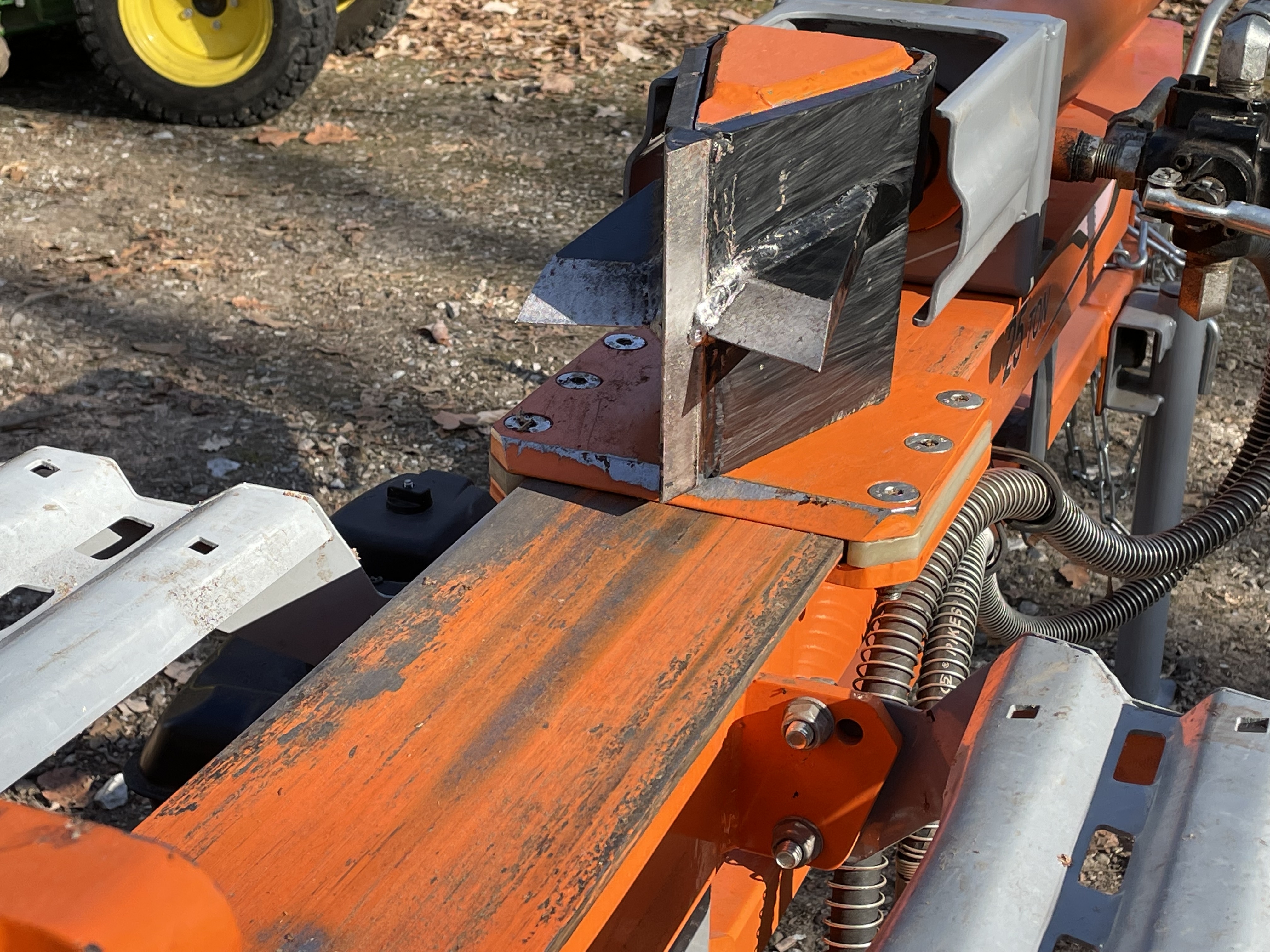

This is a picture of mine, it’s fixed and I’ve never had a problem with it but it’s a little different than the one you had a problem with. It’s the gray piece around the wedge in the picture. I agree what’s the point of getting the “insurance” if they won’t cover it.
