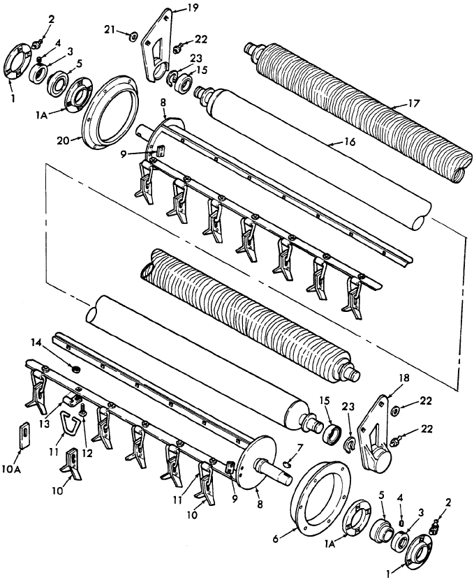

Scott, for the race (item 15) stuck in the bearing housing (item 18) see pic, if you have a welder weld three 1 inch beads on the inside of the race and let it cool. The welds will shrink the race and it should come out of the housing (item 18) with no real effort.

I would like to know if part number 23 which is the E ring was removed???

It appears to me that it has to come off as an assembly (which I attempted to do with a hub puller and heat. The back of the bearing holder/height adjustment supports the back of the bearing and will not clear the inner bearing.. Not enough clearance for a dremel. It is part #11 and #1 on the parts sheet. Maybe I didn't get the inner hot enough but it is hard as the rest of the assembly acts as a heat sinkInkedParts_L2jpg.jpg
/ problem removing NH flail mower bearings (roller) #13
OK, did you remove the E ring(part #14) on both ends???
It is part # 11 on the other parts lists.
