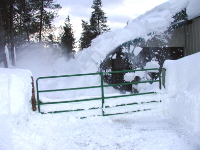

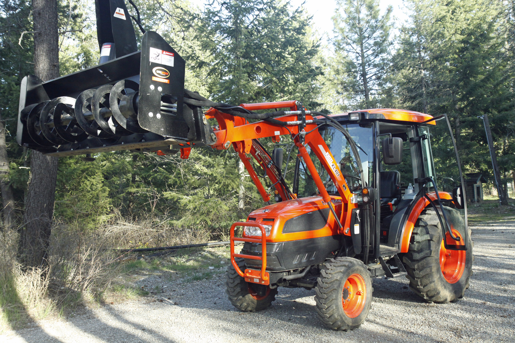

my front loader mount will lift as high as my loader arms can lift, but thats because its fed by rear hydraulic lines. front mounted units that power off of mid pto's cant lift very far up. ready to blow roof.jpg
   / Pro/ cons and issues with front-mounted Snow Blower for Compact Tractor #32
my front loader mount will lift as high as my loader arms can lift, but thats because its fed by rear hydraulic lines. front mounted units that power off of mid pto's cant lift very far up. View attachment 676555
HA that would work but not sure they make one for the GC series LOL
man could I clear a bank nicely with that unit, don't want to move to maine and be my friend do you ? LOL

Sweet. I looked at the rear pump/ hyd blower idea. If you have to blow it from that high, thinkin you need a bigger tractor. I do enjoy watching vids from Europe, where they have mega snow chompers.

i dont ever need to go that high, but when i clear the snow that sheds from barn roof it needs to go pretty high. if i dont clear it it melts and runs into barn, and the horses cant get in or out. snow shedding e side BEFORE 2008.jpg snow shedding E side barn DURING 2008.jpg snow shedding e side AFTER 2008.jpg
when i used to have to clear this with rear blower, i would have to use bucket to bring down some snow, then turn around and blow it. took about 4+ hours per side. with the front blower i raise unit up and drive until front wheels touch snow, back up and lower and go forward again. maybe have 30 minutes per side at most now.
