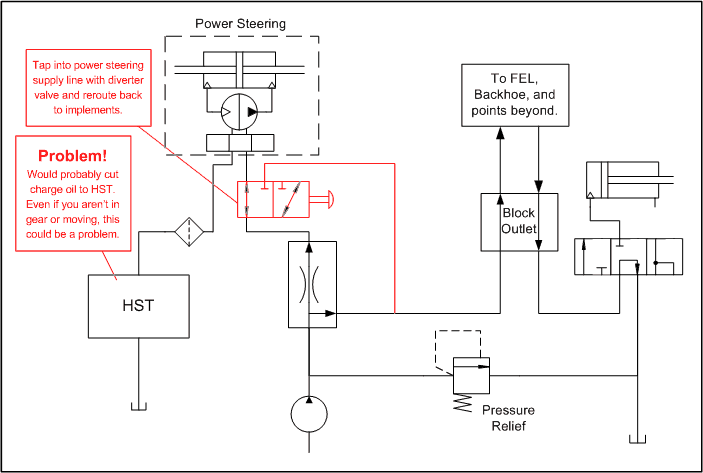

RickB, Are you proposing what is in the attached drawing? Most cuts and subs I've seen with Priority Diverters use the output from the power steering to charge the HST. I think cutting flow from the HST, even when you aren't moving, might be bad.
If Iplayfarmer's profile is correct, he has a Massey 1215. I'm not familiar with the flow paths on the 1215. Would want to make sure he doesn't cut fluid supply to the HST though. If his priority flow is ONLY feeding PS, then the diverter idea sounds pretty good.
That's right. I'm talking about my Massey 1215.
You're going to have to explain how the Power Steering would charge the HST. I thought that the HST was a whole separate system from the accessory hydraulics.
Of course there's another crazy idea... Could I guy use the flow from the HST??? What would be the implications of that?

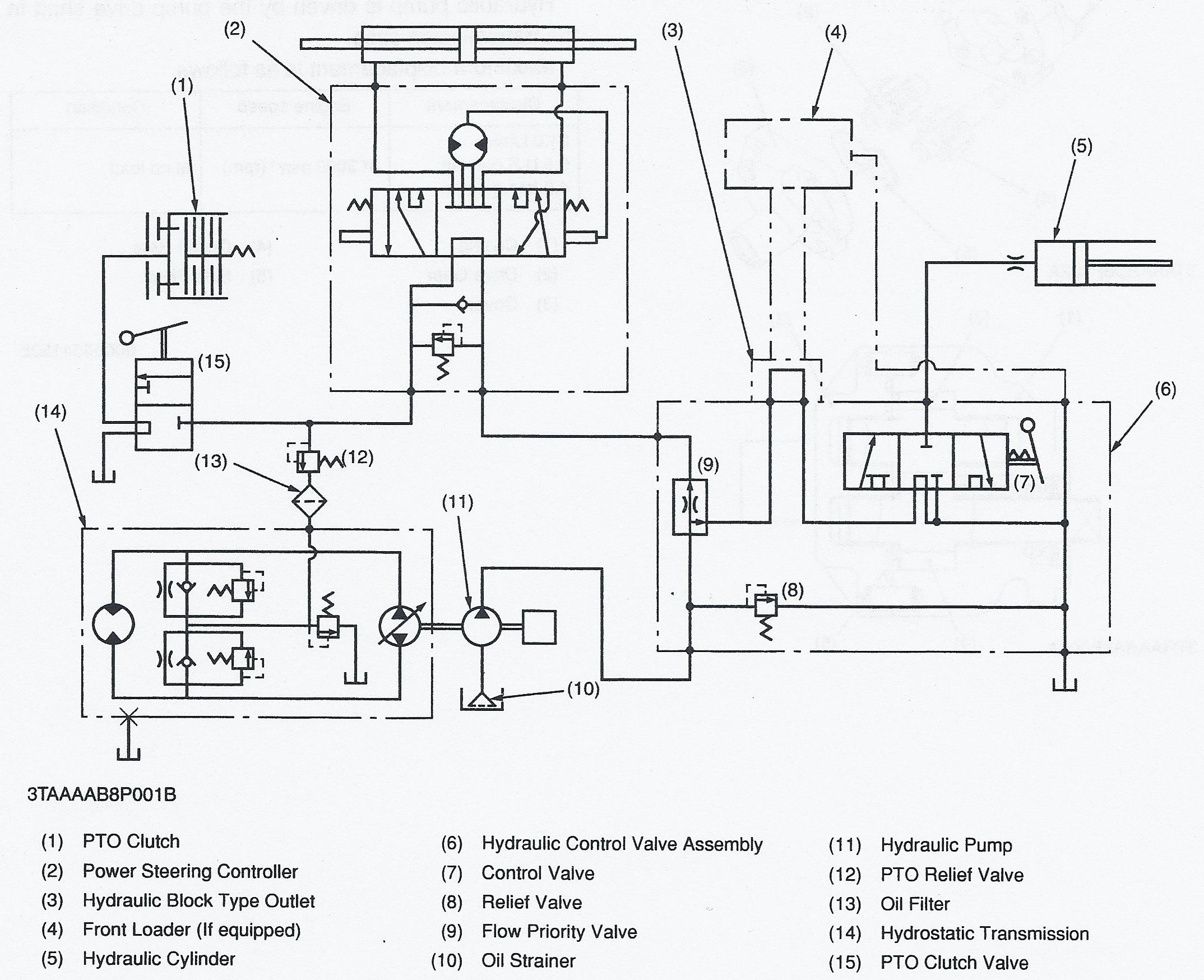

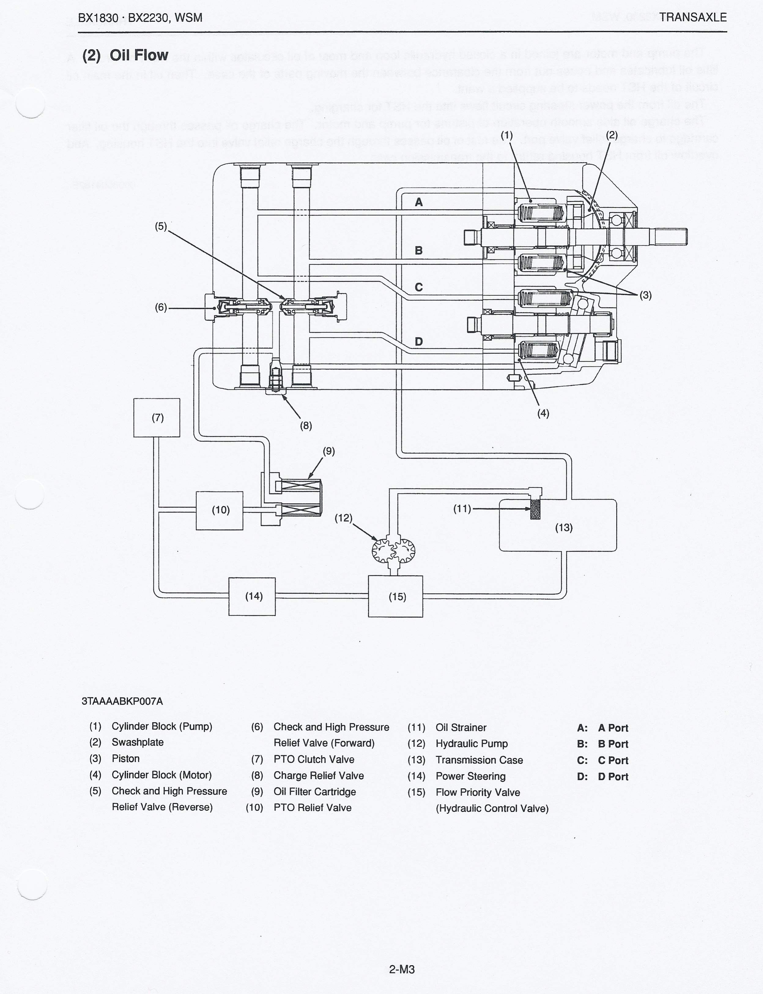

Don't know that I'm the best to explain it, but I'll give it my non-professional best. Your right in the idea that the HST is a closed loop system with a self contained pump and motor. But there is always some leaking past the HST pump and motor. The oil that leaks out has to be replaced (charged). The HST always has a high and low pressure side. The charge is always injected on the low pressure side of the HST. Because of this it doesn't require a very high pressure to charge the HST. Many small tractors (maybe big ones too for all I know) use the output from the power steering to charge the HST. The Power steering doesn't draw very much head off the flow, except for very short periods when turning the wheels under heavy loads. Because of this there is ample energy left to charge the HST. In the attached diagrams you'll see that my BX2230 puts priority flow through the power steering, then through a pressure relief in front of the filter to maintain high pressure for the PTO clutch, then through another pressure relief in the HST. There is plenty of energy in this flow for charging the HST.

I'm not saying that this is how the Massey 1215 is set up. As I stated earlier, I don't know much about the 1215. The HST on the Massey may be a completely separate system. I'm just saying be very sure that the PS loop does not charge the HST before diverting the flow.
