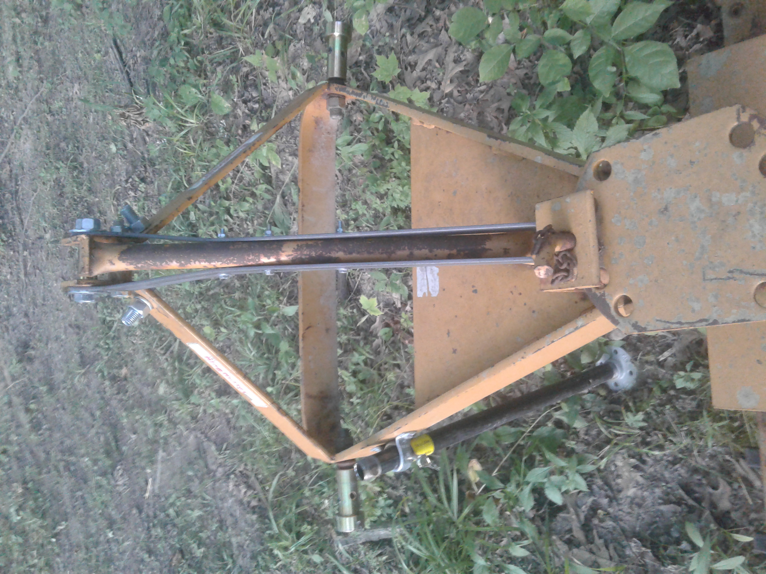

Another advantage of the generic Qhitch:
You can use the QH to push the implement around when its embedded in the ground or mis-aligned. Instead of using brute muscle and cussing, or having to carry a long prybar out to where the implement is stored.
Photos of other applications aside from implements:
A lifter for a spike harrow that had been designed for drag-only. The mast and pulley are from exercise equipment that a neighbor abandoned when she moved out.
(Running the cable over a pulley and back down to the tractor drawbar doubles the amount of lift).
The QH also provides a place to mount a toolbox on this small tractor.
307656d1363028011-harbor-freight-tools-dont-suck-p1710751rspikeharrowlifted-jpg
Drawbar with trailer ball. It attaches in a moment. The little tabs are welded to adapter sleeves then bolted on. They prevent the bar from rotating.
475243d1469142470-pats-quick-hitch-vs-northern-kimg1766rqh-toplinkpins-jpg
Compact ballast for backfilling a trench, in a tight corridor between the barn and the fence. Logs could be lifted and dragged like this, too.
390836d1410972768-po-boy-ballast-box-kimg0243rqh-ballast-jpg
In summary, the QH greatly expands the usefulness of the tractor.

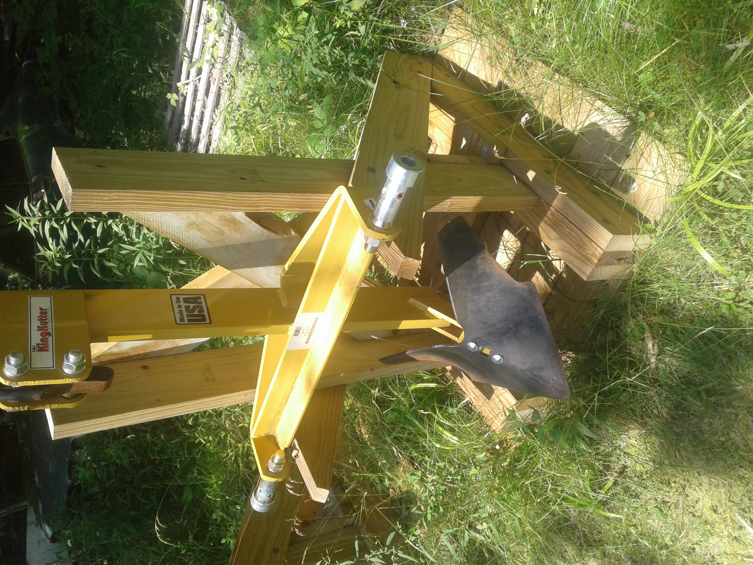

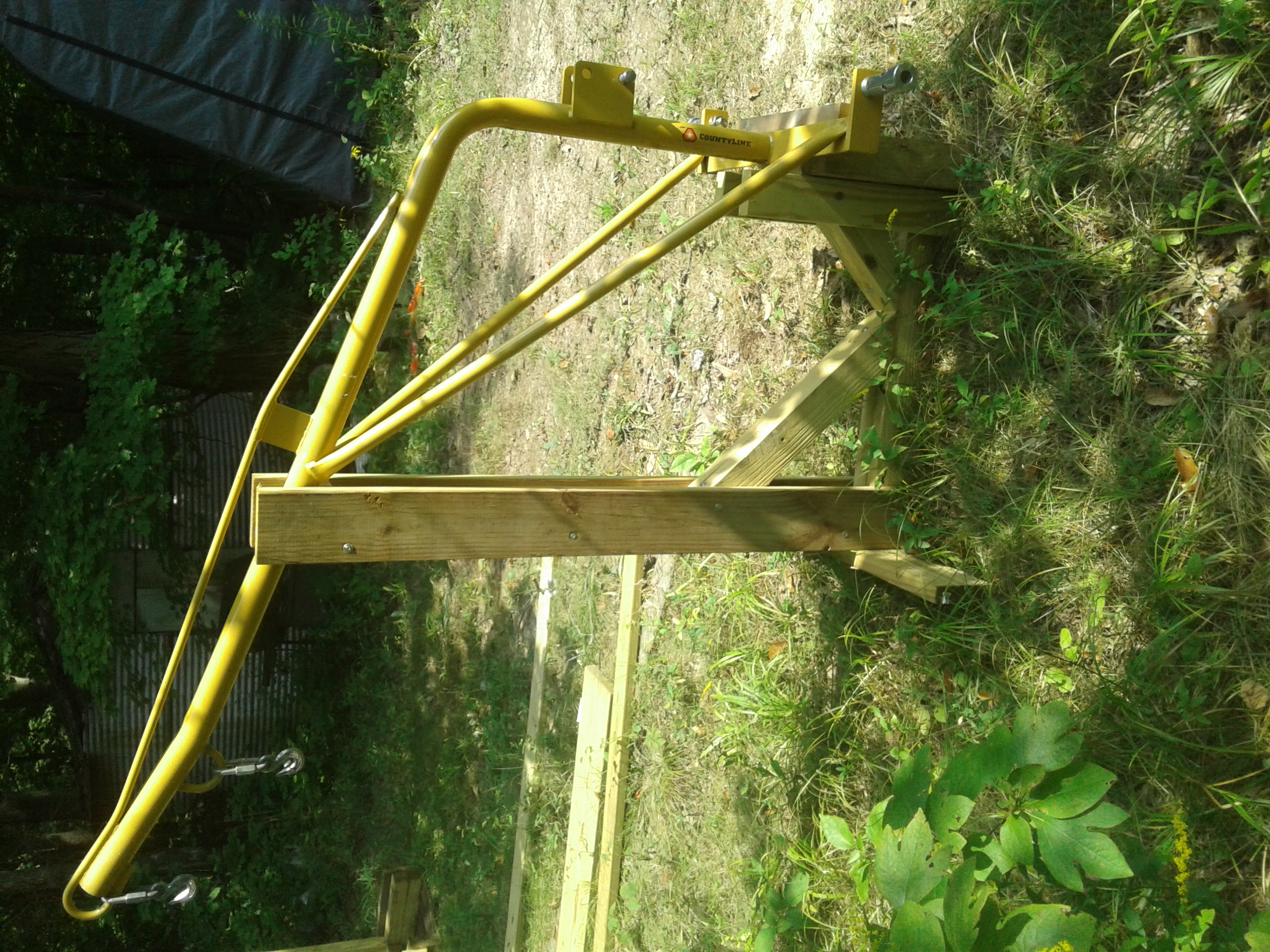

Yeah. I use a random chunk of firewood standing on end to support the scraper blade at the height where I can return and hook up. After raising the implement it falls over, and I drive away. That is the only implement that needs a support. Come to think of it that's one of two implements that the QH can't hook to, so the need for a support isn't QH-dependent at all.
/ Princess Auto 3-Point Quick Hitches #32
down and dirty parking stand, don't have to carry firewood around when you move it.
