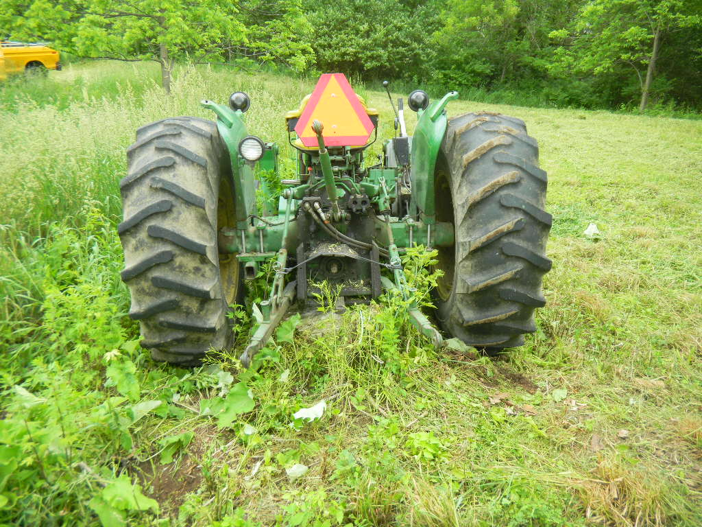

The horizonal exhaust hood is hard to find. Mine is in worse shape than yours.

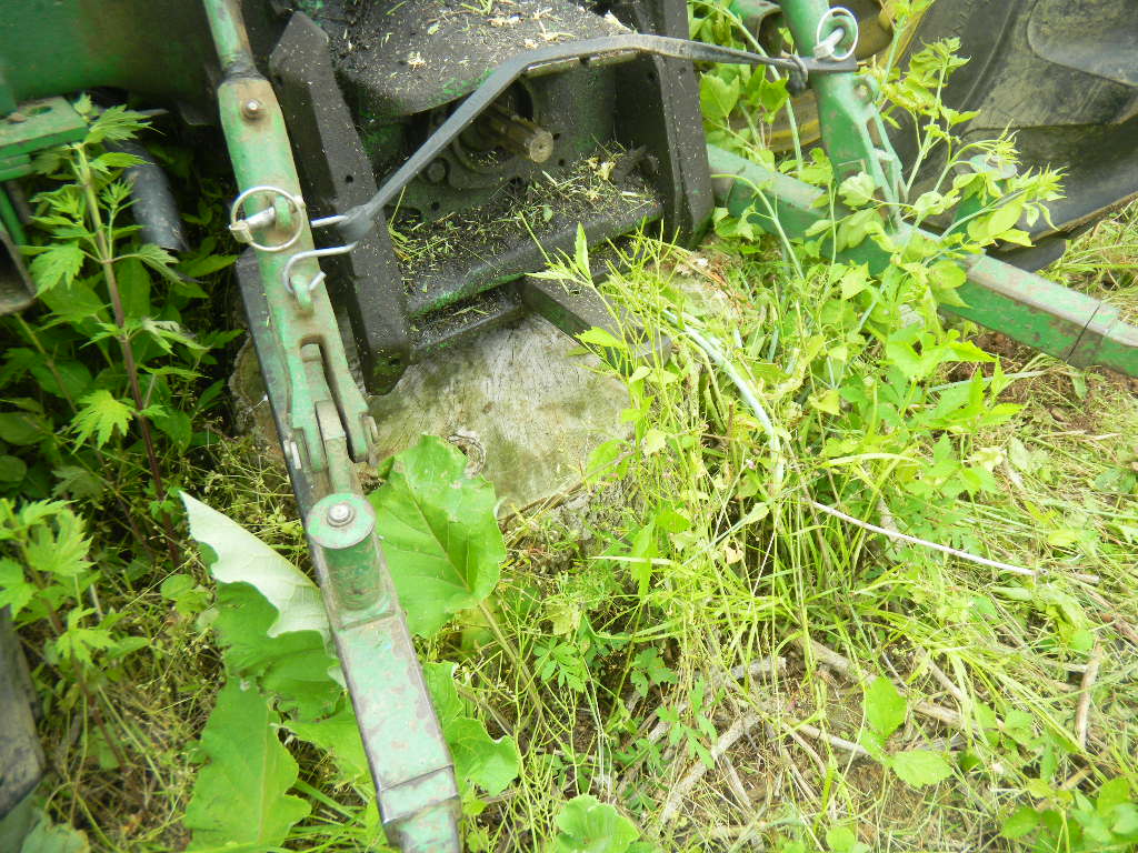

Second picture is tractor stuck, retrieval. There was stump hidden in the tall weeds. Everything cleared, but one of my sway bar stops. There was a hole to the right of the stump that the rear tire dropped into. I was glad the tractor got stuck, rather than the brush hog hitting the stump. Good thing I was going slow!
I used a chain and my truck to pull the brush cutter away. The chain broke trying to pull the tractor off the stump. I had to go home for the wood and floor jack.

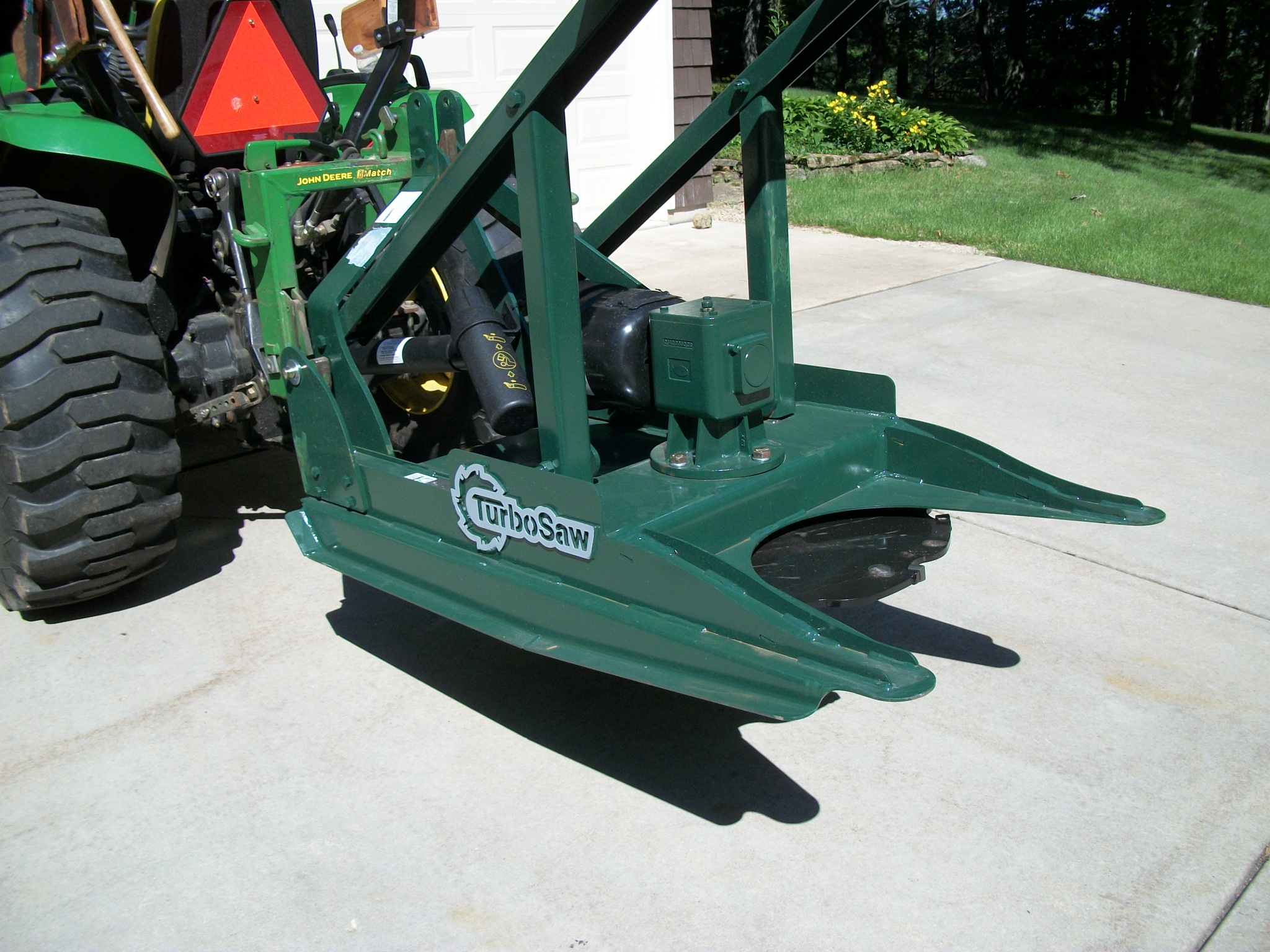

Why I enjoy having my TurboSaw for grinding the many, many stumps down low. This one will cut trees up to 12" and than grind the stump off just below ground level.
After having to leave many stumps over the years, now can mow over them even with the lawn tractor and mower.
Non-monetized link of first video attempt by a buddy. But was taking down one of many spruce trees to thin a planting of oak and spruce.

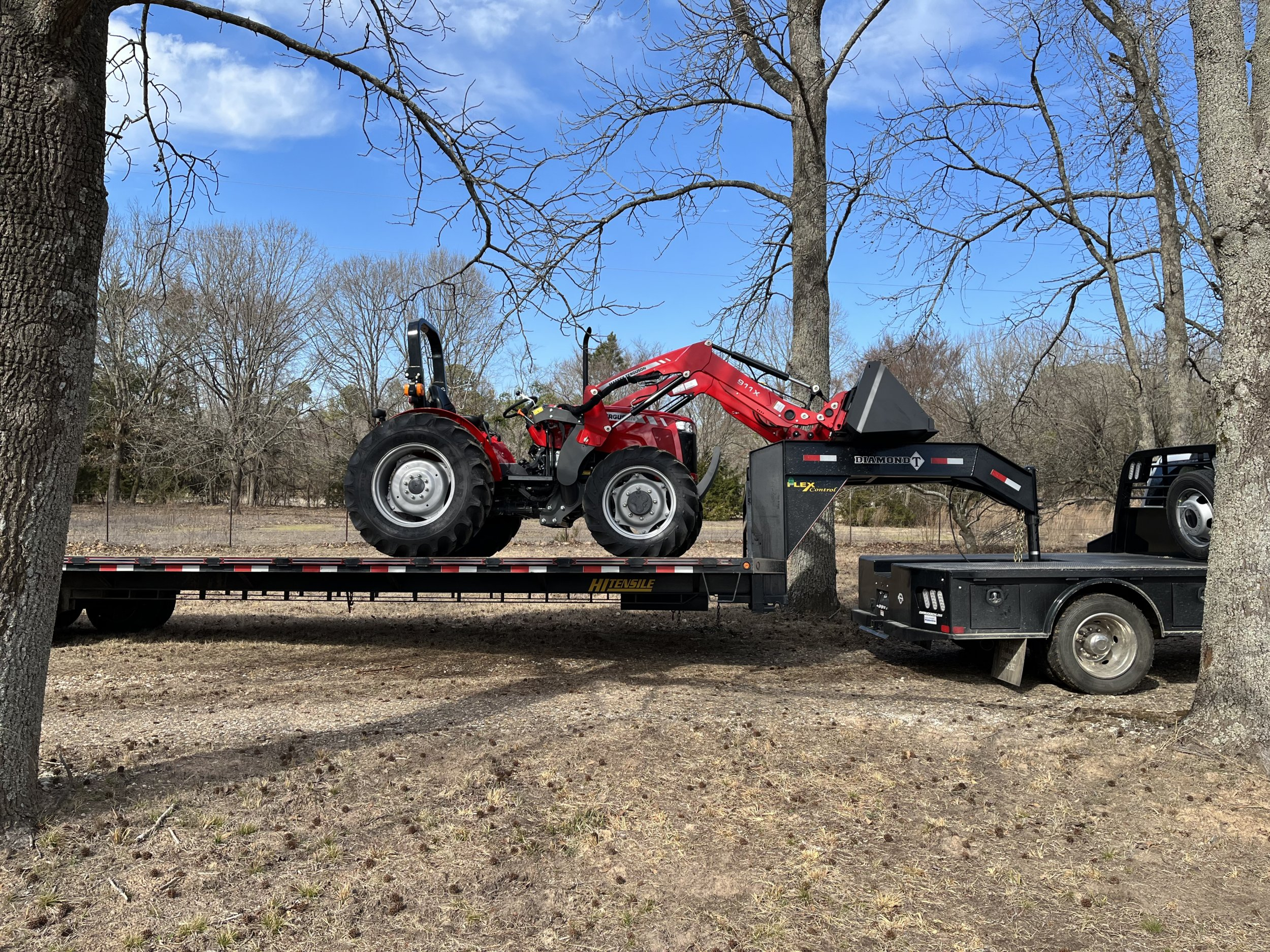

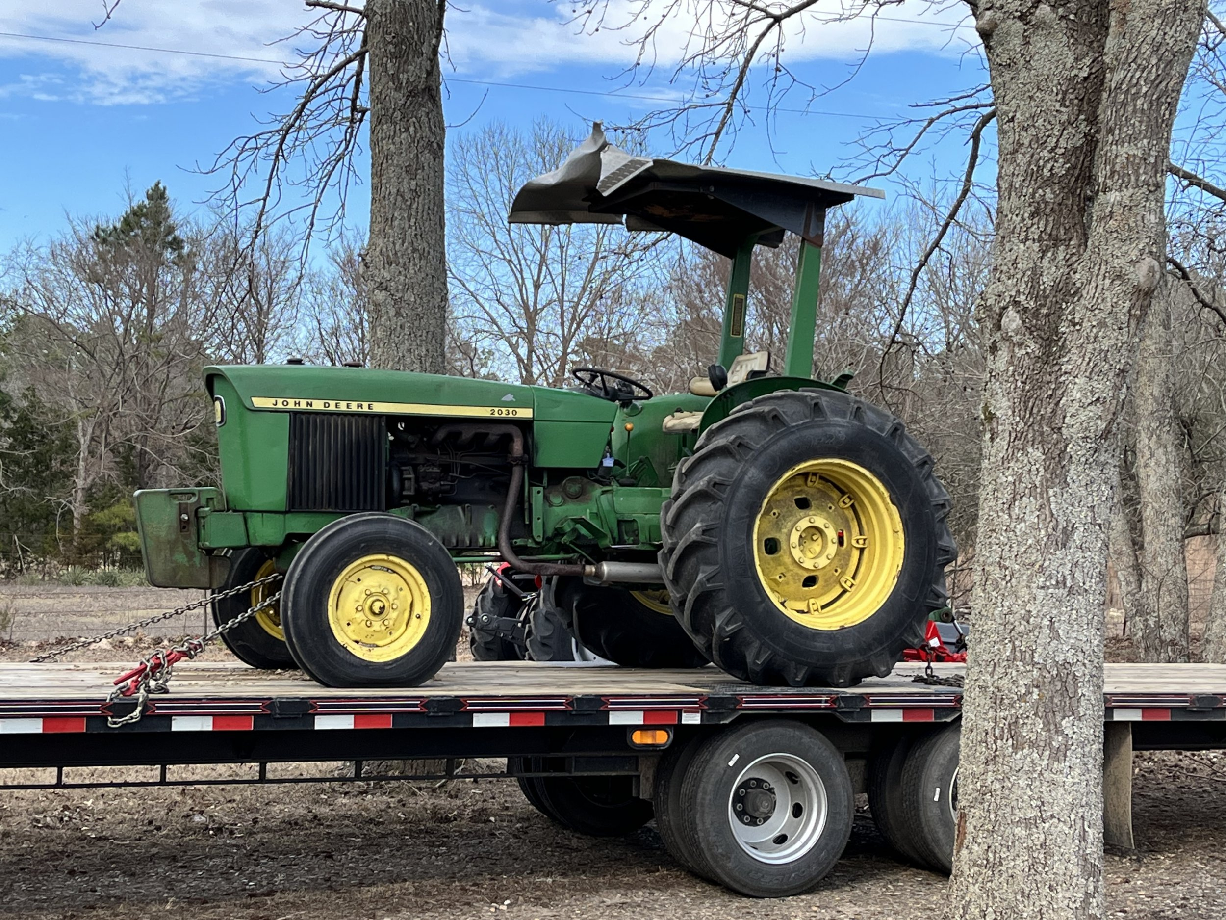

Well — I may need to change my handle up some. My 2030 went away today to be replaced with red paint
