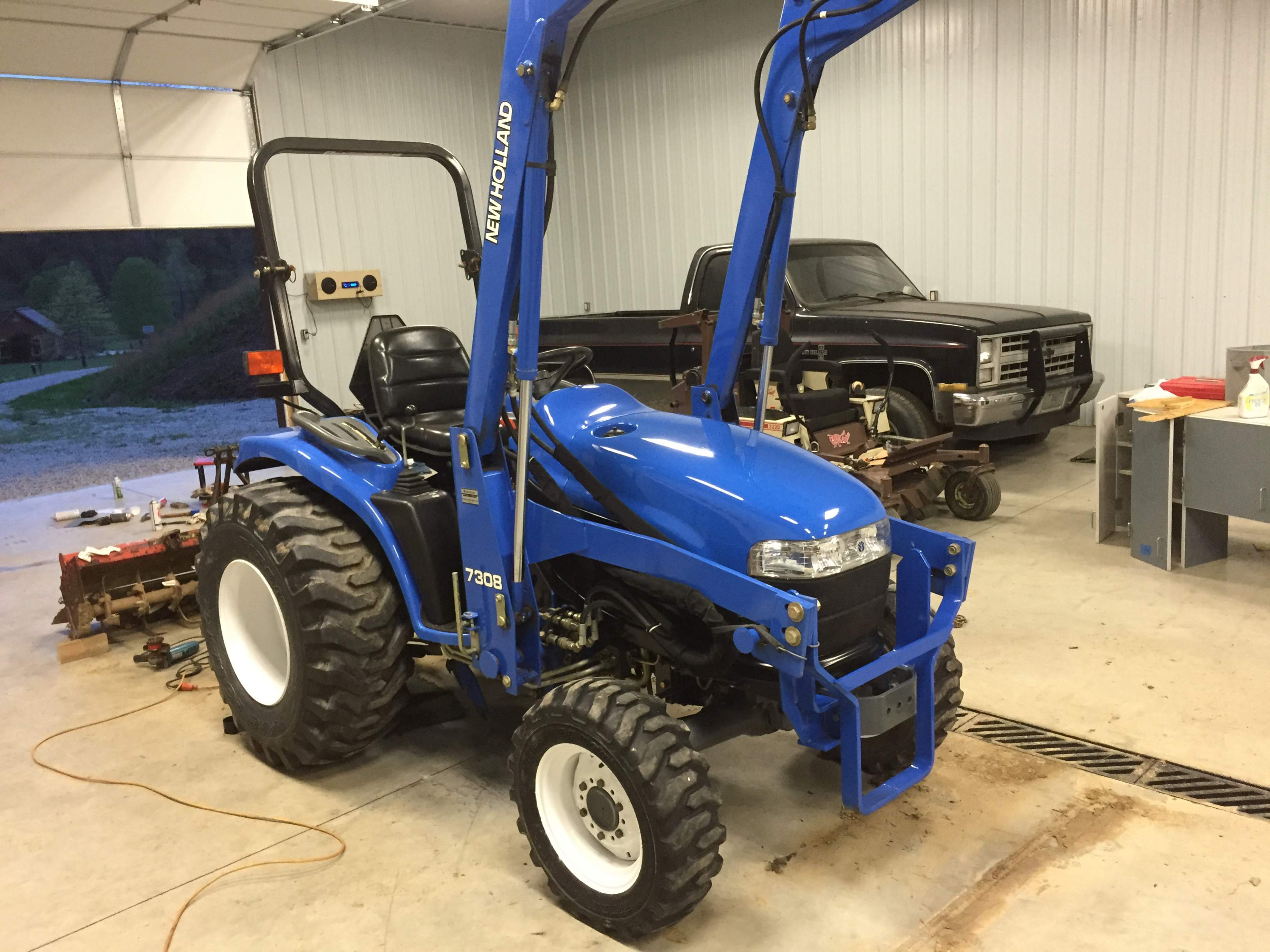

I currently own a New Holland TC33D. Great tractor. One of the best overall pieces of equipment I have ever owned. I bought it to mow and do some small gardening work. I own about 50 acres with a couple miles of dirt and gravel roads to maintain. I now have a Grasshopper ztr mower and no longer need the tractor to mow. I have a small dump truck and the TC33D doesn't have the reach to dump. I also need the stronger hydraulics. That's one of my main reasons for looking at the LS series.
I'll make someone a great deal on a TC33D with loader and 72" belly mower. 20150421_001826907_iOS.jpg
