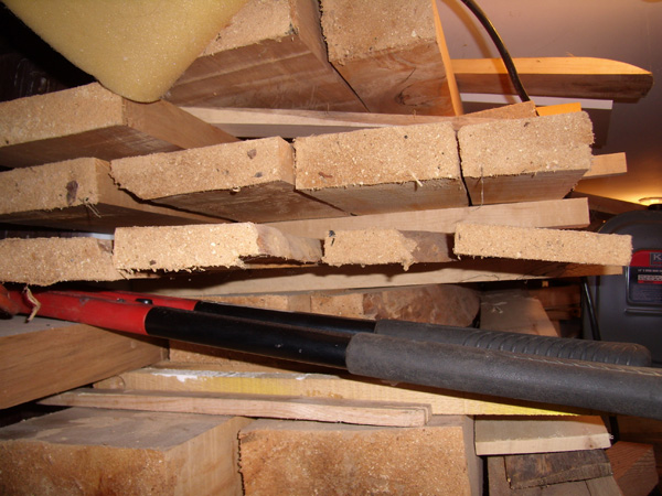

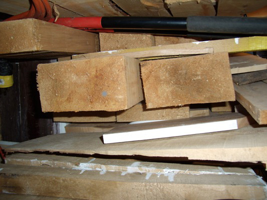

glue (yellow or white),
That is the type of glue I use.
Picture shows end piece of wood with glue and then dipped in sawdust.:D

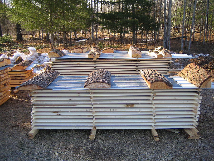

I've used glue before for small turning projects, but I've never heard of adding the sawdust. What is the purpose of the sawdust? What kind of wood do you have stacked in the photo? Do you trim the ends off, or just plane and saw with the glue on?
I cut some nice size white pine here. I actually sealed it with Anchor Seal, but pine doesn't need that at all for even drying. The AS doesn't show well in the photo of the log, thin coats dry clear to milky.
- Marty
