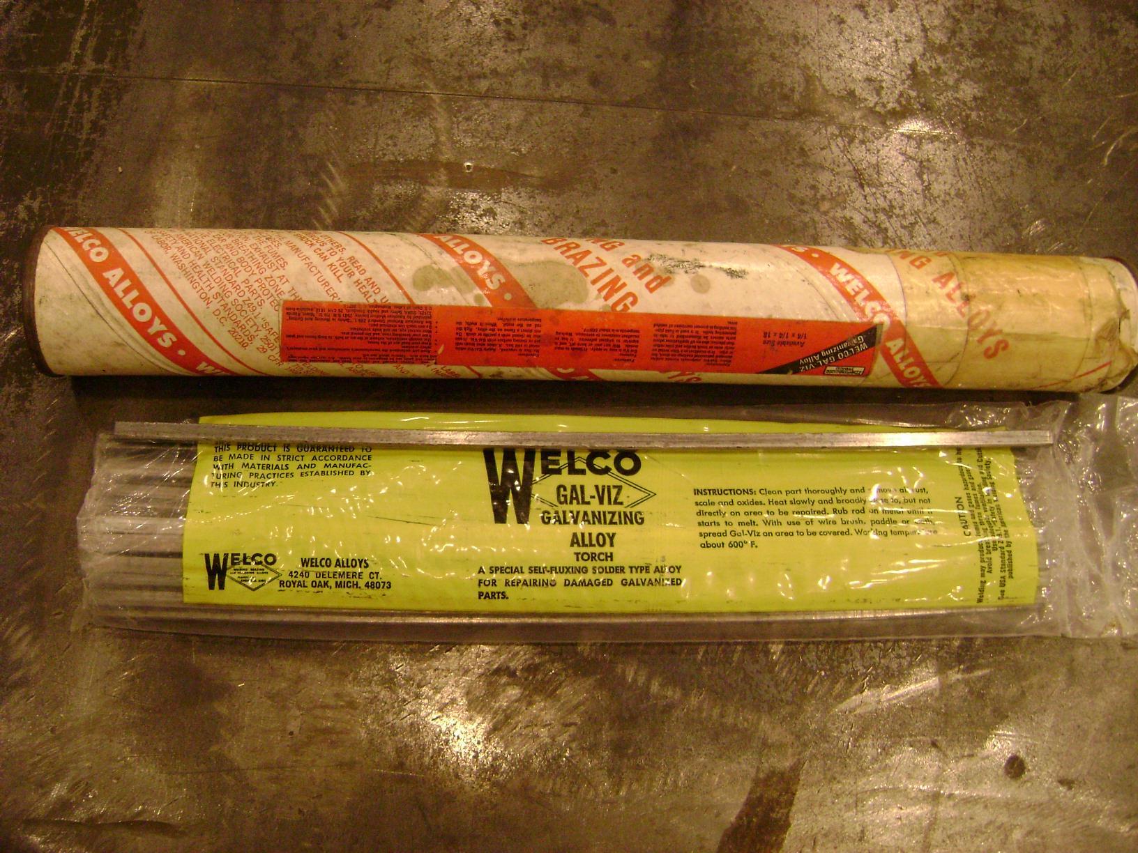

I need to do some minor welding on a galvanized tube fence gate. Yes I am aware of the issues welding galvanized metal. So what is the best way to keep things from rusting once I burn off the galvanizing where I welded it? I would prefer not to paint since that would mean needing to paint the whole gate for esthetics. If I must I will but is there anything else?

This is the best stuff I have ever used on galvanized material. Apply with a torch, and wire brush in. Acts a lot like solder.
Very pricey tho!

You can get the sticks of zinc like Shield Arc showed or there's a spray on zinc galvanizing by Crown which does a very good job. Most aren't worth what you pay for them, but the Crown brand does a good job.

I'm not familiar with the White Knight product. The Rustolium is easier to find as Skyco said and is pretty good. I still think that Crown is about the best there is though outside of using a zinc stick applied with heat.
