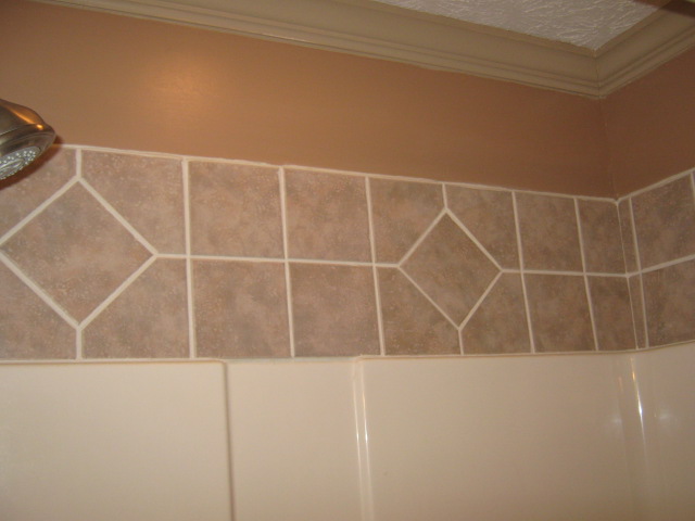

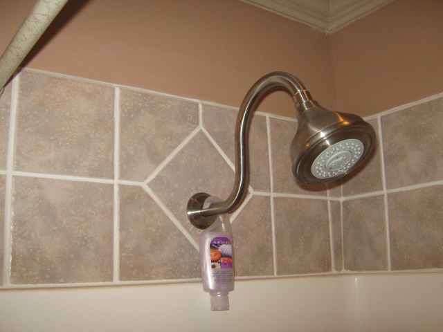

To be honest with you once its started its a pain to get rid of and not have it keep coming back, I do bathroom and kitchen remodels and I remember one time a home owner had this same problem on and on , would kill it out for a few month but it would come back, I looked outside the bathroom window and notice a large oak tree within 8 ft of the house with Moss growing on the side facing the window, I asked her does she ever open the window? her reply was yes all the time in the spring of the year, I said to her there's you're problem, The spores from that moss is getting into the bathroom, she said Wow! never thought of that before and that they been thinking of having the tree removed anyway, I was back there a year later after they had removed the tree, she said the mildew never has returned,
I think you should tear out the sheetrock that surrounds the tub inclosure mix spray of bleach/clorox and sray everthing down let it dry , and install either durarock or green board, then tile the above part of the shower/tub and use tile grout sealer you'll be good to go, I can see everyone now looking out their bathroom window,, :D
View attachment 287999View attachment 288000
I think this is a good approach to the problem. I went ahead and put tile in our shower area above the side walls and it has been over three years with mode free bathroom. I did the clean up and removed the mode before adding the tile. I agree with the green board too, although tyhat is a bit more work to get the project completed.
