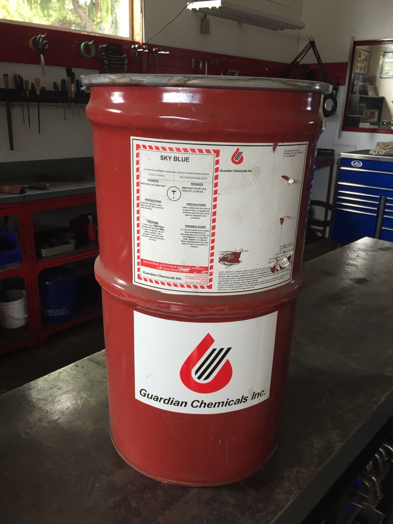

I have good success running Sky Blue through my hot water pressure washer. It's excellent also for leaving a "paint ready" surface for my tractors.
http://www.guardianchem.ca/portals/0/banners/product-list.jpg?ver=2015-08-31-151417-857
