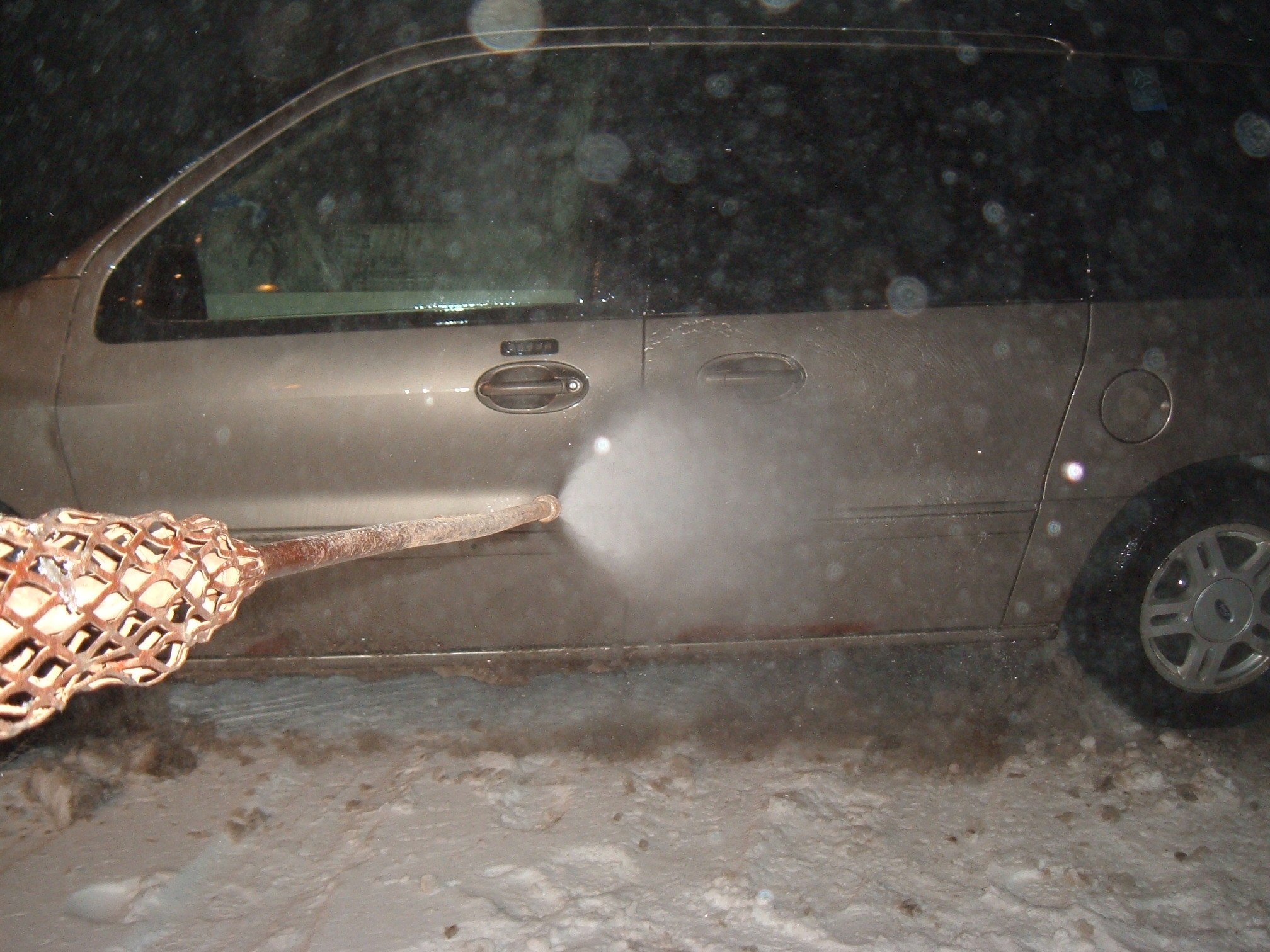

I am interested in using my pressure washer this winter. I usually winterize it.
Here in NJ my attached garage gets in the mid 30s often.
Has anyone built something to keep their pressure washer heated, instead of heating the entire garage?

I’d be more concerned about the water/spray freezing up where it was used, like in the driveway.
