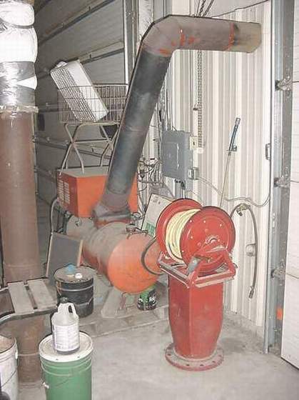

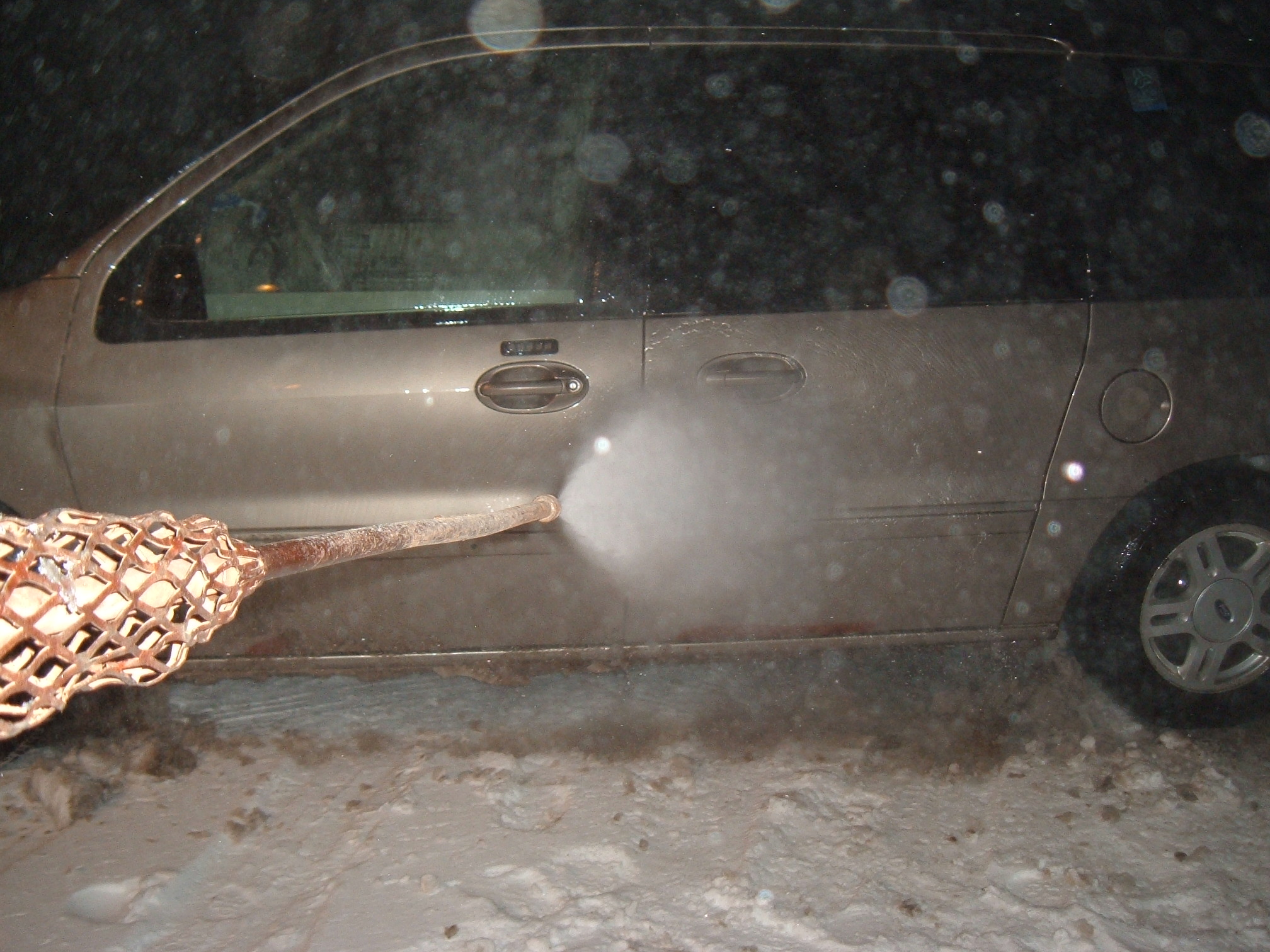

You can also use a bucket to purge anti freeze thru it. Suck it till it starts to *** green, turn off then hook it back to water and run the green back to the bucket till it is starting to get water. But nothing beats a little heat and to tell the truth you are doing yourself a disservice if its insulated not to heat the garage to low level if its modest. It doesnt have to blaze but 40 or 45 is so much better than freezing and doesnt take much.
It will bump up fast from there and might even be inclined to hook it to hot water circuit for winter.
Depending on where you live, the service of your vehicles even an expensive washer may be well worth it in depreciation gains, ease of maintenance. I wash a car bout every day, I wash outside but I can make 5 gpm at 200 degrees, will cut ice and snow right off and dont got to bring it all in. Got mine plumbed thru the wall, outside switching. Hot in 30 seconds.
