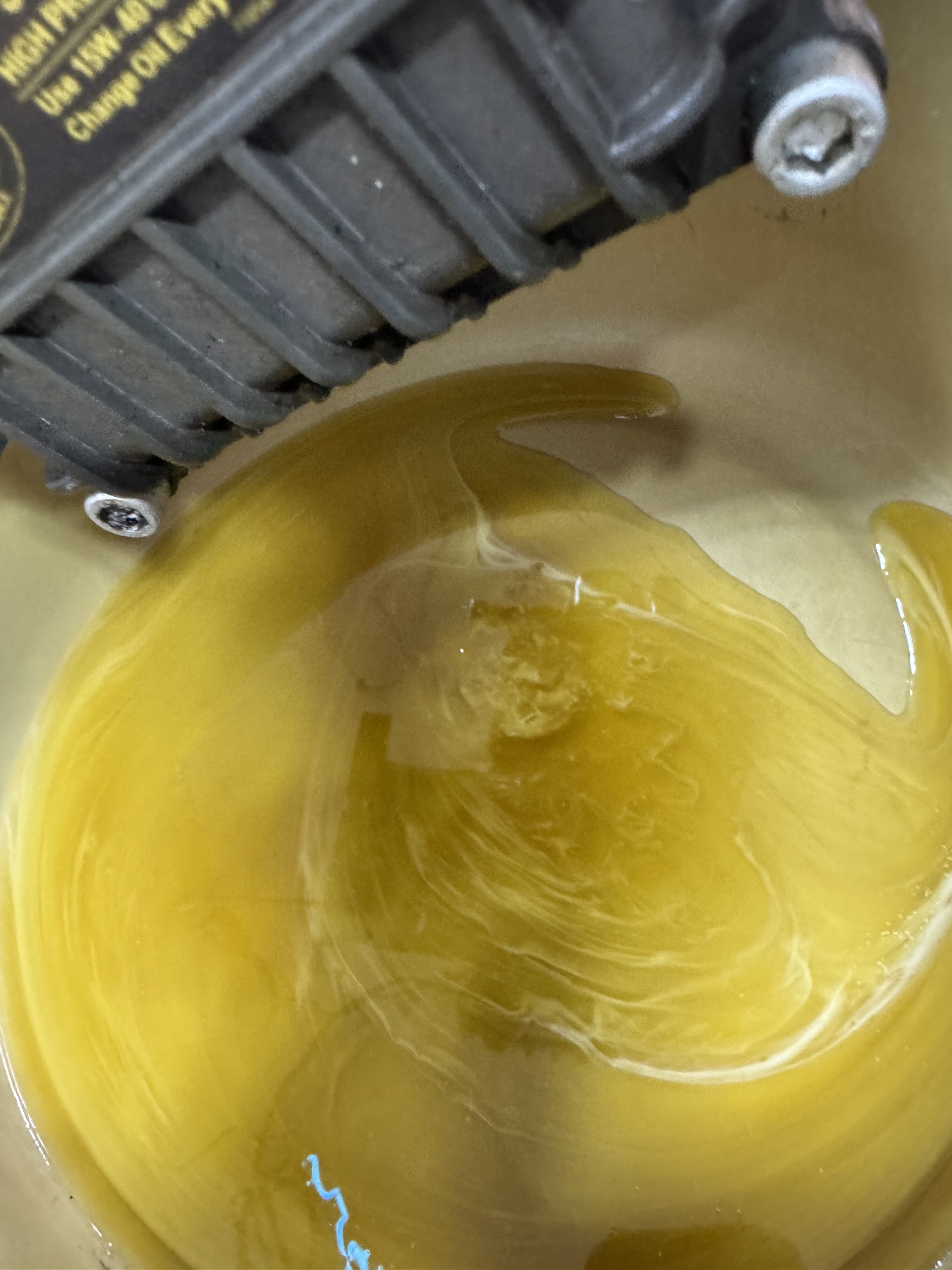

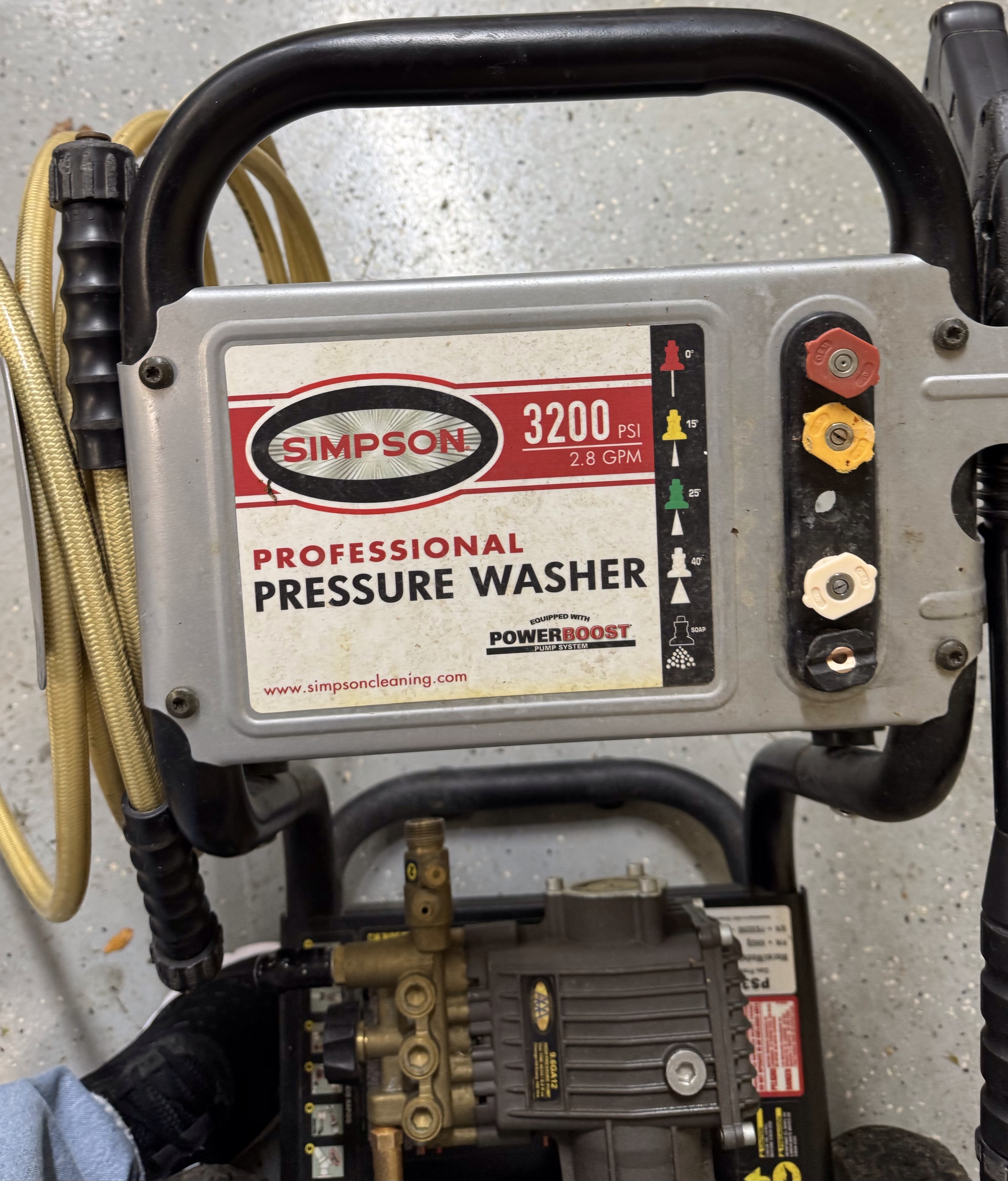

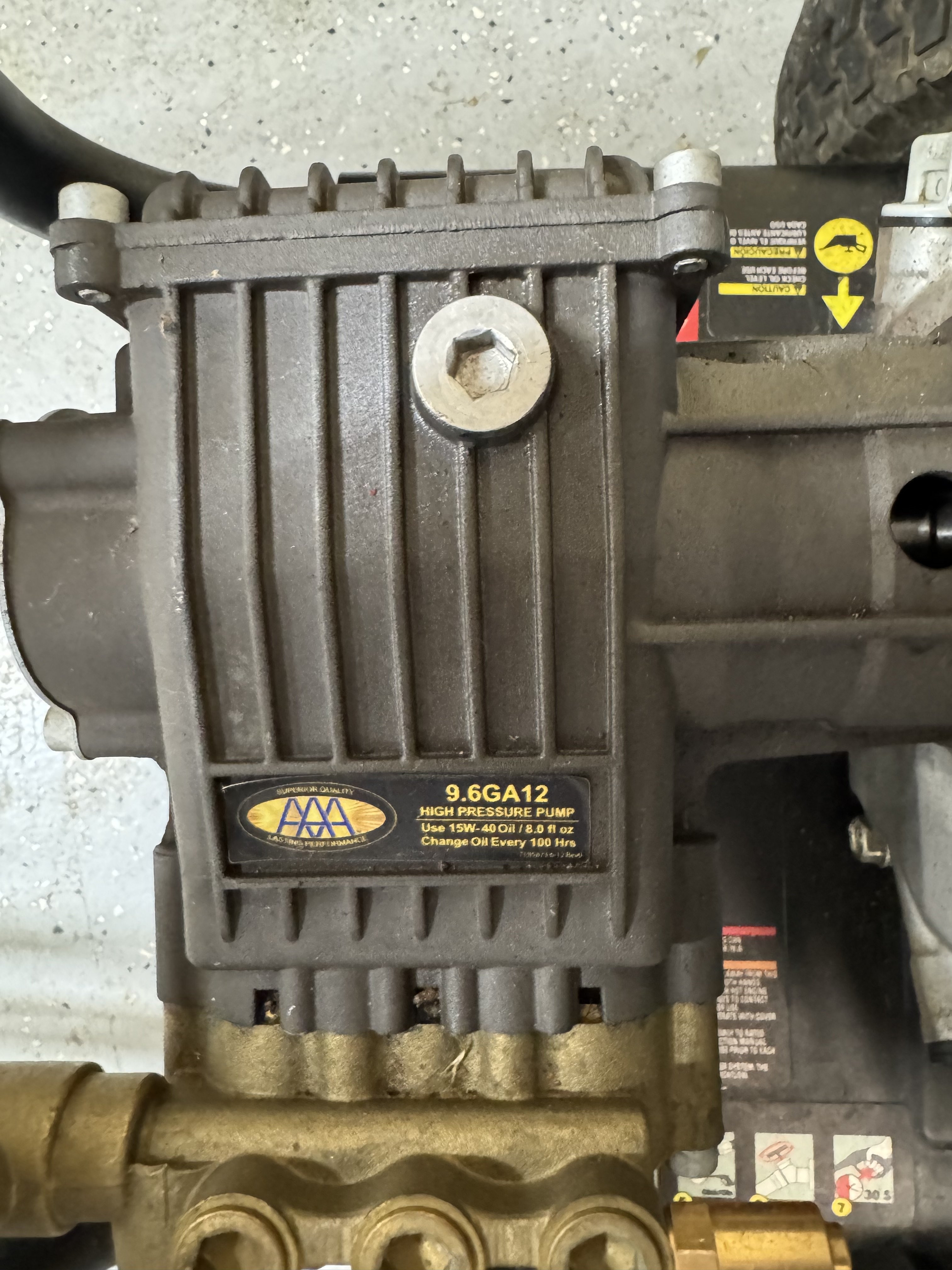

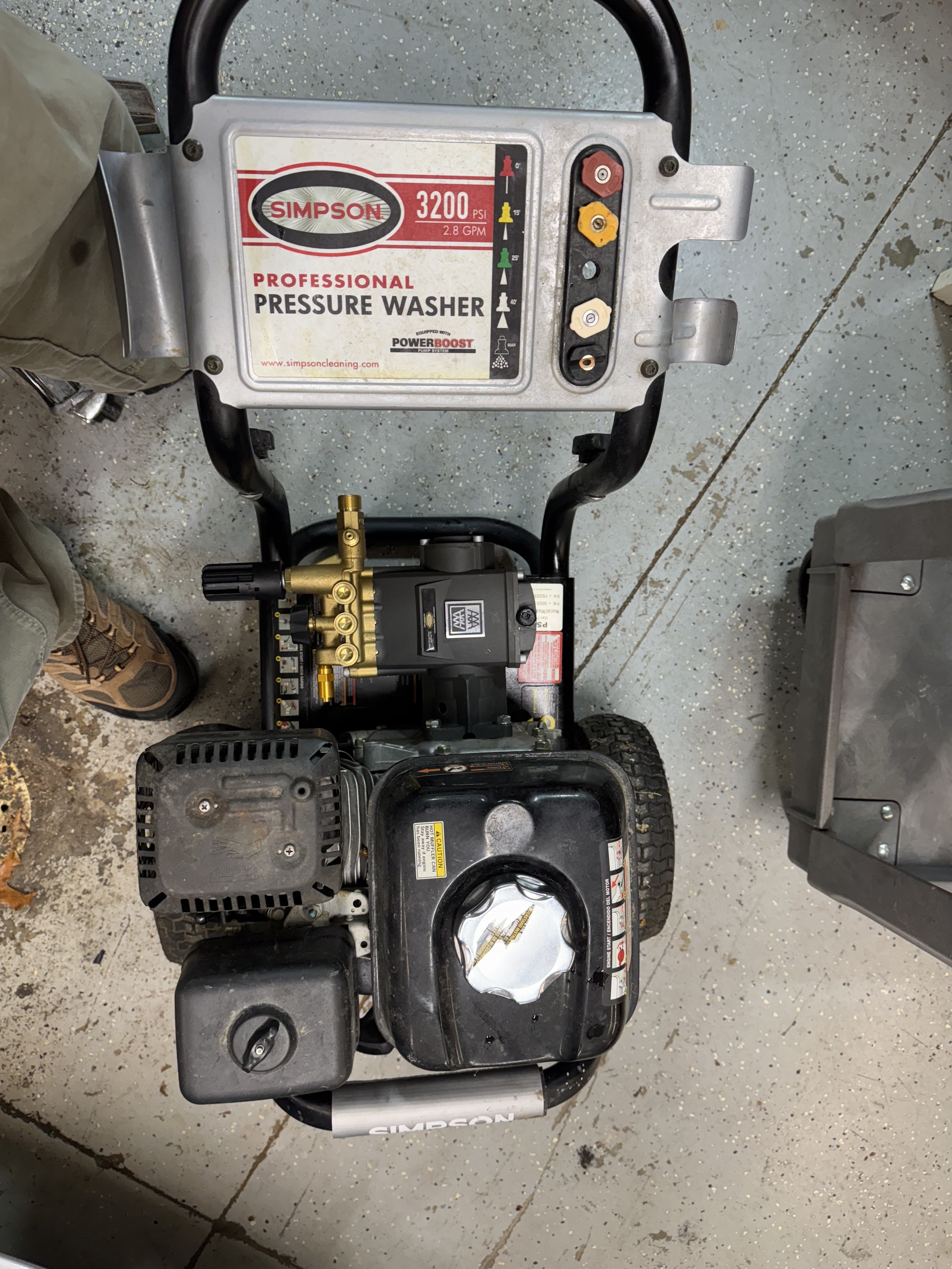

I have a Simpson pressure washer and a couple of months ago I changed the oil in the pump and it had water contamination. I used it a couple of times changed it again and milky again. I used it a couple of more times and it looked OK through the sight glass. Two days ago I was using it and I noticed steam coming out the relief valve and noticed warm water coming out the wand.
Is this worth trying to fix, it has a Honda GX engine? Is it worth trying to rebuild the pump? A new pump is about $225 if I get one like it.

If a pressure washer pump is allowed to run without water outflow the unloader bypass water will cause the pump to heat up. The thermal relief valve opens around 190 psi and will start dribbling water to help keep the pump from overheating. Then would you pull the trigger that hot water comes out the nozzle. Totally normal.

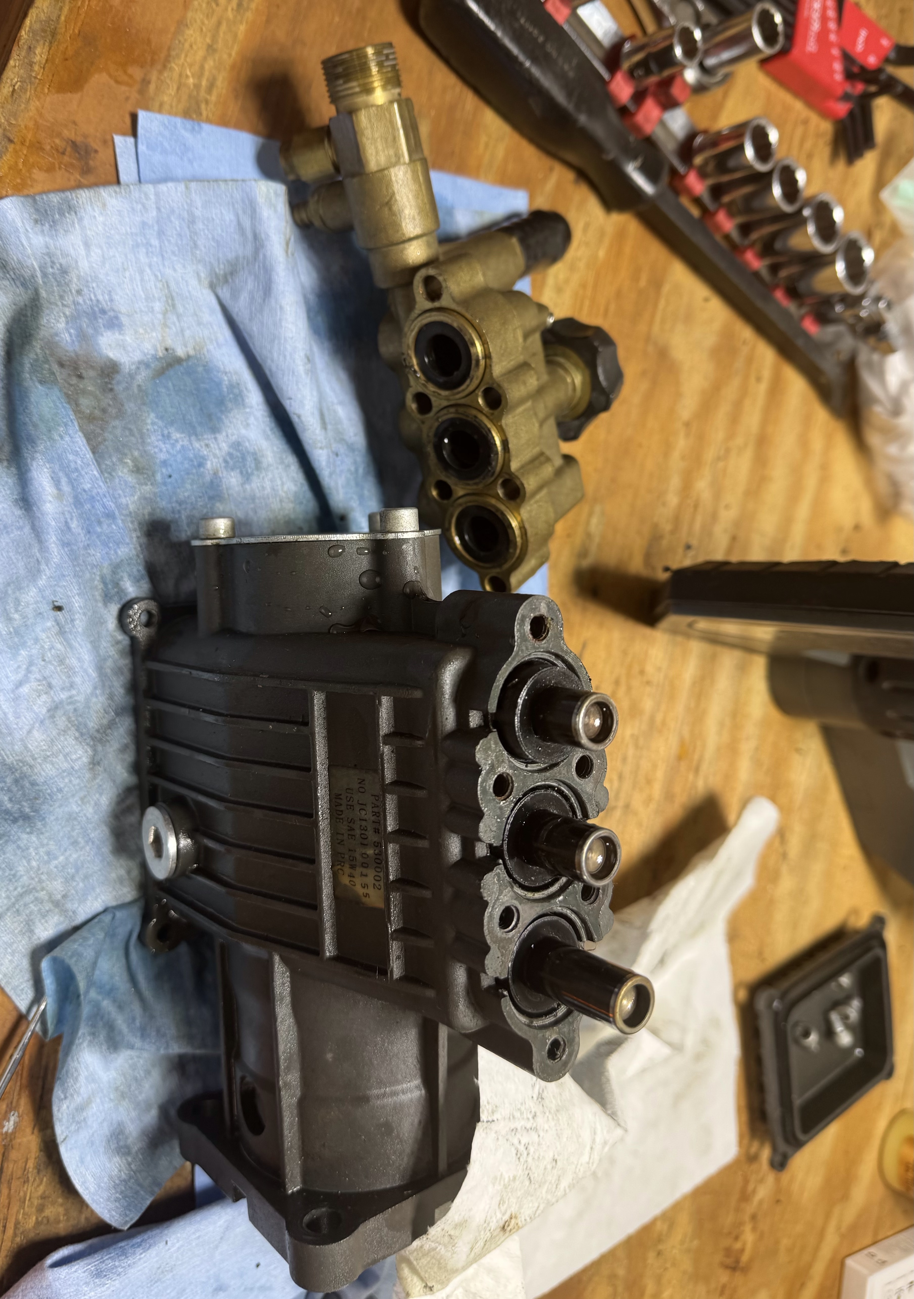

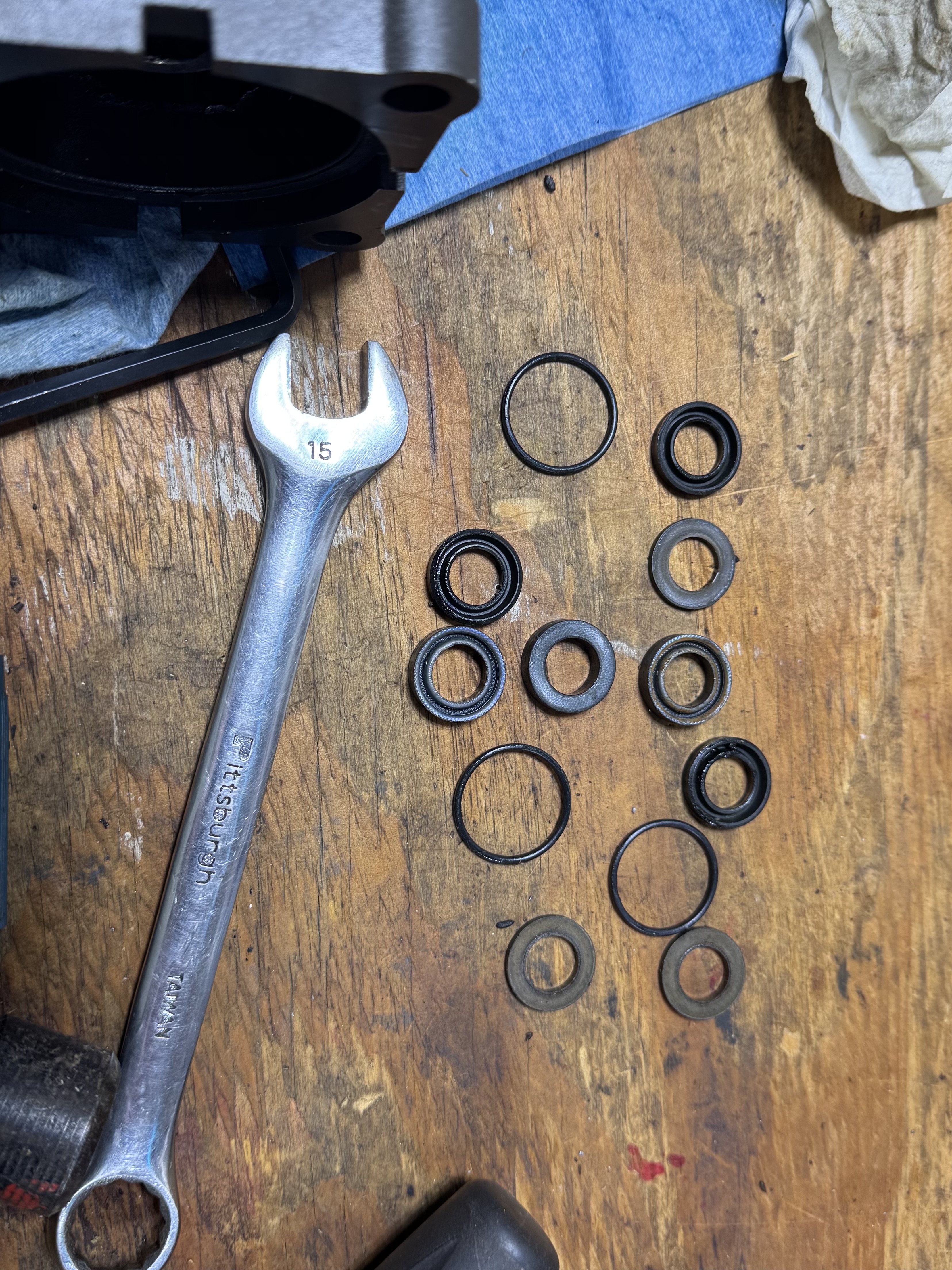

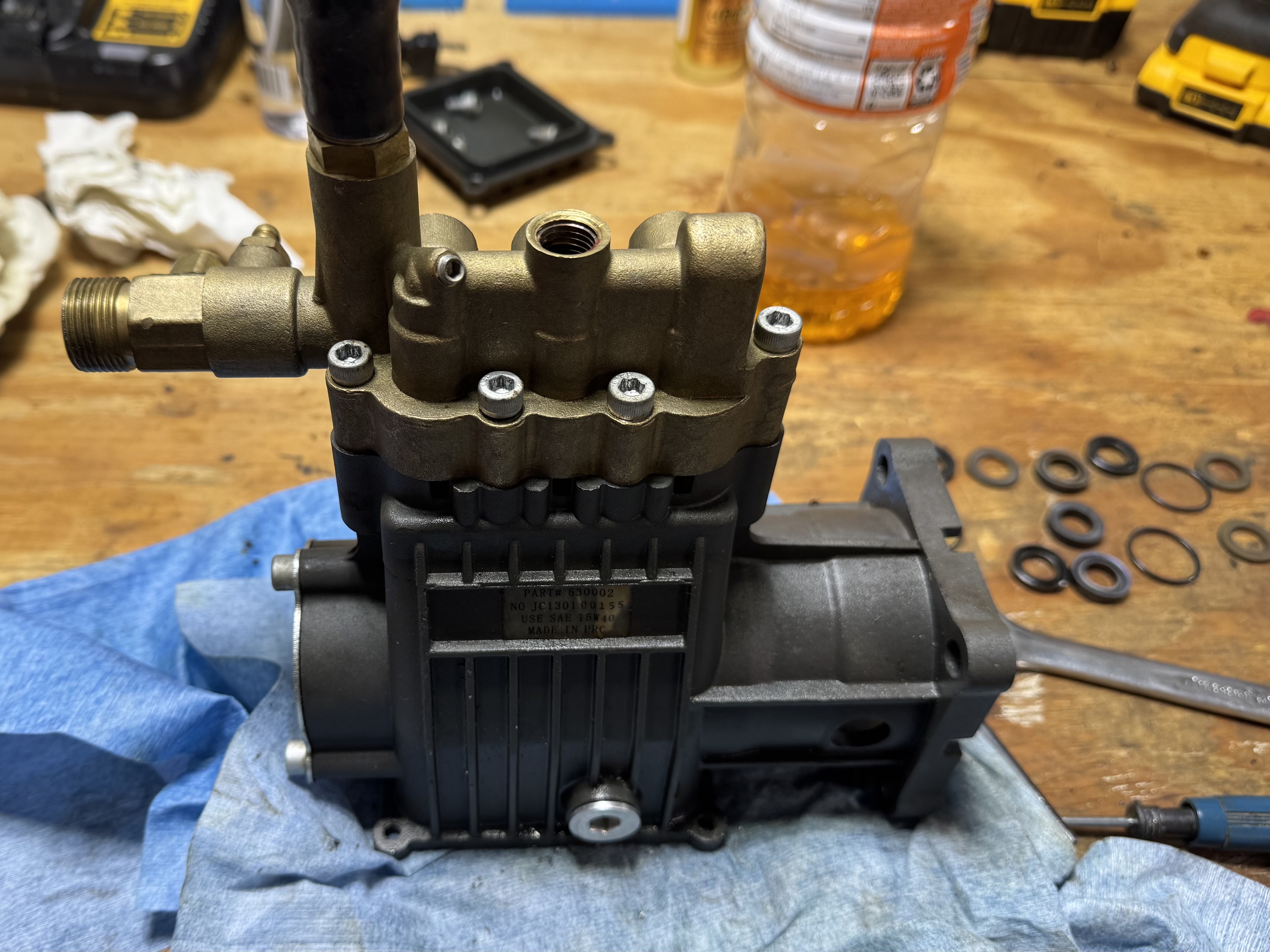

I got a seal kit for it and luckily found a YouTube video where he installed seals in a pump like mine. Took about and hour to do it. A picture of the old seals and the pump mostly put back together.
/ Pressure washer pump rebuildable?
#12
It was a failure, I’m still getting water into the pump oil. When I watched the YouTube video where they showed how to rebuild them he was negative on these pumps. He said they are meant to be replaced instead of rebuilt. It does work and makes more pressure but running it just a few minutes put quite a bit of water into the oil. I’ll get a new pump for it.

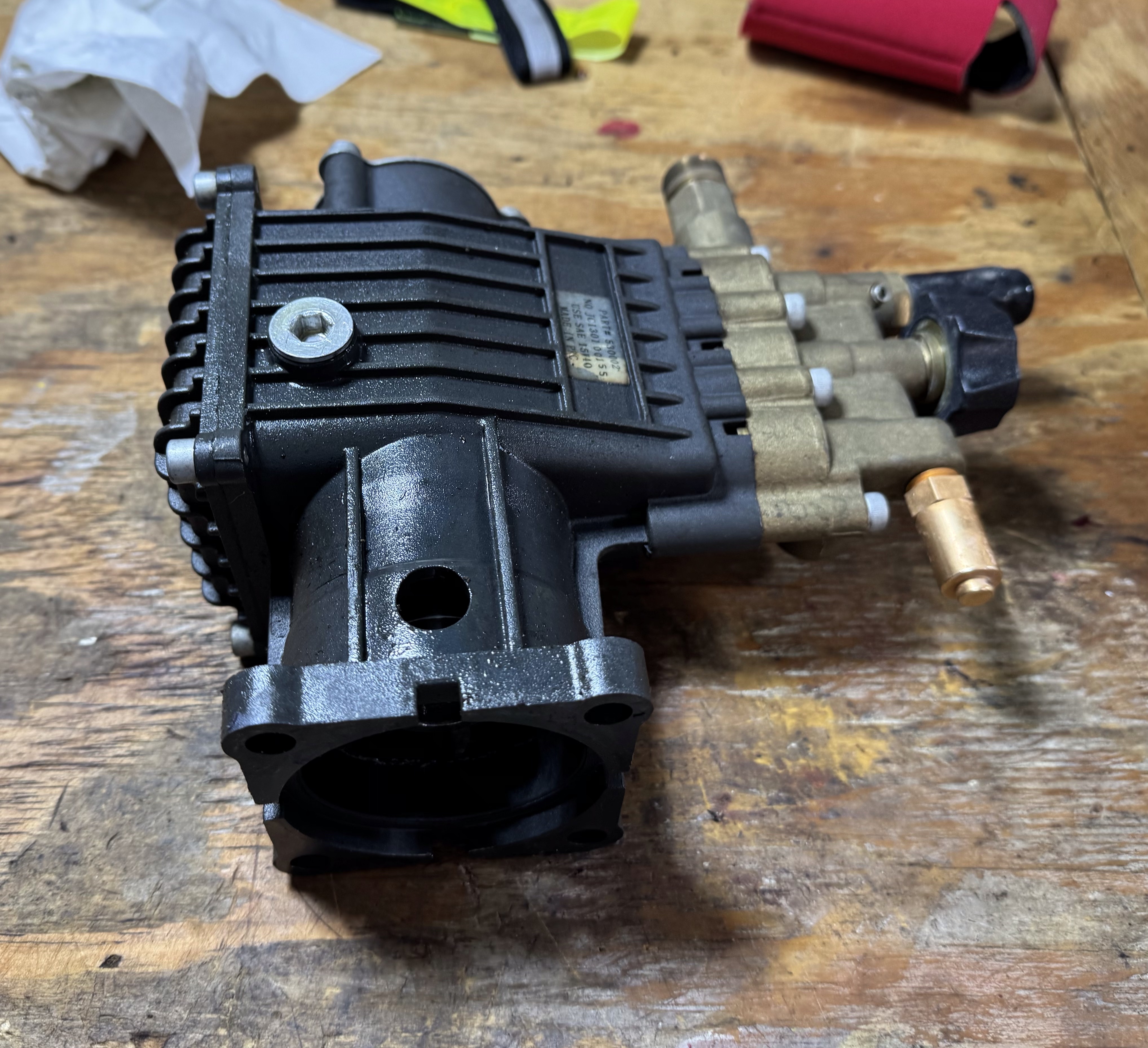

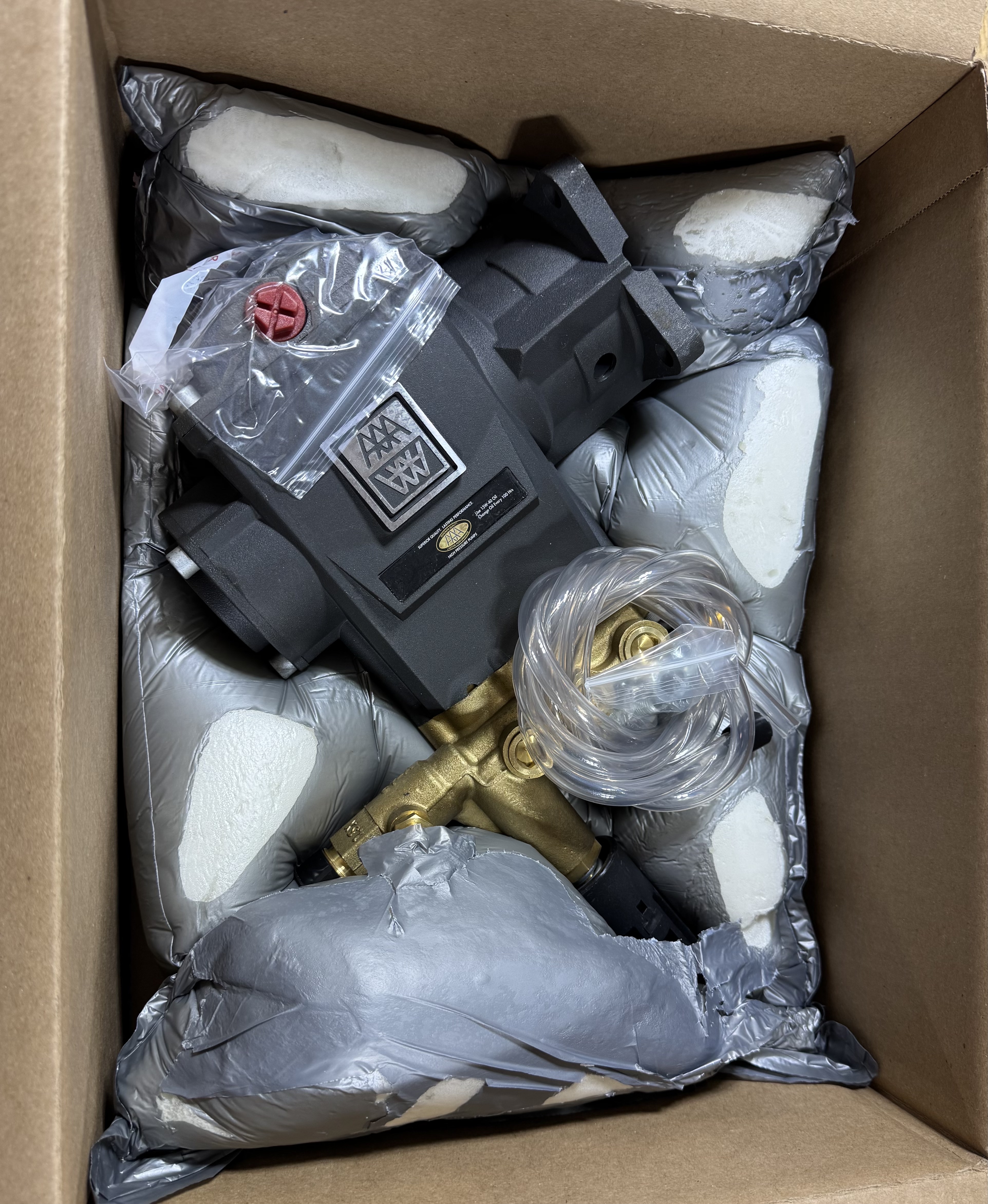

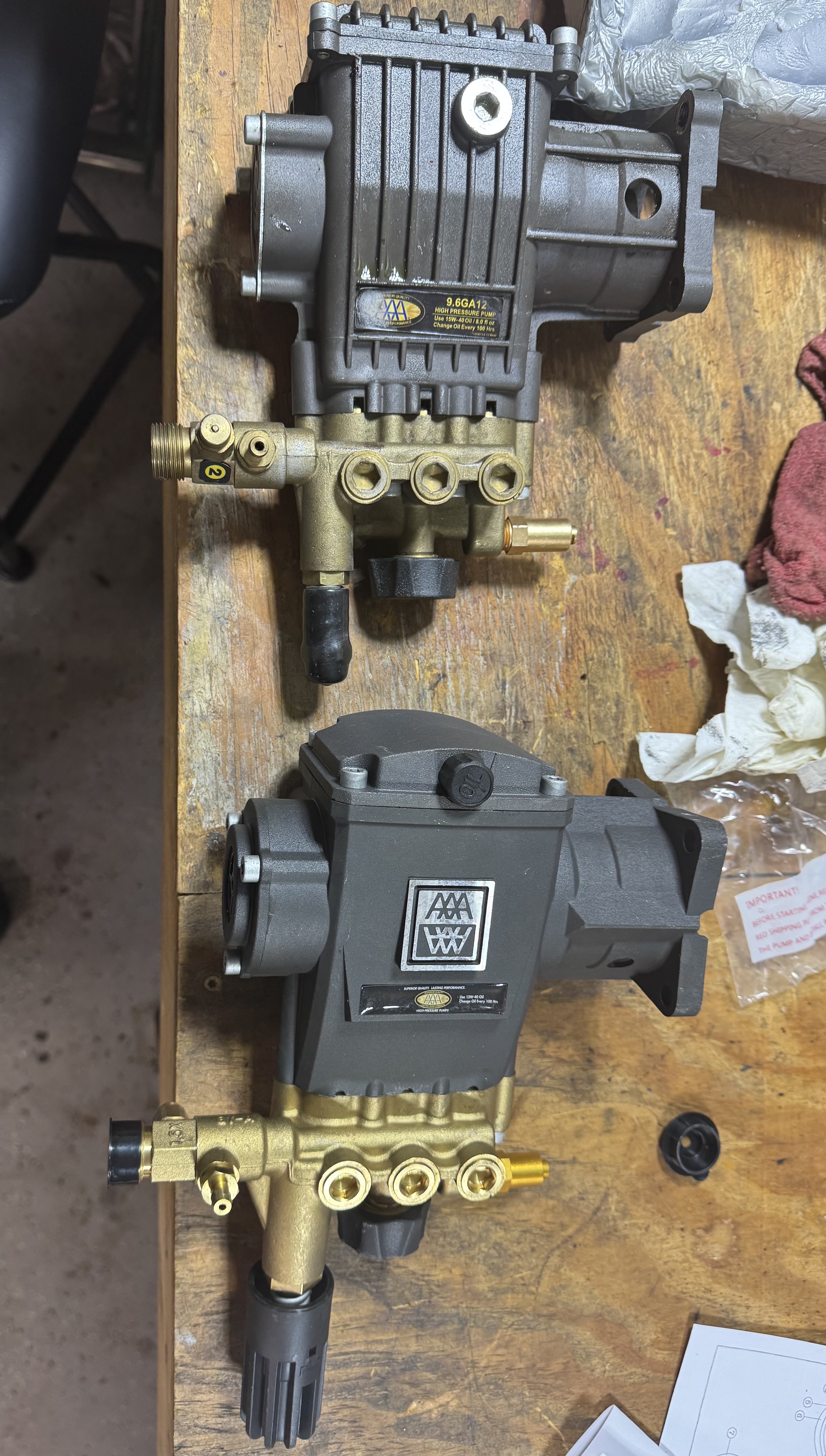

I’ll resurrect this again, I got a new pump last week and installed it today. A little over $300. It’s too cold and snowy to try it but it should be as good as new.
