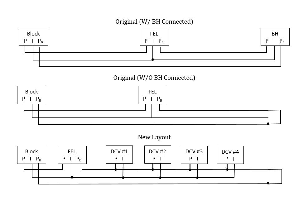

I started following this thread because I am having an issue with my Mahindra 3016 Shuttle. I have a FEL and a BH and both of them work completely fine. However, I fabricated a 4 spool remote assembly to completely control the 3pt hitch and that connects to the BH remote QC. Everything works great except until a load is place on the cylinders. I went ahead and hooked a 5K gauge into several points within my new circuit and am only reading about 300-400 psi even at PTO rpm. For the sake of expediency, here are some answers to questions that I presume you would ask:
The FEL and 3pt hitch function the same as ever.
The pressure read when the FEL functions are engaged drops to a point where it does not register
The pressure read when the 3pt hitch is engaged surges up to 2000-2200 psi
Each of the new remotes is controlled by Northman Power Solenoid Directional Control Valves
The solenoids are the closed center type
Any thoughts, advice, or help is greatly appreciated.

One thing leaped out at me and that is, that your tractor is open center hyd system.
Why are you using CC valves.
You should be using open center valves.
3016 4WD Shuttle | Mahindra
As far as reading pressure, it depends where i th eflow path yu put the gage.
If you plug the gage into the 3pt or remotes, and use the loader, the loader will use all the fluid and nothing downstream.

Thanks for the quick reply.
I chose CC valves because my thoughts were that I was simply adding four valves, in parallel, into the interconnection between the P and PB that needed to be maintained when I took the BH off. Seeing as how there should always be flow through that part of the circuit between the P an PB, I didn't think that the CC would be a problem.
As far as where I was inserting the gauge to get the reading, I put the gauge on a tee right after the QC fitting and before the first DCV. If you need a more detailed schematic please let me know.

A CC valves blocks the hyd flow and causes the fluid to pass through a relief valve upstream as most solenoid valves no not have relief valve.
An open center hyd system uses a gear pump to pump fluid and the fluid is always moving.
How long has the valves been installed?
If you need solenoid valves for remotes, then select the open center valves.
If you want to read the pressure for any part of the system, install the gage in a tee in the IN port of the first valve. Then anytime you use a valve, the gage will reflect the pressure developed by that circuit.
However as in the other post about relief valve, the lowest valve relief setting will limit the pressure.
If you remove those CC valves and connect the PB hose from the FEL to the 3pt, you should be back to normal operation.
How long have you had those valves? Maybe Northern will exchange them for you.

Thanks for the verbal wrist slap and the input. To answer the question JJ, Northern Tool did not ask what I was hooking up. If you have a moment; take a look at these one line schematics which pretty much depict both the layout as well as the train of thought that went into this.
I chose to go with CC valves because I was under the impression that I would not be truly dead heading any the legs of the circuits as I was providing a continuous path for the pressure being routed through the PB.
If I need to swap out to OC valves will I have to re-plumb the subplates in series or can I keep them in parallel as they are plumbed now?

In OC hyd circuits, the flow is in series from pump to tank.
So with all OC valves, the pressure line is the input, and the PB passes fluid to the next valve IN port.
With a three gang subplate, the ports are connected internally, so that on the basic subplate, you have one IN port, a tank port, and work ports for each valve. The pass through fluid for the subplate is through the tank port.
You could call the tank port the PB if you want as it has a 3000 psi + rati
The subplate tank port does not go to reservoir unless it is the last valve in the hyd circuit.
Your hyd circuit should look something like this.
Pump to FEL, PB out to subplate IN port, subplate tank port to 3pt IN port.
If you want a relief valve for the subplate, they do make them with a relief port.
The relief for the solenoid valves is upstream, the lowest setting relief valve in the series flow path.
I recommend sending your CC valves back and exchanging for OC and OC subplates.
