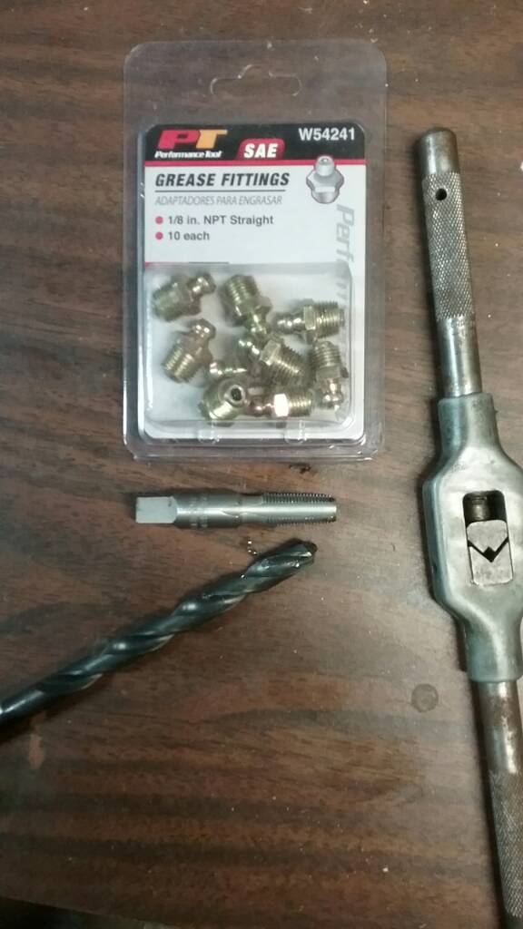

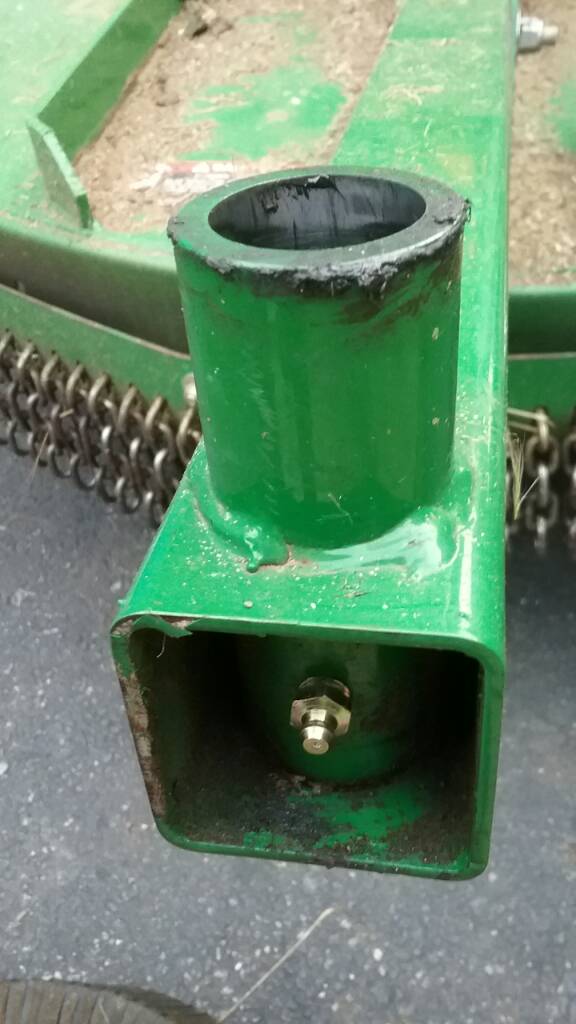

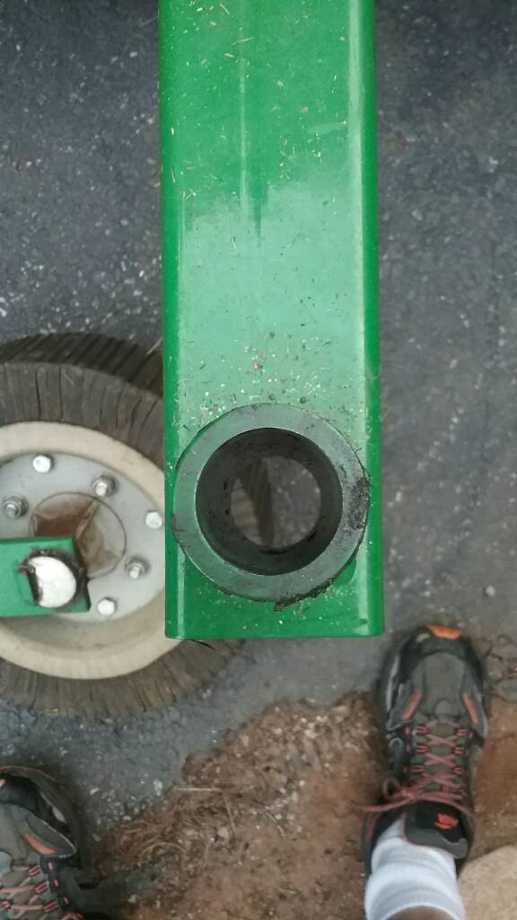

Back to grease fittings, I fixed it. I used 1/8" NPT fitting so had to drill quite larger. Cleaned after blowing out. Pipe thread so tapered fit, it took a lot of pressure with 7/16" socket installing it, it was just up to inside so worked great. Won't come out now. 20200916_184505.jpg20200916_184539.jpg20200916_184554.jpg

Back to grease fittings, I fixed it. I used 1/8" NPT fitting so had to drill quite larger. Cleaned after blowing out. Pipe thread so tapered fit, it took a lot of pressure with 7/16" socket installing it, it was just up to inside so worked great. Won't come out now.View attachment 669856View attachment 669857View attachment 669858
Thanks for posting your results and the photos. It appears that you have no issue with the length of the zerk rubbing against the rotating shaft. Hopefully I can get similar results on my repair.
