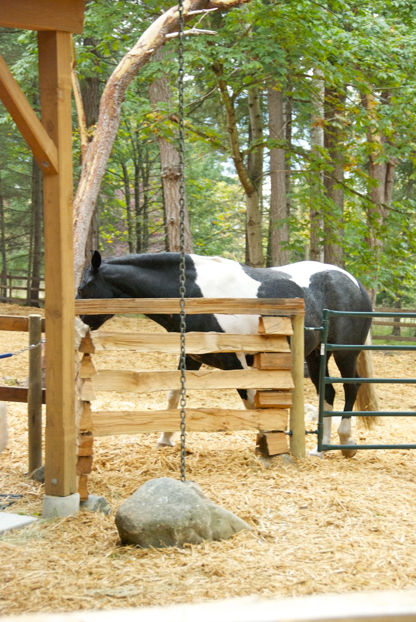

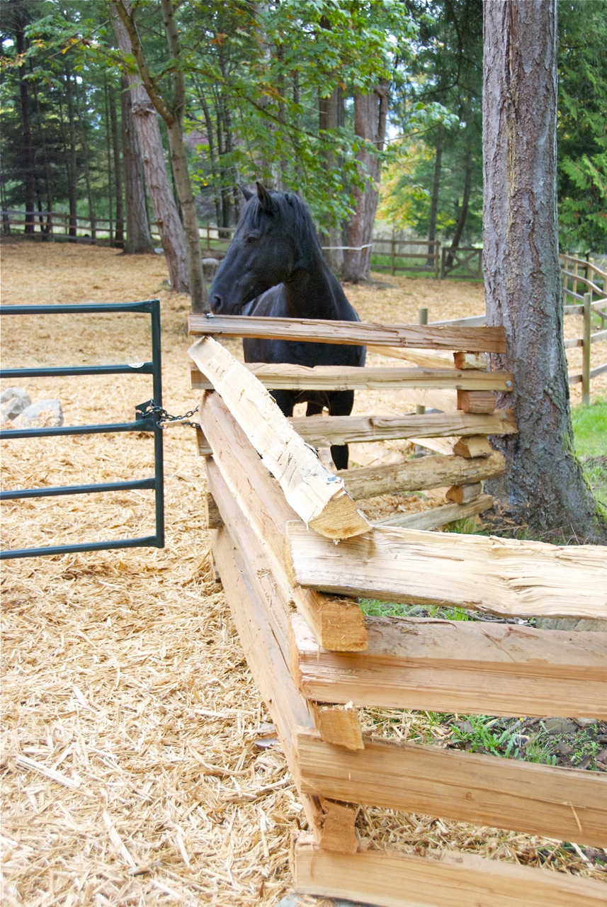

This past year we've been engaged in two projects - renovating a cottage on our property which was the original farmhouse built in 1928, and preparing the property for my wife's horses. To get the place horse, ready I had to finish the stables (the envelope of which I built in 2007 when I built the barn/office/workshop), clear woodland and level for a riding ring, paddock and corral and build the necessary fences. Here are some shots of the completed projects. I don't have much work in progress shots.

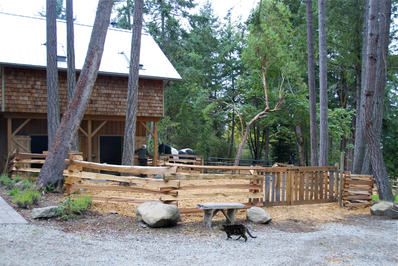

First shot shows the stables and corral in front. I used cedar snake fencing here because we're into rock and driving posts is hard, and also because the kitchen window looks onto this area so something that satisfied aesthetics as well as being functional was preferred.

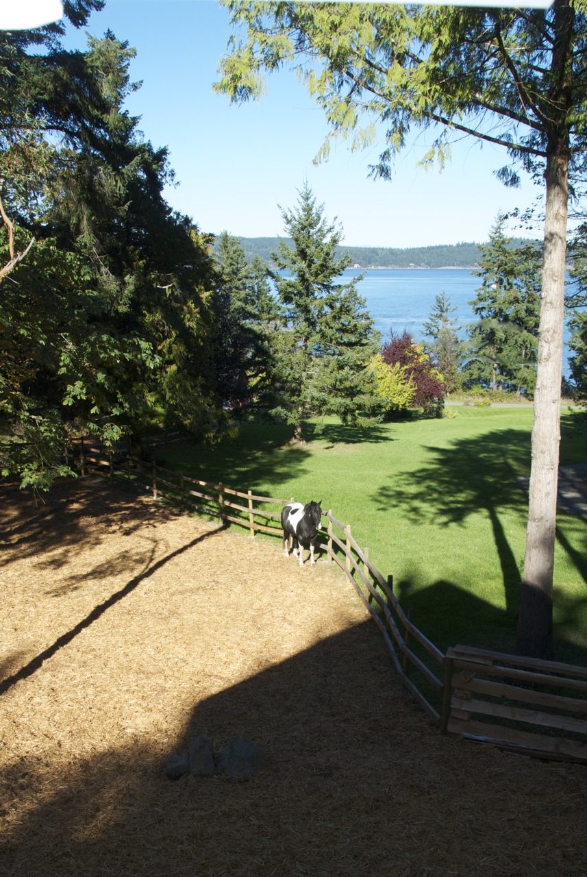

Second shot is Lucy looking into the corral from the paddock.
Third shot is Lucy in part of the paddock. We are on the water so Trincomali channel and Galliano island beyond are in the distance.
Last shot is the wife, the farrier and a family friend outside the stables.

These shots are of the trail up to the ring and a shot of the riding ring itself which is about 70' x 110'. We used material called spaghetti hog to top the road, the riding ring, the corral and the paddock. This is long, stringy wood shavings that knits together nicely and forms a soft carpet for the horses. It's a pig to spread and has to be teased out with a pitch fork but it lasts well and the horses love it.
The riding ring has about 6" of spaghetti hog over 4" of sand over 4" of rock base over geotextile. I had a tracked machine into clear the woodland for the ring but the tractor and I did the rest. There's one rock drain down the centre of the ring and a swale round two sides.
I also used geotextile on the trail but not in the corral or the paddock where it's not needed.

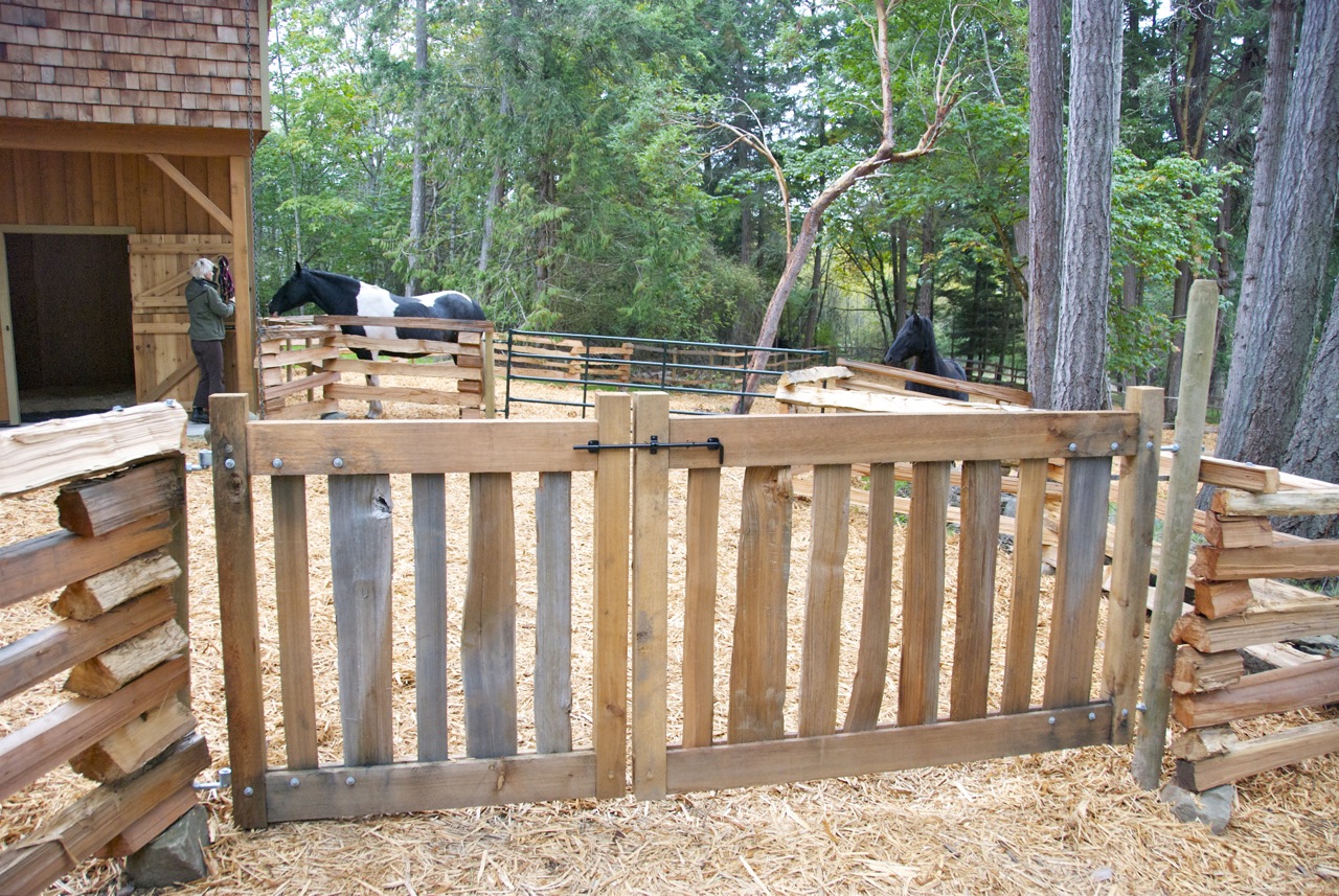

I made the corral gates from cedar off our property, all mortice, tenon and dowels - no screws or nails. The gate latch is temporary. I have to get something more robust made.
The other shots are of Ladybanks, a Canadian, and Lucy, a Belgian/paint.

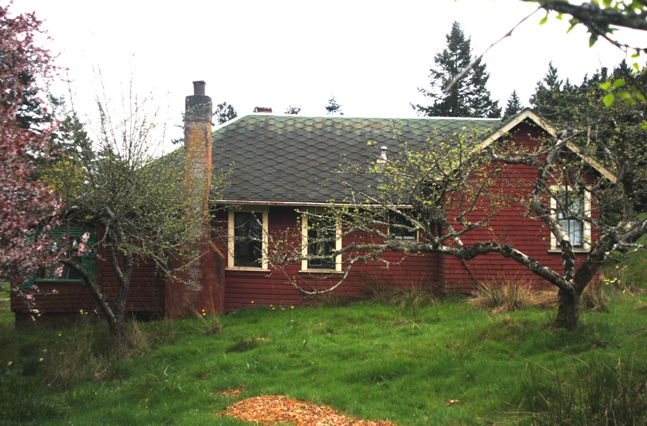

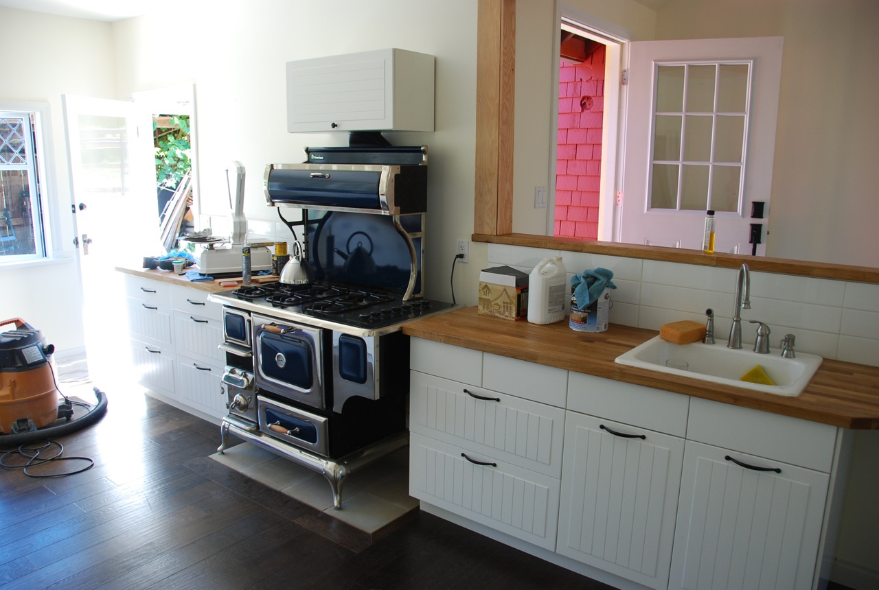

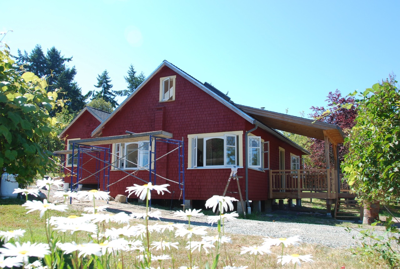

Here are some shots of the cottage before and after. It was semi derelict and we put new foundations under it, reroofed, shingled about half the walls in cedar before repainting, demolished and rebuilt the porch, rebuilt the leaded light windows and renewed the remainder and carried out a gut and stuff on the interior where just about everything had to be renewed.

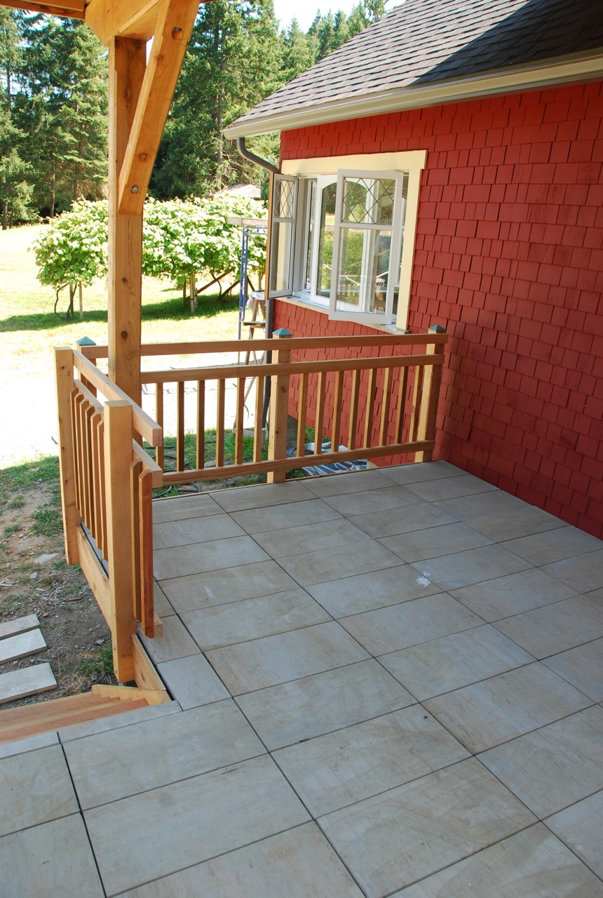

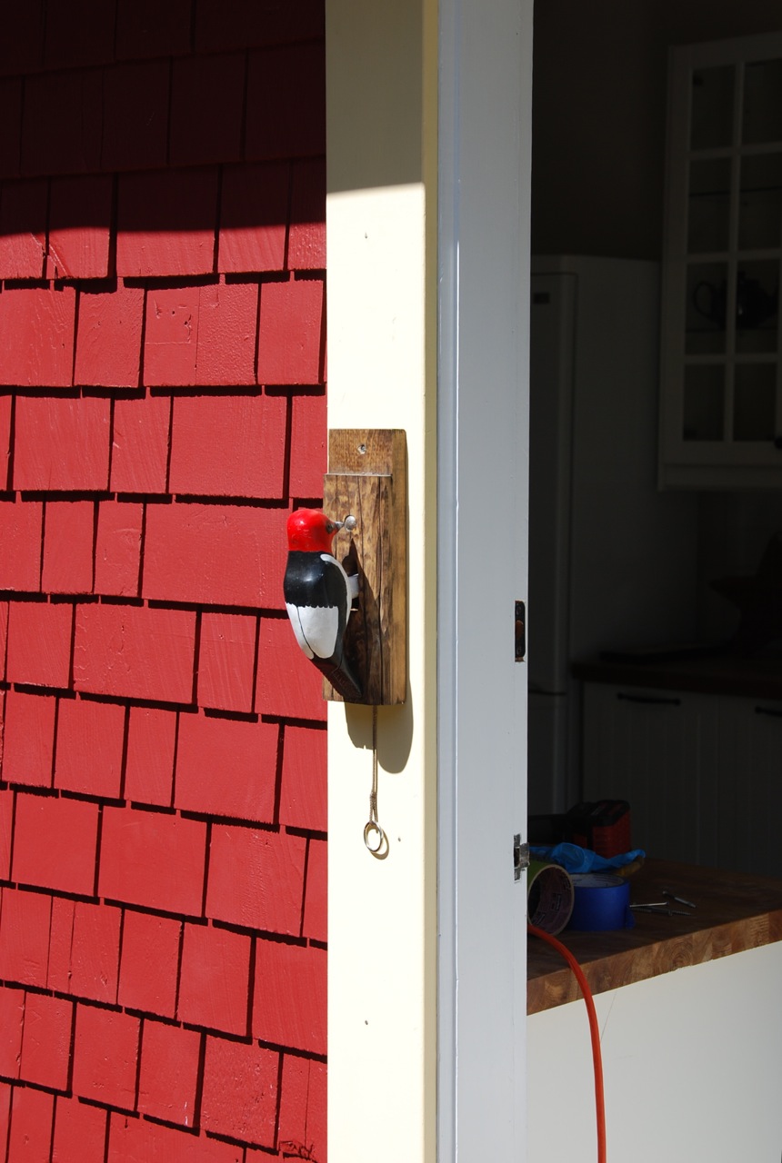

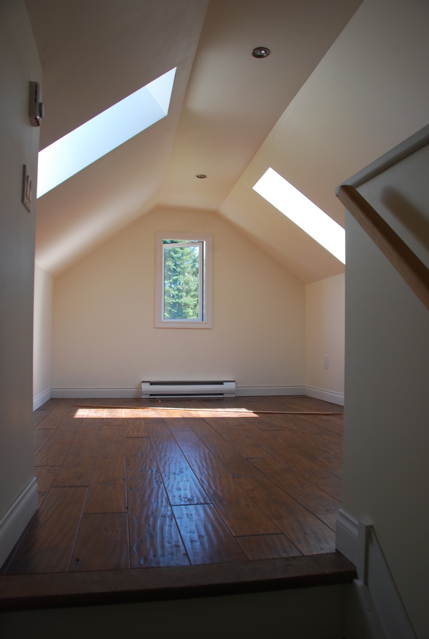

A few additional shots of the cottage.
The porch deck we finished in sandstone slabs, the doorknocker I was given by a friend, the stove I bought used and refurbished. The last shot shows the attic bedroom utilizing some flooring I had left over from building my office.

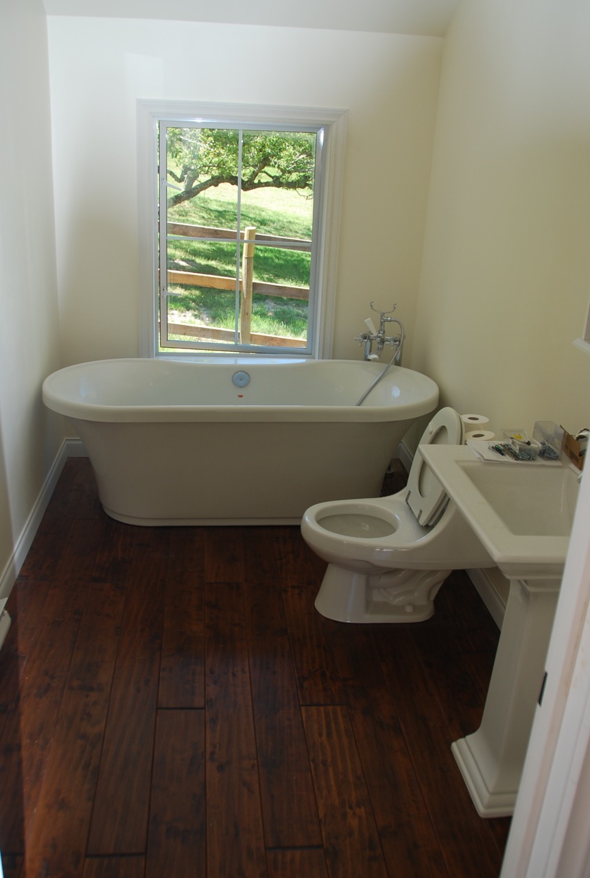

A last couple of cottage shots . . . .
Next projects are to put trails through our woodland and landscape around the cottage. Those will take care of any spare time I have over the next couple of seasons. In addition, I'had to vacate the stables (which I'd requisitioned for storage until the horses came). So I need to built some covered storage for the tractor implements.

/ PREPARING FOR HORSES #19
Beautiful place! I've been making snake rail fence out of oak. Pain to split. Wish I had cedar although I imagine the white oak will be around for a few years if kept off the ground. Do you tie the rails together somehow? I've found at a 45 degree or greater angle on the zigzags they are pretty stable. For the ends I drill them and run rebar down them.
#20
Supercobra, I also fixed the rails using rebar. First I set a rock around 6" min. height at each change in direction and drilled through with a 5/8" masonry drill. I then drove 1/2" rebar about 5' - 6' long through the hole in the rock and into the soil to the depth of the shale which is around 15". I then drilled each end of the cedar rails and slid the rail over the rebar. Finally, 12" lag bolts at each end connect the top three rails. Like you, I mostly stuck to angles of about 135 degrees or less.
Your oak snake fencing should last well, look great (post some pics) and be very strong.
