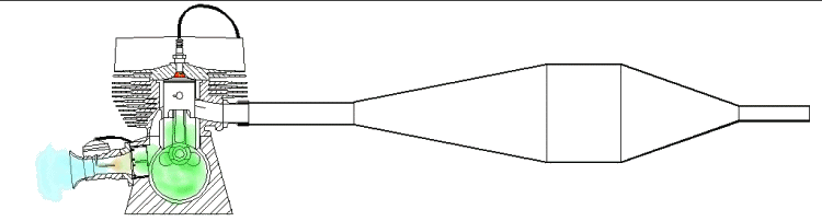

2 stroke engine compression ratios can't easily be measured. Most use a tuned muffler that will use the exhaust gas as a wave to act as a valve to close the cylinder's exhaust port. This prevents the new air fuel mixture from going straight out the exhaust, it also increase the volume of the cylinder. I'm not sure if this picture will work here, if not go to the link to see it as it'll show much better than I can explain how mufflers/ expansion chambers work on 2 strokes.
Expansion chamber - Wikipedia, the free encyclopedia
