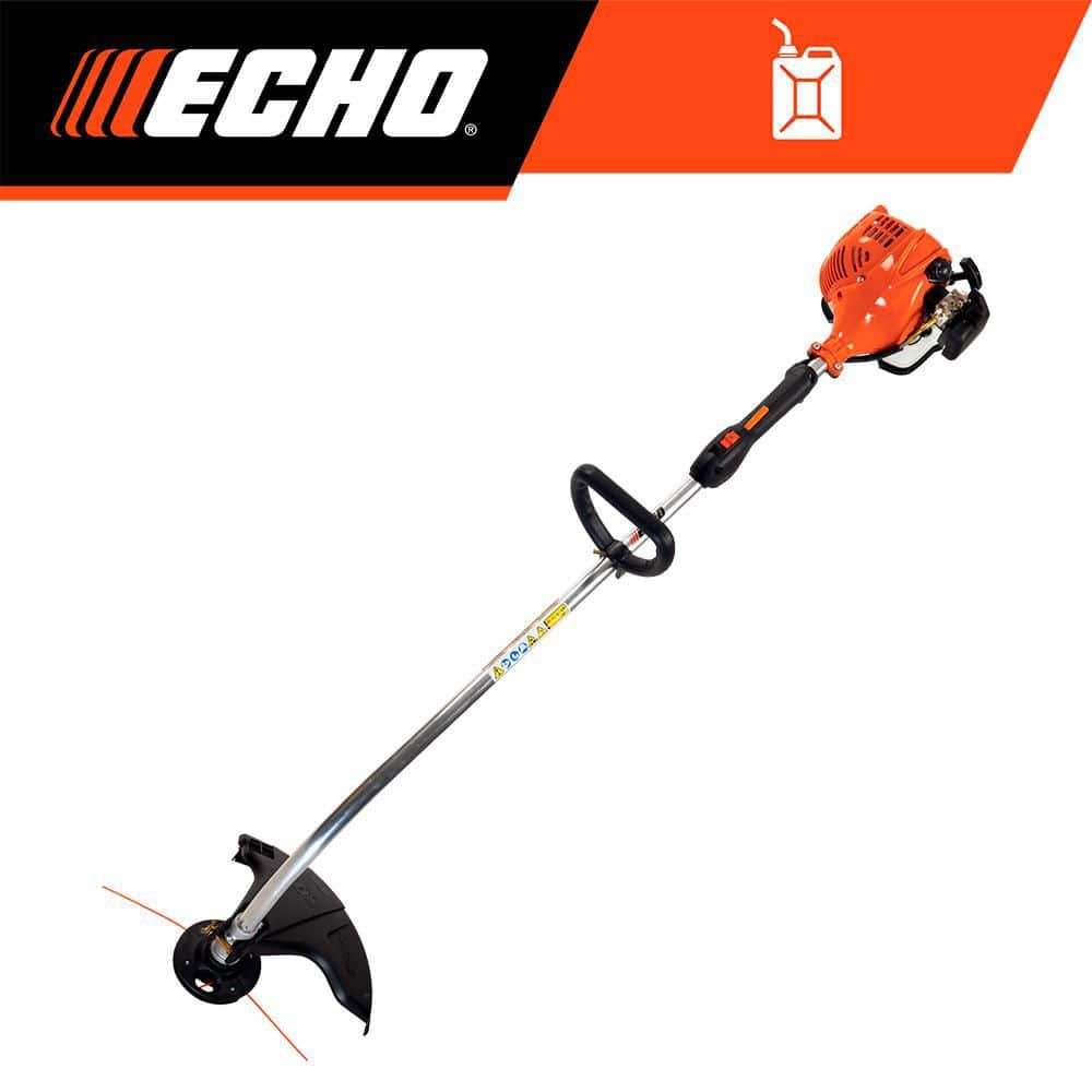

For $50 a year in pre-mix fuel costs VS $6 for pump gas, every three years you could by a new Echo string trimmer and throw the old one away.
That is true but I don't think the trimmer you listed would make it through one season for my sometimes heavy duty ab---use. I have a commercial duty trimmer that, like I said have used for 10 seasons and I paid over 2 times what your suggestion costs 10 years ago. Also, the curved shaft trimmer is not something I like.
