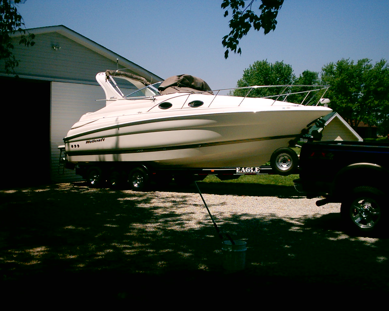

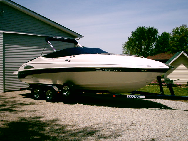

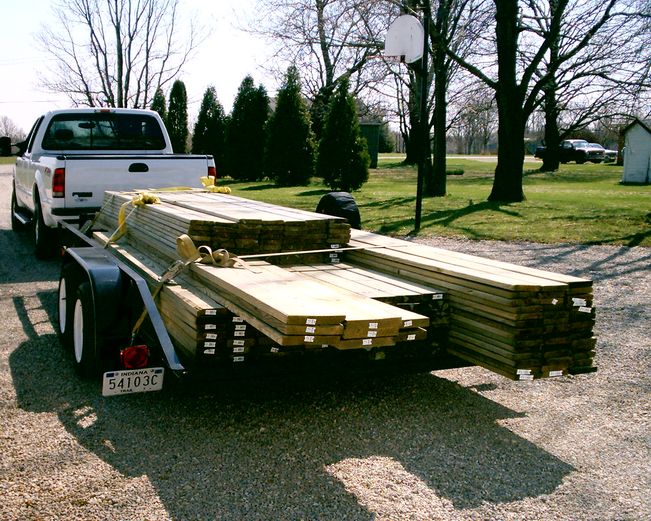

I like the right front corner. On both my boats and also my utility trialer they are right in front of the fender.
I made the one for my utility trailer out of a piece of 2x2 tubing 1/4" wall, 1/2" thick piece of maybe 8"x8" plate, and 2 studs and lug nuts.

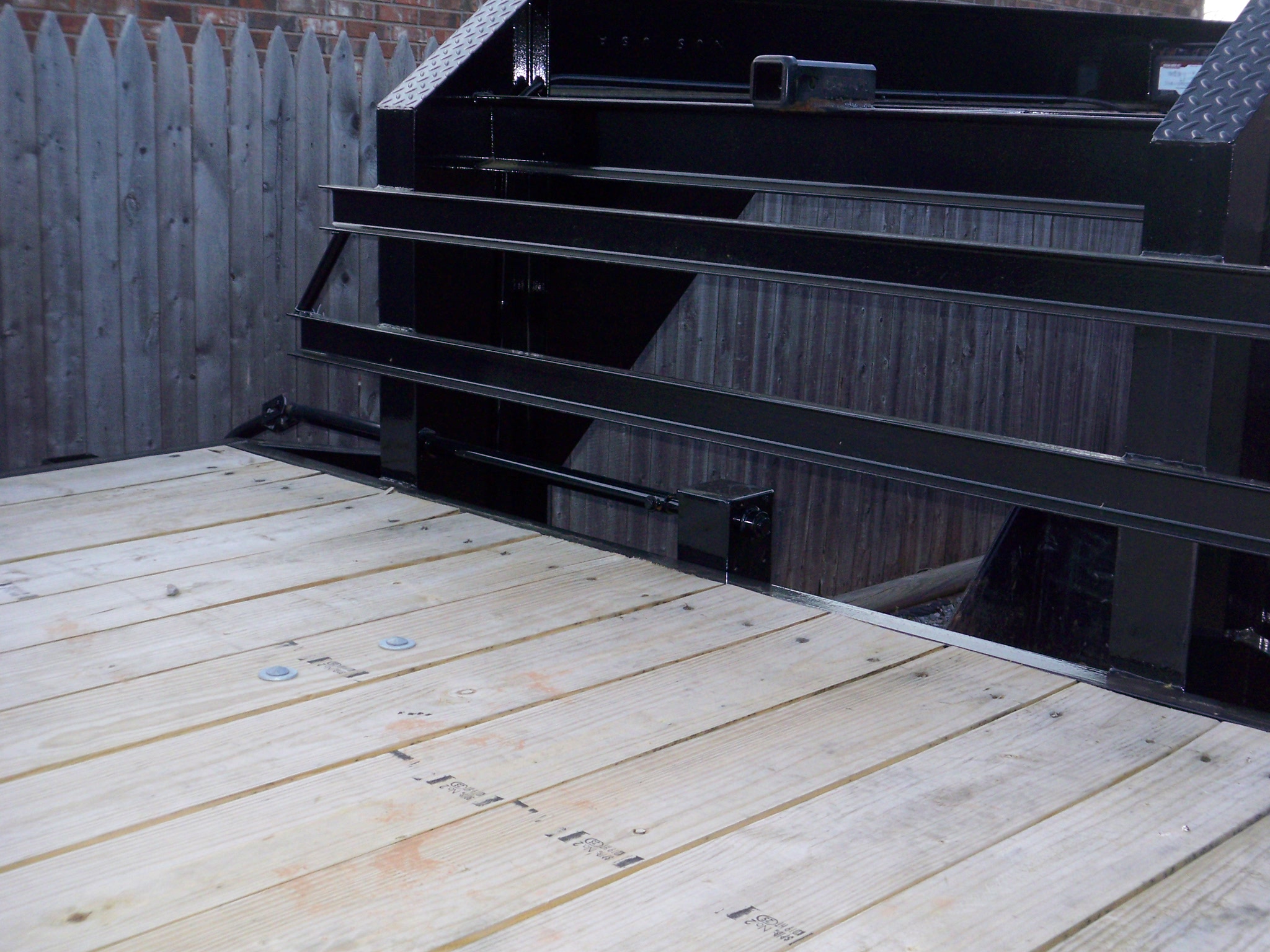

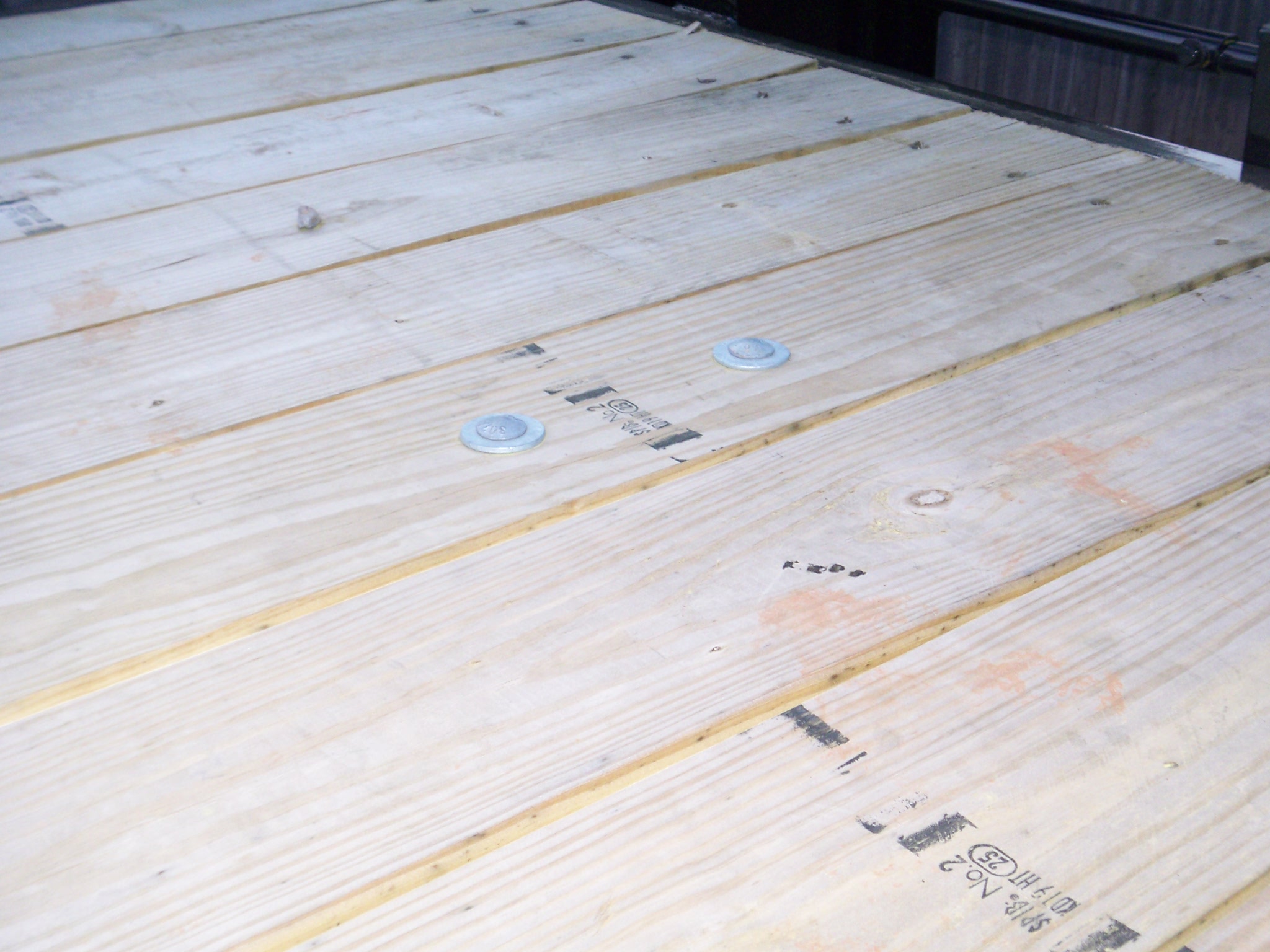

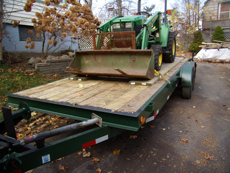

A few pics...

I mounted a spare to the rail on the side at the front on both sides.
On the jacking question I added fold down legs to the rear of my trailer that keep the rear from dropping more than a couple of inches. With those down I can jack the front up using the jack to lift all four tires off of the ground. I use a bulldog jack which mounts to a short piece of round tubing welded to the side of the trailer. I built an portable mount for the jack with an extra round tube mount welded to a piece of 2.5" square tubing with the top cut out. I can take the jack off the tongue and place it and this extra mount under the frame of the trailer anywhere to lift a specific wheel.
