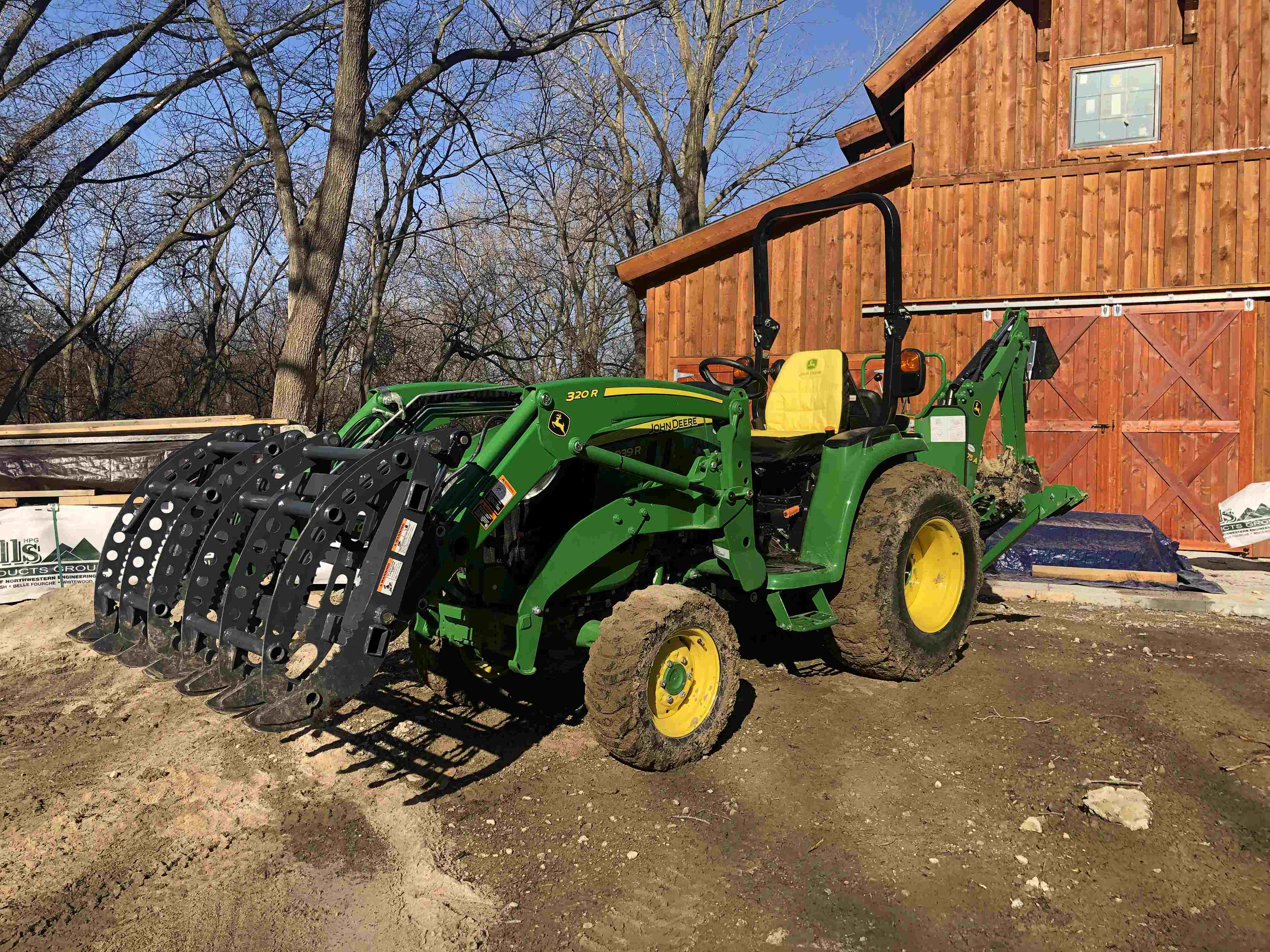

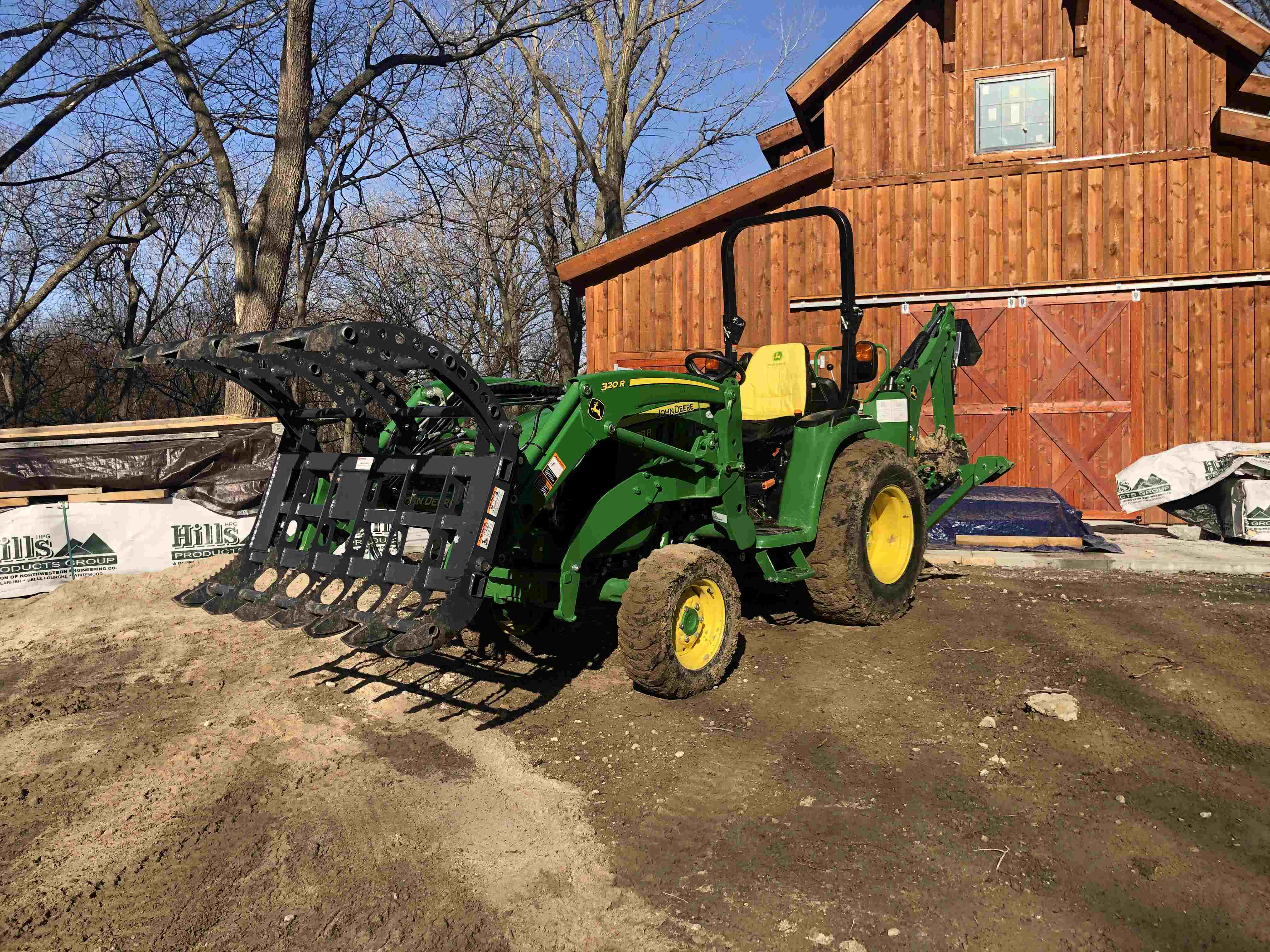

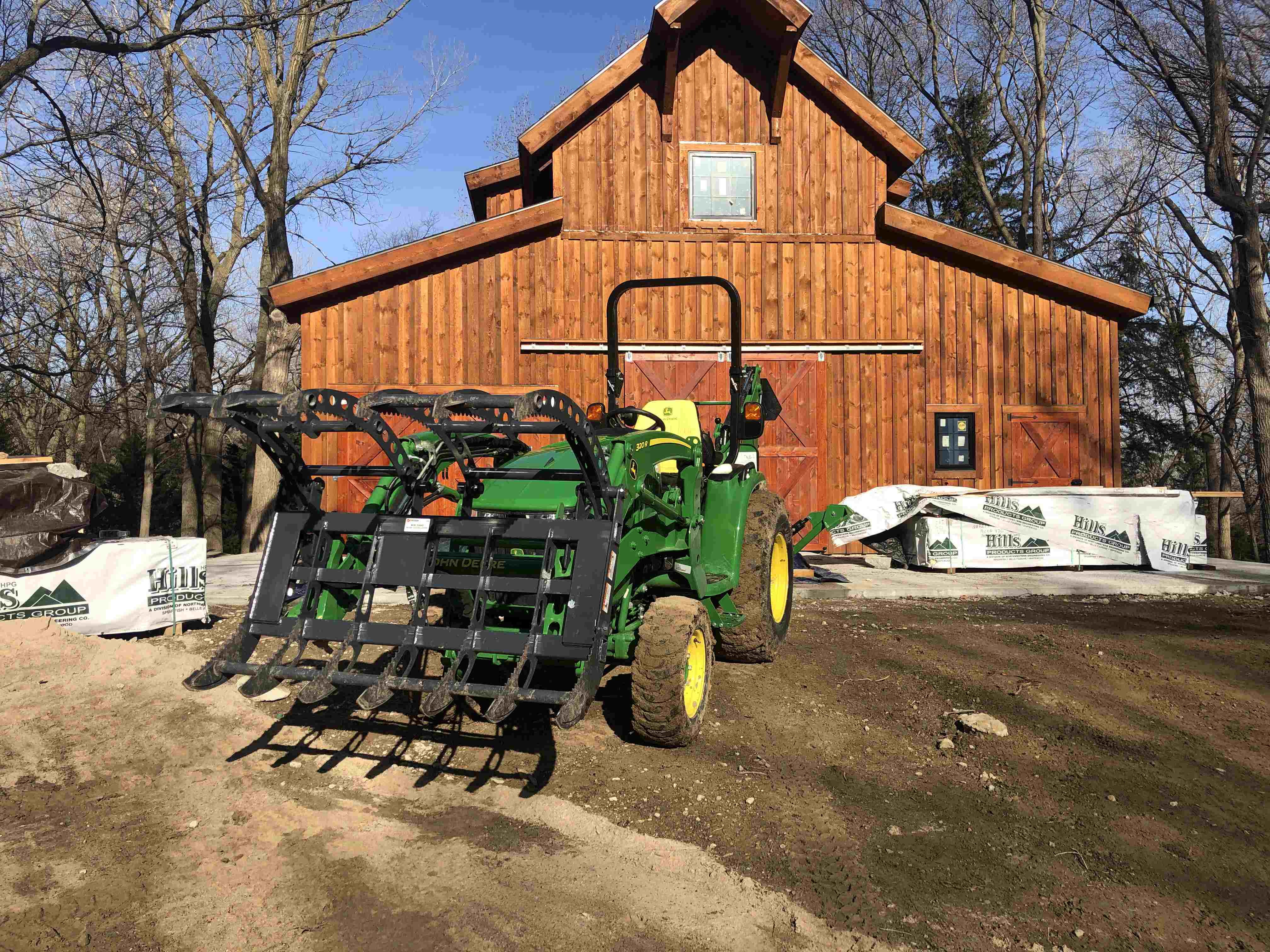

Folks, photos of Precision Mfg Mini322DBL Grapple on JD 3039R
