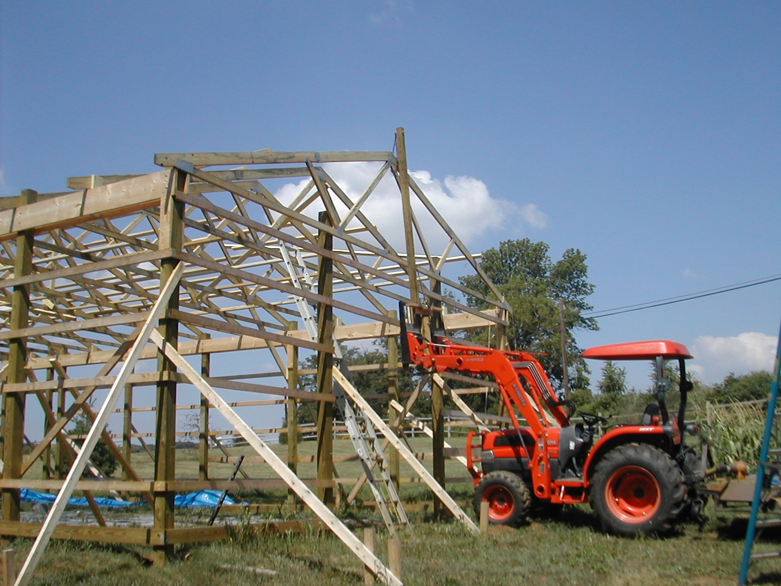

I put 30 ft trusses up with my tractor FEL.
