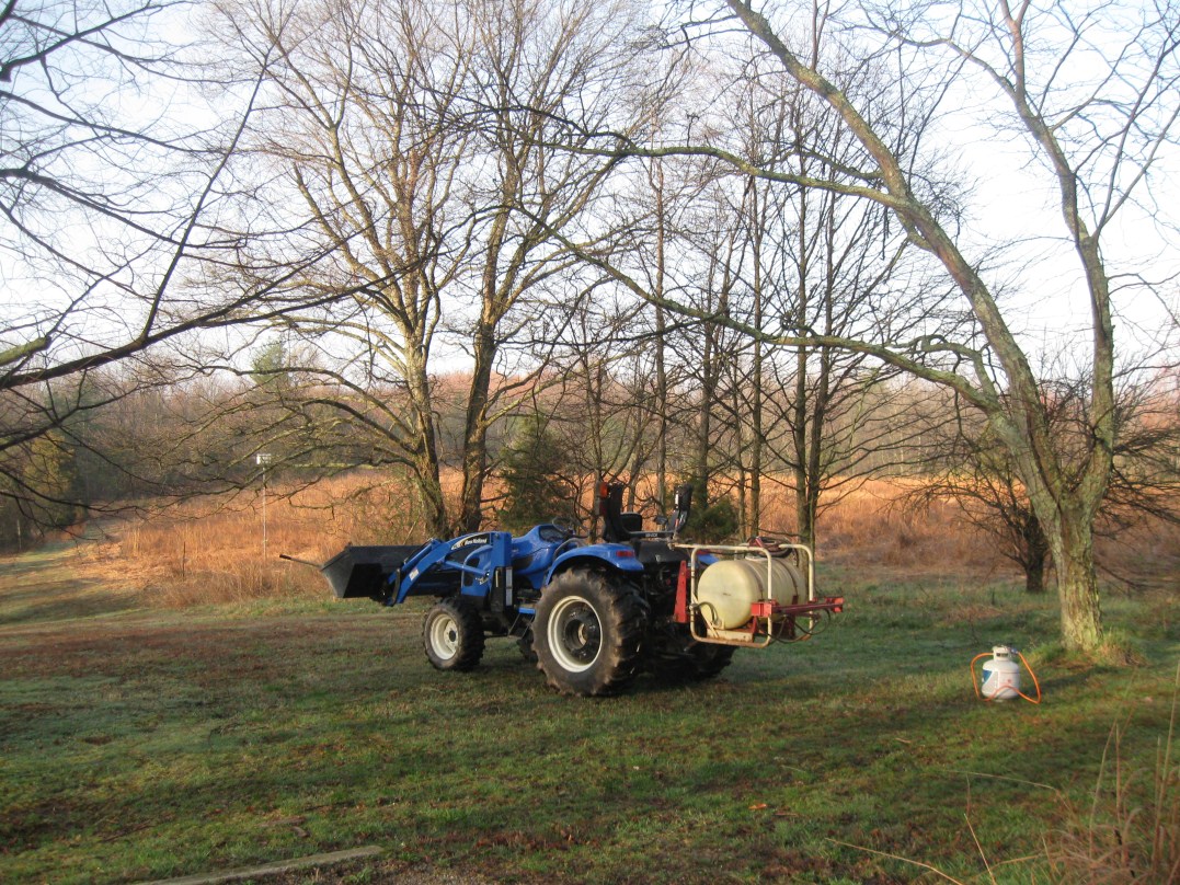

I planted prairie grass in an old hay field several years ago, but have never been able to do a spring burn. The field boarders the yard on one side and is surrounded by woods on the remaining sides. I would never attempt a burn without the aid of the fire department and over the years, time (I was only here on the weekends) and weather prevented us from having an opportunity to get together.
Last week, I called the fire department and they agreed to send a brush truck and crew out on Saturday, weather permitting. I would have my tractor with a 50 gallon sprayer (the tractor part of the project). They would instruct me in doing a controlled burn.

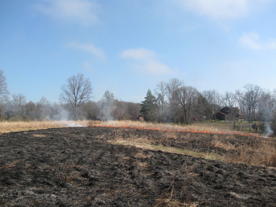

Saturday's weather was perfect. We have had several days of rain, but the day was sunny, with calm winds and high humidity. The crew of 3 arrived at 9 as promised, with a brush truck and a brush ATV.
I used a propane torch to start the fire as directed. With no wind and very wet ground, the fire burned slowly at first. The fire crew assured me that this was perfectly fine. The field is divided in two by a walking path and we started burning the second section. Winds of 5 to 8 MPH had been forecast and about half way through the burn, a breeze developed. The fire took off and looked more like the videos I had seen.
The crew was well prepared for this and used the truck and ATV water tanks to contain the fire along the breaks. The burn lasted about 2 hours and couldn't have been conducted in a safer or more professional manner. I plan to make a healthy donation to station.

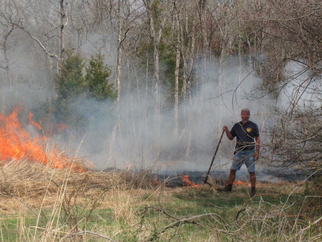

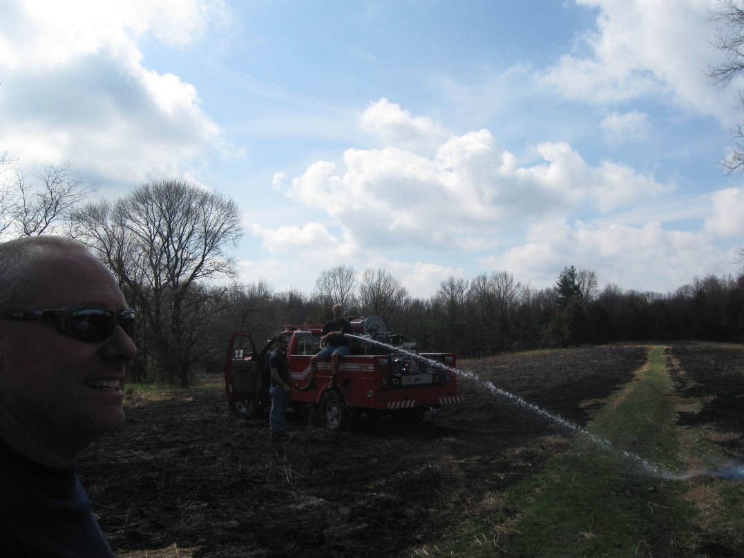

I didn't have time to take many pictures, but here are a few more. The ATV and truck in action and the burn coming to and end at the last corner.

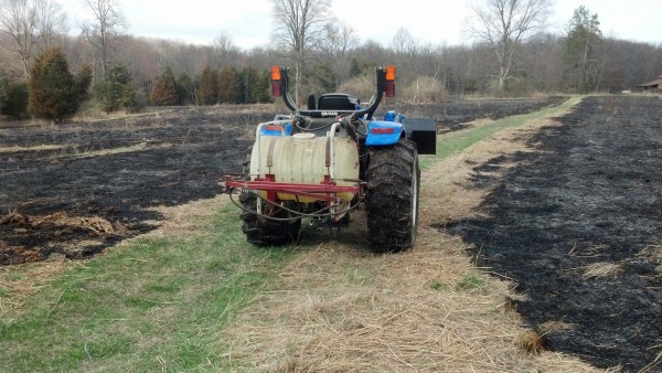

Final shots of the clean up. The tractor did come into play twice. The brush truck got stuck in a very wet spot and I pulled him out. This came at the very end of the burn. In the afternoon, I spotted one smoldering spot and used the sprayer hose to cool it.
