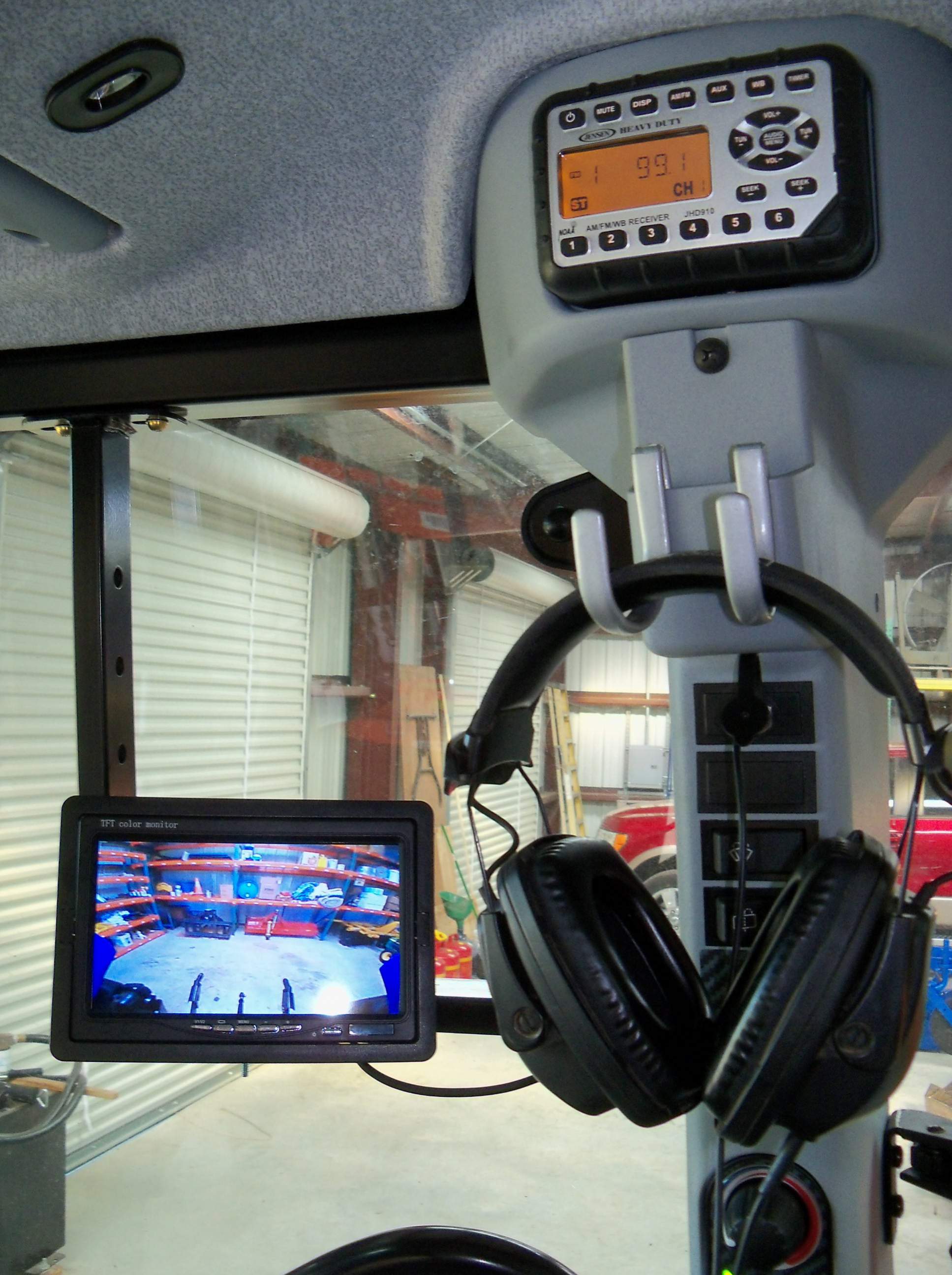

Utopia Texas where did you get your monitor bracket? Also does it bolt to the cab pillar as well? It was a year or so ago now I asked my dealer for one and they did not show one available. Thanks!
The "L" shaped bracket that goes from the top of the door to the door pillar is a New Holland part. Take a copy of my picture to your dealership and show it to the parts guy. He can take it from there. Go to your local bank first and float a small loan for the bracket! :) Yes, There are metal cap screws that hold the bracket to the door frame. The threaded female parts are already in the top of the door and the pillar but may be hidden by plastic upholstery caps.

eth555, I think the part you are looking for is 87614599. You can go to new holland's parts site and look it up by part number to be sure. If you want to see a graphic of it it is in the platform, cab,decal section, it's listed as "support, monitor" or something like that.
I understand your frustration about not finding what you want at a dealer. I've been trying for 2 months to find a 3rd function diverter valve kit part number unsuccessfully, I know they make them, utopia Texas has one on his. So if anyone can help me with that I'd sure appreciate it.
Wayne
Ps here's some more info.
15 SUPPORT ASSY, Incl 7 - 14 87614599 $190.89 3-7 business days

Wayne Clagg and Utopia Texas, Thanks for the information and part number. Wow almost $200 Utopia Texas is right I need to stop at the bank first. I may try to fabricate something for that amount of money.

About a month after I bought the bracket from my New Holland Dealer I happened to be on EBay and typed in "monitor bracket". At that time there were a lot of options there that were very inexpensive.
