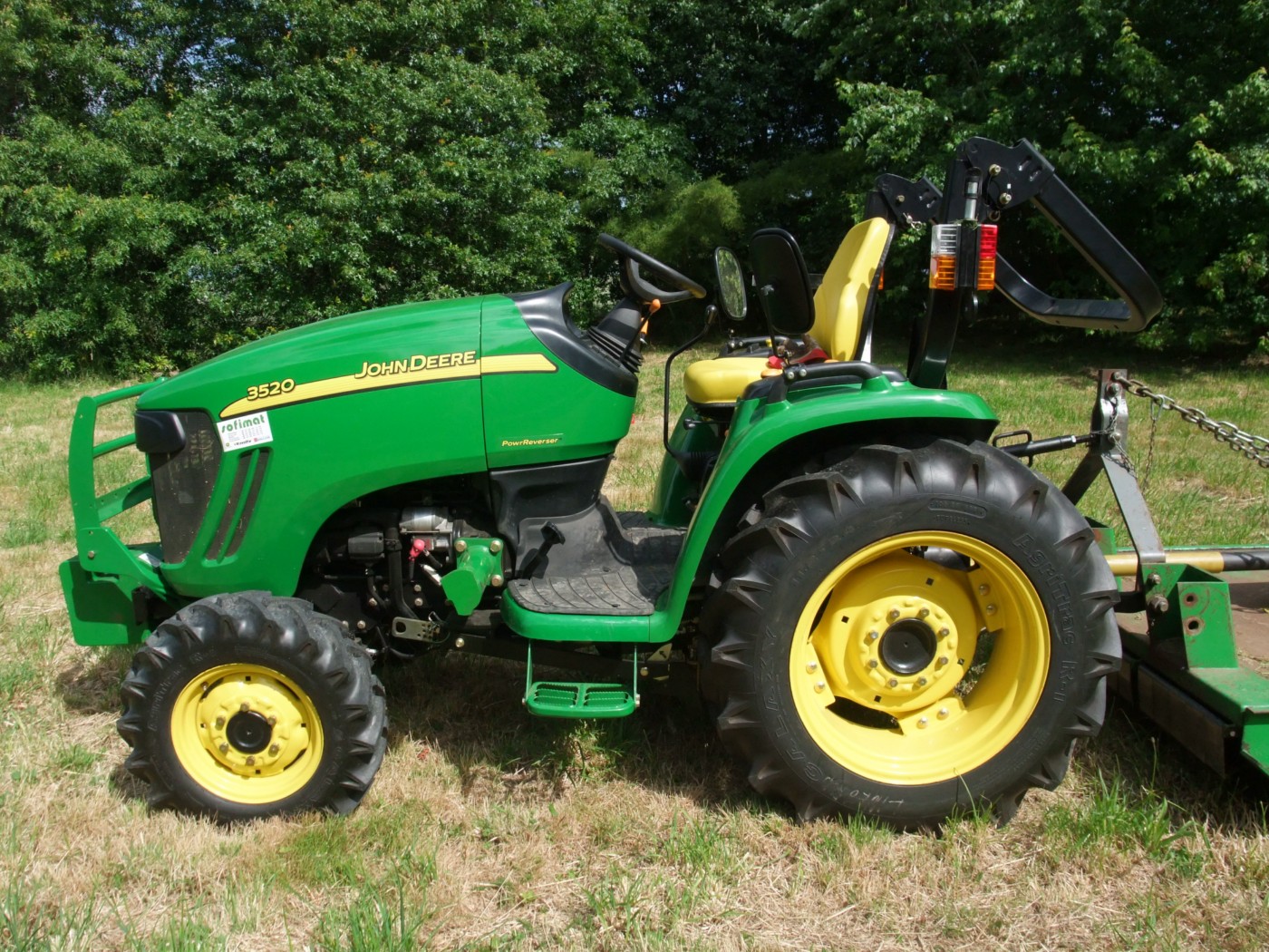

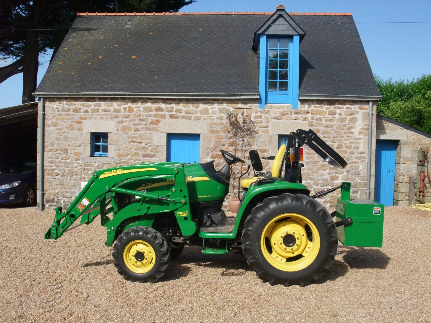

Is the Power-reverser transmission to be found on the JD 3520 or 4520 what you mean ? It allows you to drive forward or backward at the same speed at the flip of a small lever. I love it, especially for loader work.

No, totally different subject.
