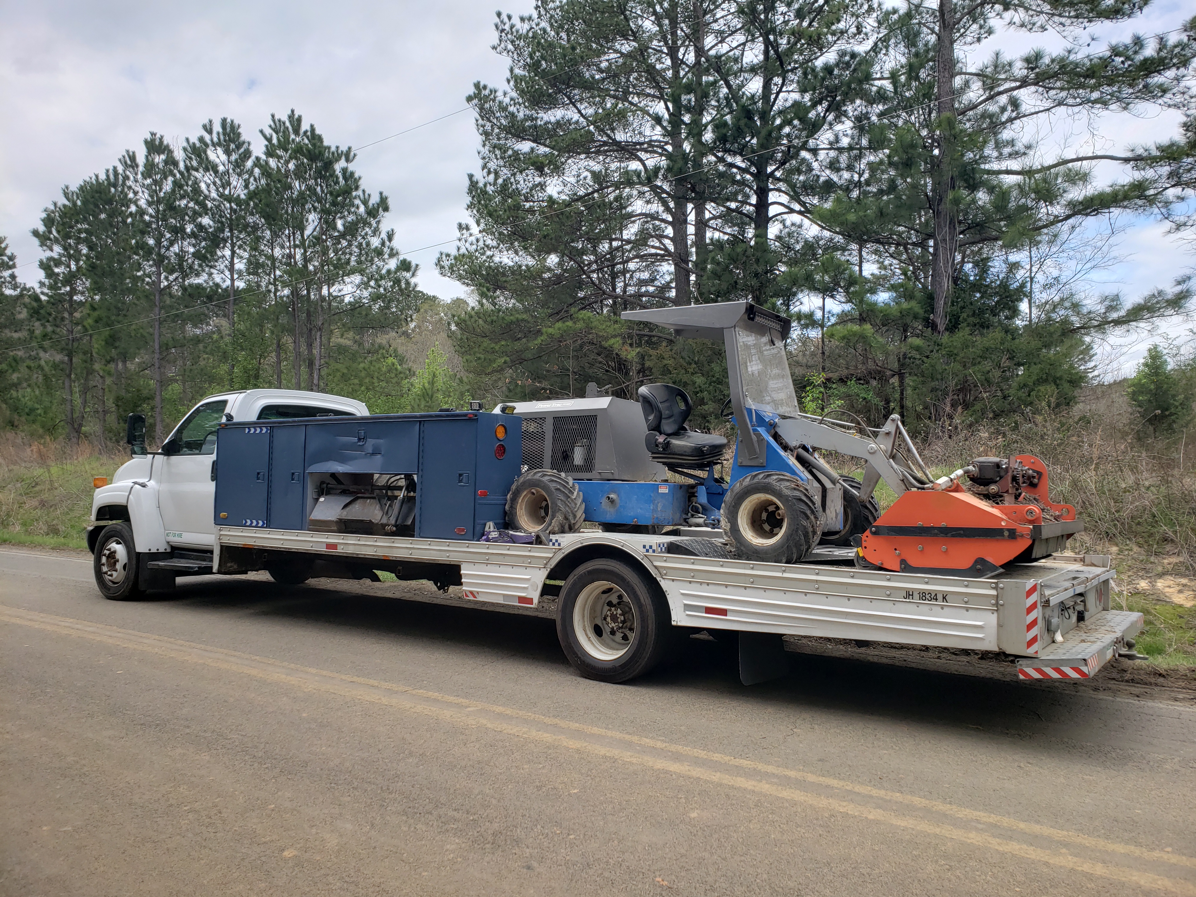

This retired uhaul truck got a bridge here in NC that w call the can opener. Now, box cut down, I have a 26'bed that'll haul two 425s or as in the pic a 425 and terex pt30....plus a few attachments. The blue on the far side is half an 11' utility bed used for tool storage. 20200507_181944.jpg

That's a crazy looking rig, but ultimately, very efficient. My pickup and trailer has a smaller bed length, lower weight capacity and is probably long in total length.
/ Power-trac truck #5
I wonder if someone borrows it someday and discovers that the missing roof and sidewalls provided part of the bed's strength.

No hint the sidewalls provided any of the deck's strength.
/ Power-trac truck #7
What do you use for loading ramps?

Re:ramps
A lot of aluminum.
Seriously, 10k# rated, 10' long by 15".
Expensive. Worth every penny.
One advantage of the uhaul platform is that it is 8" lower deck height than standard.
I can get on and off w the 6' ramps from my isuzu dovetail....but that's STEEP! And the bolts on the bottom of the 1850 don't clear at that angle. You can see the stowed 10'ramps and in use 6' in the pic.

Anything that leaves the OEM with just a chassis- no way the OEM is going to rely on whatever the upfitter does. I don't know if all trucks are originally sold that way though.

Understandable comment Deb. ;-)
Fortunately, the box is just weight and cover in the uhaul design.
Super efficient and even at its length it is pretty easy to maneuver bc uhaul spec'd better turning radius into rig for their fleet, which makes a lot of sense since they'll give the keys to anyone!
I'm rated and tagged to load the deck w two machines and a few attachments or a machine and a lot of attachments....plus a trailer w my little dozer on it when necessary.

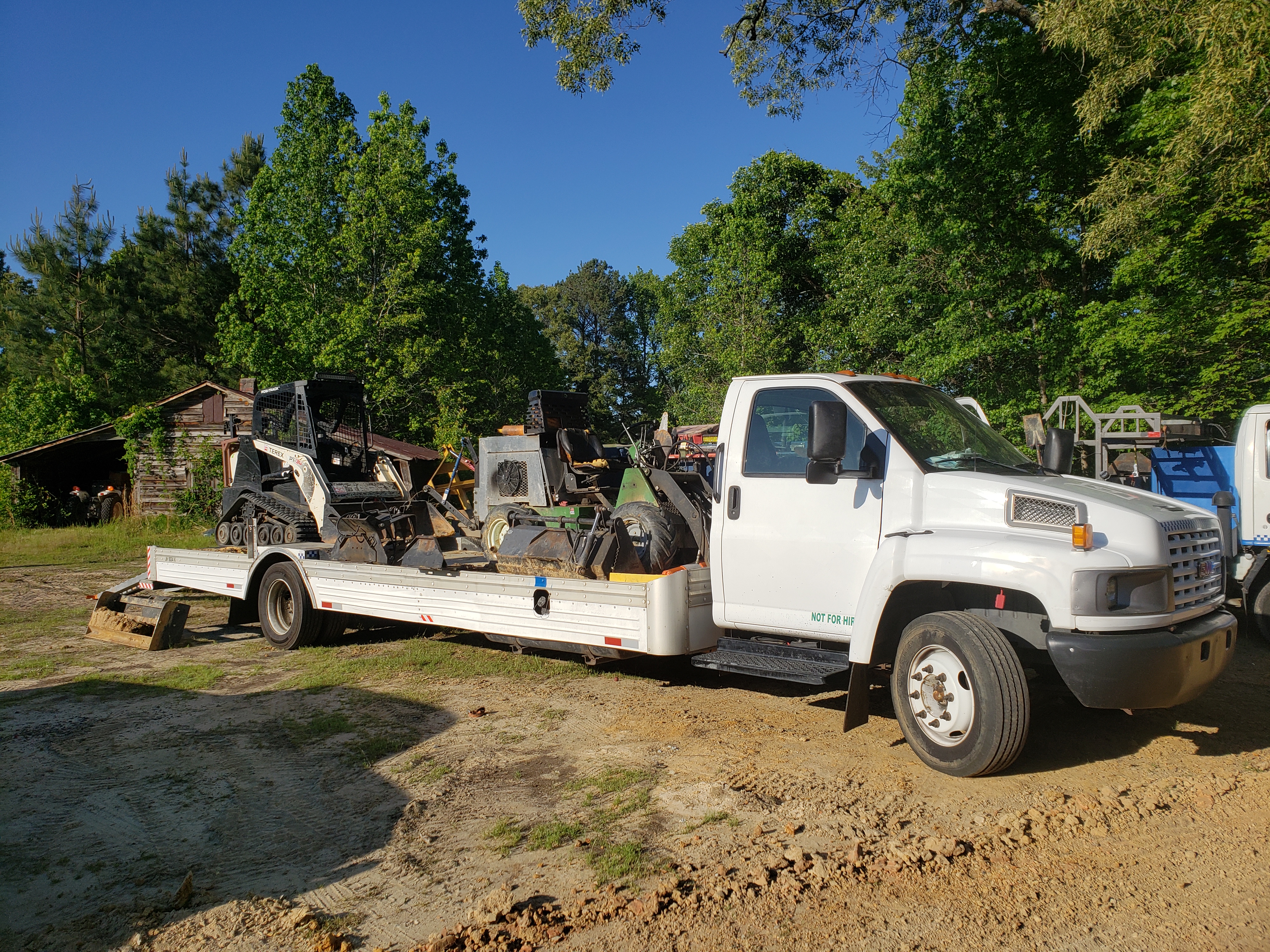

Here's another combination on the 'aircraft carrier'. The 1850 w 66" HD flail mower weighs in just under 5k,the terex pt30 w 2 attachments. Just over 4k.
