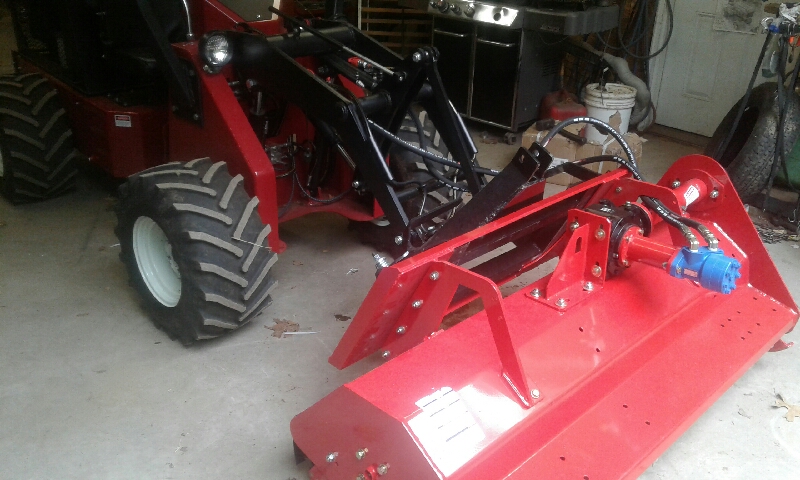

Just another thought I would like to mention. The PT's have a different balance then CUT or Steiner due to the rear engine. When a Steiner Ventrac lifts the mower, the weight of the engine, transaxle and the mower is all on the front axle, similarly with a CUT. Those configurations all NEED ballast on the rear (to work with anything substantial in the front), so the advertised weight is deceiving. The 1430 may weight more to start with, but it doesn't need any ballast. The higher weight is spread out more evenly over all 4 tires.
The quality of the grass cut is with the design of the mower. I bought a different brand of mower to use on my 1430 for example. If you really wanted to, you could find a well designed golf course quality deck and just drive it hydraulically.
