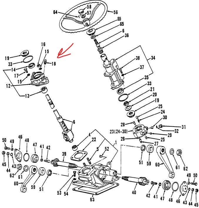

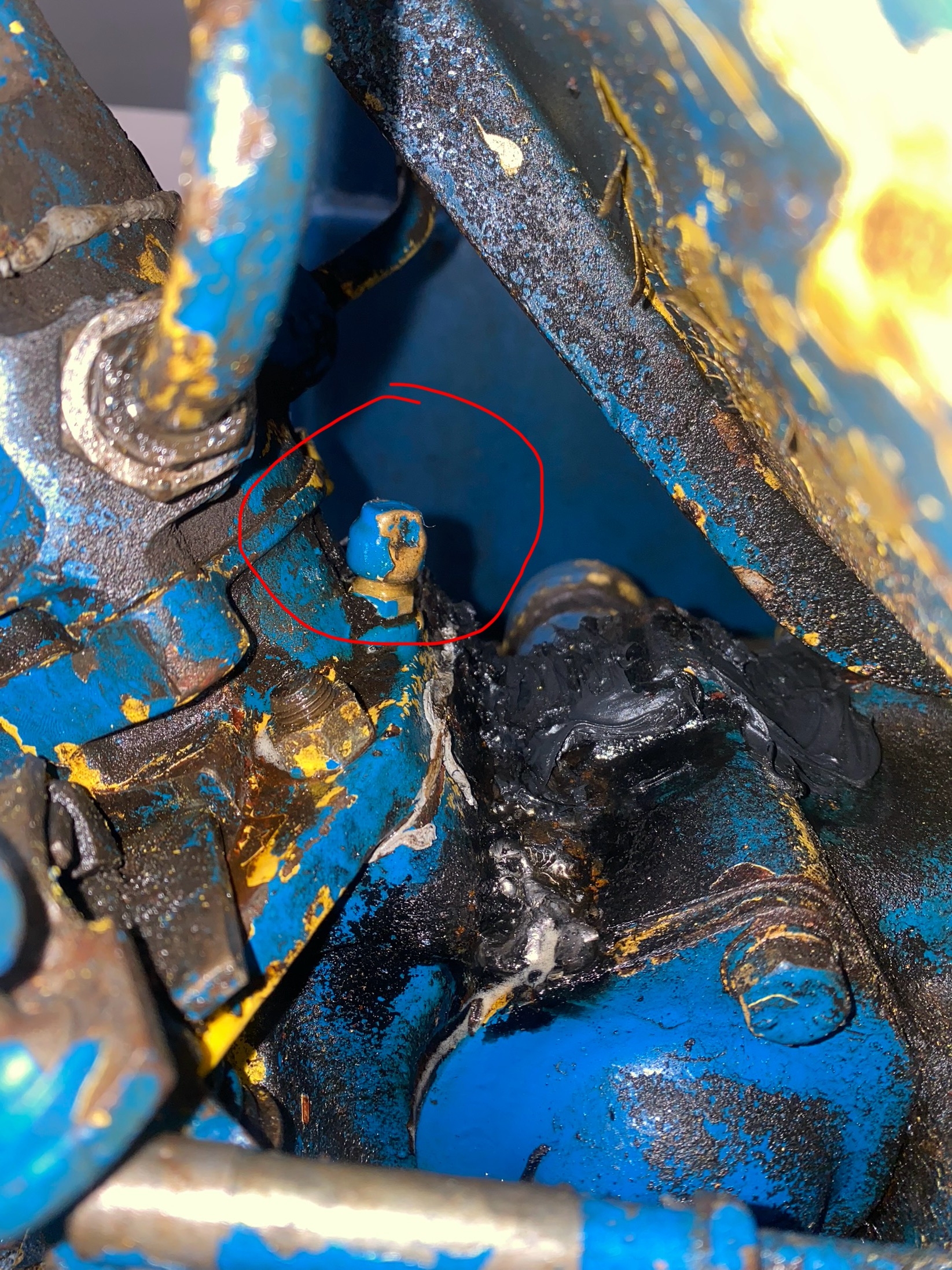

I replaced the power steering cylinders on each side of my Ford 3400 and finally started up my tractor to test it. Bubbly oil started pouring out of this pop it behind the steering column. Anyone know why or how to stop it?

It is part 18 on this diagram
/ Power steering leaking #4
To me, that looks like it's just a vent for the steering box, however, if it's leaking from there, I would say there must be an internal leak on the hydraulic components of the steering box and are over filling the box, them pouring out of the vent.
/ Power steering leaking #5
Is that a weld and sealant all over the area too? It appears some trauma has happened there. The poppit is dented too, which would likely affect its ability to seal
