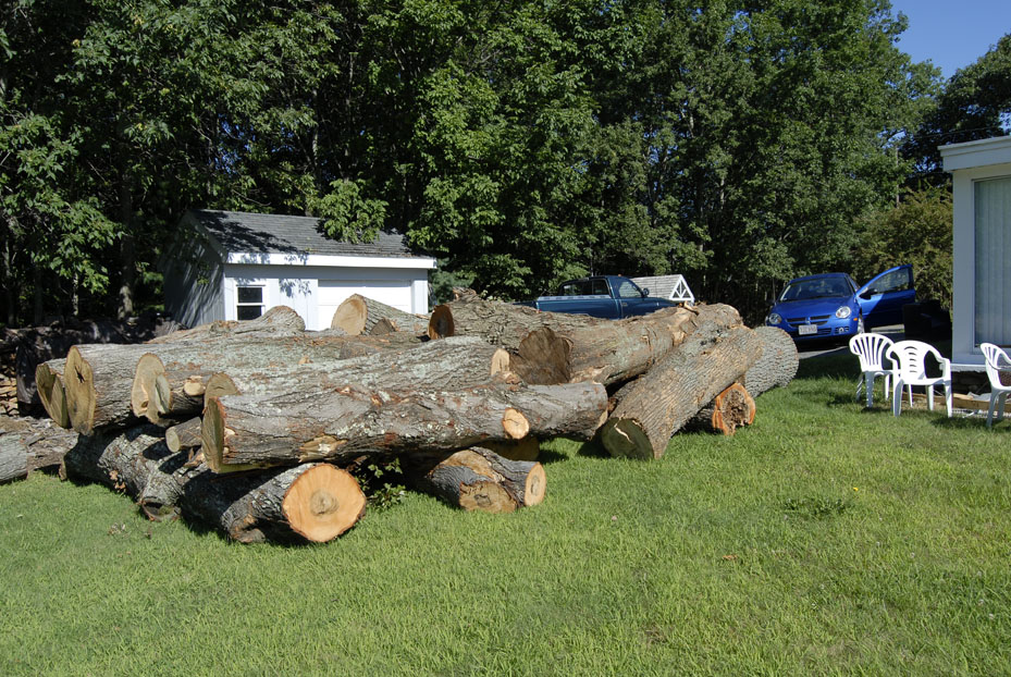

As for tractor work, I only have a 1 acre property, but we just bought it 2 years ago, so I've actually had quite a bit of opportunity to use it. It may be small, but if worked within its capability, a lot can be done with it (as you know). We put up a pole bar, which required excavating back into a slight hill, so we put up a retaining wall, so I had a bit of ground leveling, and backfill to do. We put of 350' of split rail fence, so I got a 3pt post hole digger for that. I didn't do as much snow removal as hoped for (total of less than a foot this year, normal is usually 3-4' with at least one of two > 10" snows). I didn't even put the snow blower on it, just used the back blade, as the deepest one was 4". Now, I'm working on next years firewood, so it has been a big help with firewood.
I was able to make a relatively neat pile with the help of the FEL (the logs range from 8 - 18" in dia, and the pile is 6' high -- I wouldn't through them up there by hand). Next step, is I'll be making wood cribs out of pallets like the ones that I saw on another thread on here. I'm getting a pin-on pallet fork setup that replaces the bucket so that I can load the wood right from the splitter onto the cribs, and then drive 'em around back to where they're going to be left to season. Then, after they season, I can drive them to where the covered storage is, and then ultimately load one crib at a time, as needed onto the back deck, near the door. This will save a lot of re-handling of individual pieces. The wood cribs are only going to be 4' X 2' X 3 1/2' high, to keep the weight within the 680lb capability of the Woods DuAl 145 loader that I have.

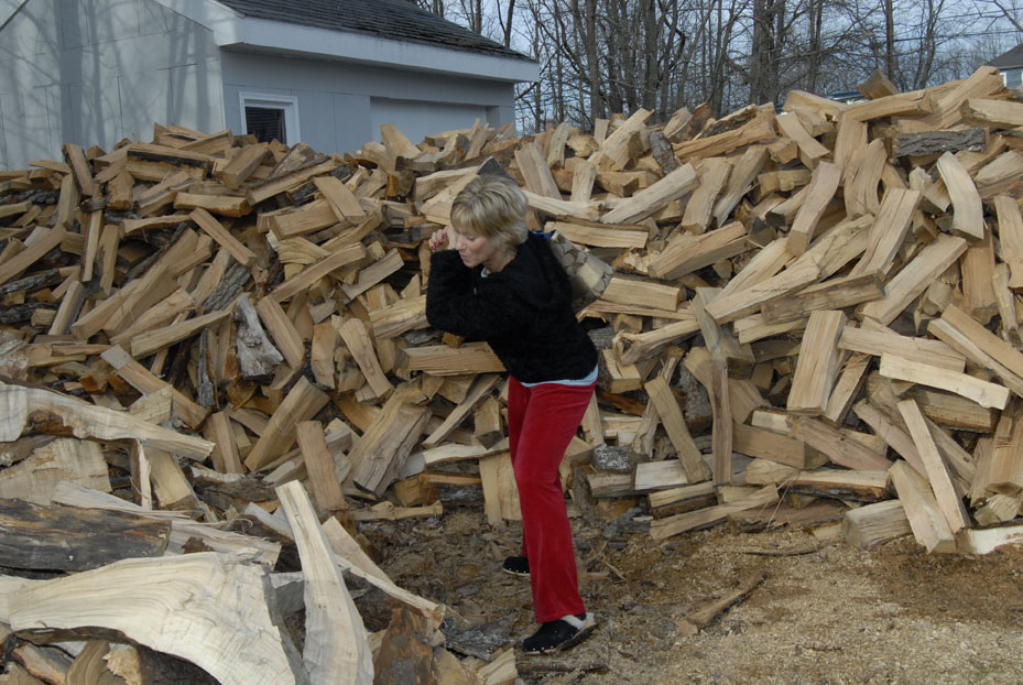

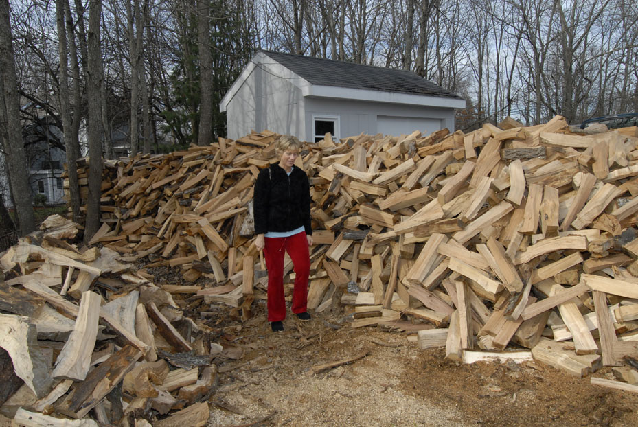

How much did you pay for the wood? I'll post my 2006 load below, I'm looking now, one guy said $650 and I heard the other guy was $800. There was a cheaper guy but he's not called me back many times now but did sell me the load in the photo for $450, it had lots of nails in it but I didn't mind for the price.
On the joke, yeah...the on Charles used to tell all the time was, "I'd be your father but a german shepard beat me up the stairs" Radio was fun, I got to meet the Beach Boys, Elvis Costello, Martha Davis, Glenn Tilbrook, and more. All very nice folks. (except Mike Love was a d**k)
I use the tractor for EVERYTHING! My motto is, "NEVER GET OFF THE TRACTOR" If you ever worked where they have a fork truck you'll know what I mean...it's like you get glued to the seat. ie; you have a 3 pound rock near the job. You spend 5 mins trying to scoop it up in the bucked when you can kick it to the moon with one boot... Did you see my Frankenblower posts? YouTube - Revenge of Frankenblower!

The load you see in my pix was $450, delivered. The cut pile isn'tall of it, I had about 3/4 of a cord split and stacked out back when that was taken.
Yes, I definitely try to use the tractor for everything, including some things that might take less time to do manually.
